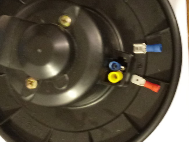

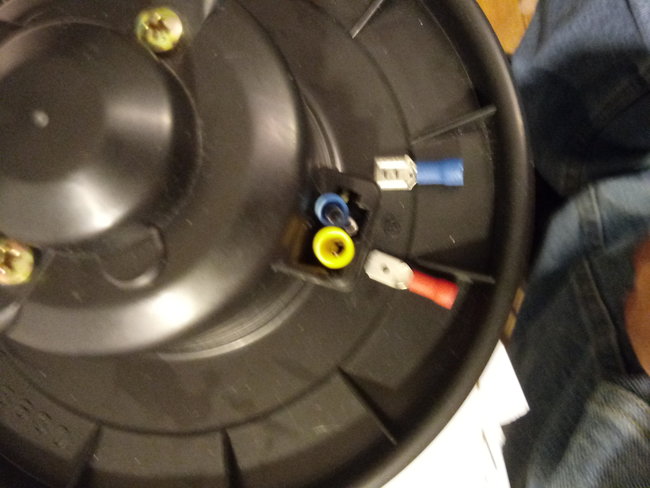

Okay, rule the story of buying correct plugs out! I found connectors that actually fit two of the blowers. If I test the wire and see if it has power, I will cut the plug off and put these two connectors which do work, because I tested them out of the car to the blowers. So now I have to just test that wire. Confused about how to go about testing the wire. Car on or off again! Which device to use? I have a power Probe for continuity. We are getting there. Thank you Roy again.
Tuesday, January 15th, 2019 AT 9:04 AM
TREEGA6059
  • 46 POSTS
Here is an image. These connected right onto the blower. I would like to cut that pigtail and put this on it! I still would like to check that wire. So many ways? Car off? Thanks Roy

Sure, give it a try and see if it works.
