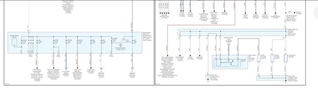

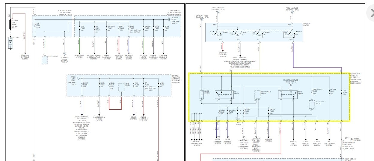

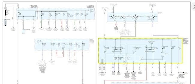

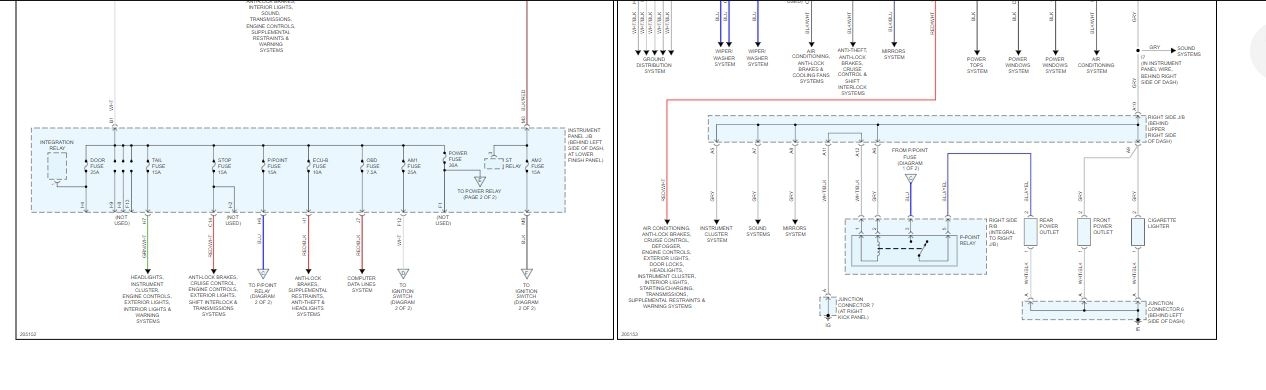

I know it is those plugs now, but I am thinking of new plugs if that is the next scenario. Pig plugs connectors. I am wondering if there is a diagram for that. I think we are very close since touching those wires seem to be the case and the old blower worked? I have a power probe that helped power the blowers. I might use it to see which plug is weak? Would you detect that with the car off? Thanks a lot. I feel a lot better now. Close, so close.
Sunday, January 13th, 2019 AT 4:05 PM
  • 52,797 POSTS
I attached the diagram for the fuse block with pin numbers and connectors.
The connectors are called pigtails. They should come with the wires and they should have the colors to match.
Sunday, January 13th, 2019 AT 4:27 PM
