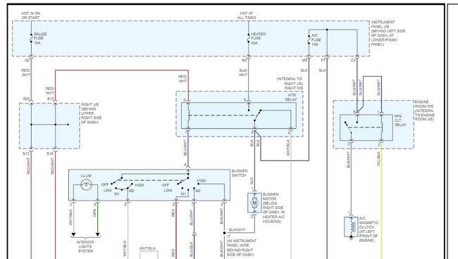

I attached a wire diagram for you. check the fuses and make sure there is voltage on both sides of the fuses with the key on.
Dec 25, 2018 at 4:35 AM

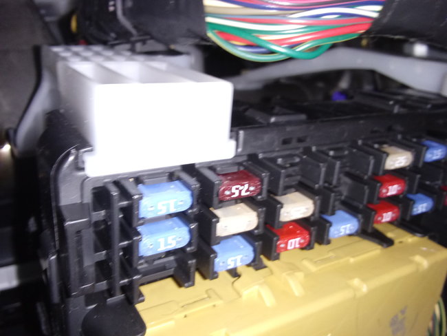

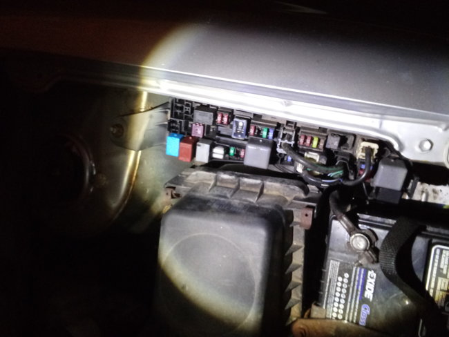

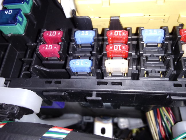

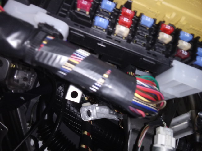

Used a test light on A/C and heater fuses with the car off and on. Not a single sign of life.
Dec 26, 2018 at 12:52 AM
Which fuses and where? can you take a picture and upload it to this post?
Dec 26, 2018 at 12:53 AM
TREEGA6059
  • 46 POSTS
Under the steering wheel. I will try to get it to you. Thanks Roy. There is a 10 amp A/C and 40 amps for heating. One for the air conditioning system and HTR 40 A air conditioning system. Those are the ones I changed.
Dec 26, 2018 at 1:18 AM
Okay, get me the photo so I can see what you see.
Dec 26, 2018 at 1:21 AM
TREEGA6059
  • 46 POSTS
First three under the steering wheel. Last shot is under the hood fuse box. Not much of a camera man but tried. I will try again if you want but I had to do aerobatics along with juggling the camera with the light. The third picture is where I changed the fuses. 40 and 10 amps. Thank you again!
Dec 26, 2018 at 2:58 AM
good.
did you check for power on both sides of the fuse with the key on?
Dec 26, 2018 at 4:52 AM
TREEGA6059
  • 46 POSTS
With the motor running? or just turn the key and see lights go on. If I do it again should I use the testing light?
Dec 26, 2018 at 4:59 AM
key on, engine off.
yes, use the test light.
Dec 26, 2018 at 5:12 AM
TREEGA6059
  • 46 POSTS
No power with either of those fuses.
Dec 26, 2018 at 5:25 AM
It looks like you have an issue with the fuse box itself as that is what provides power to the 40 amp fuse.
try wiggling around the connectors and see if you can get power to the fuse.
Dec 26, 2018 at 5:33 AM

Just watched a video on YouTube on the diagrams. The one you posted I have a question on? Heater fuse with the arrow going to M2 AND THE A/C fuse going to M5. Could that also be under my hood fuse box? I tested a bunch of fuses and they were dead? I wonder if that is giving me the problem? Just hit me to ask? Thank you again!
Dec 27, 2018 at 6:35 AM
We already determined that. that's why you are testing for power while wiggling the wires.
Dec 27, 2018 at 10:41 AM
