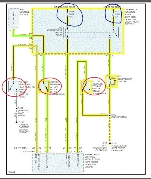

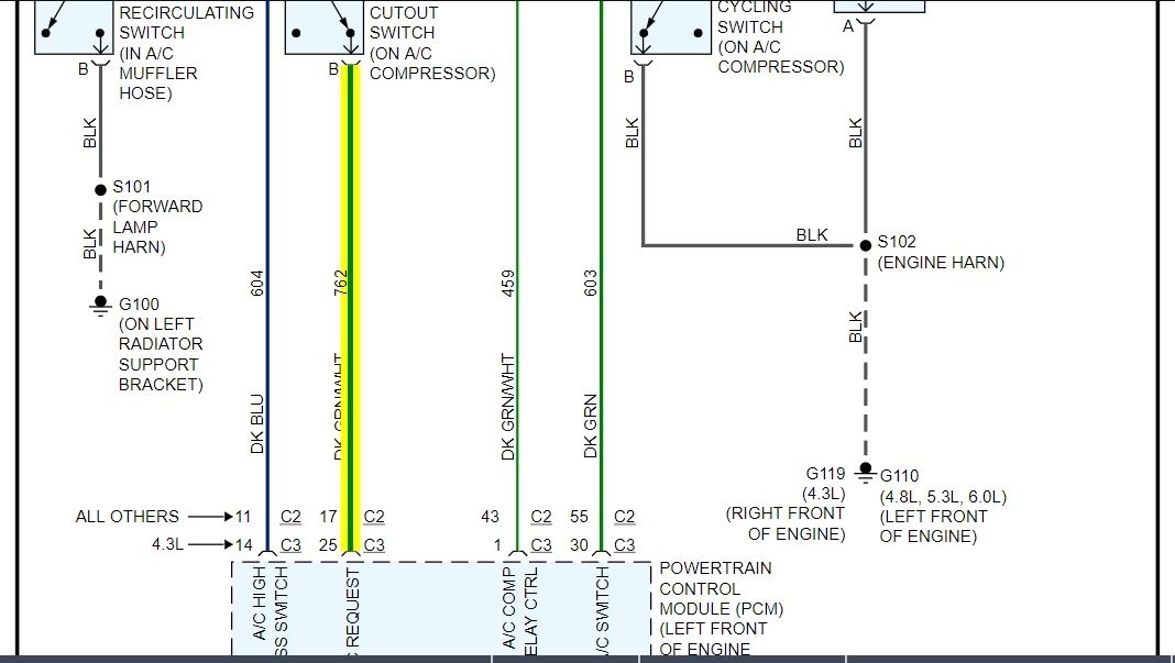

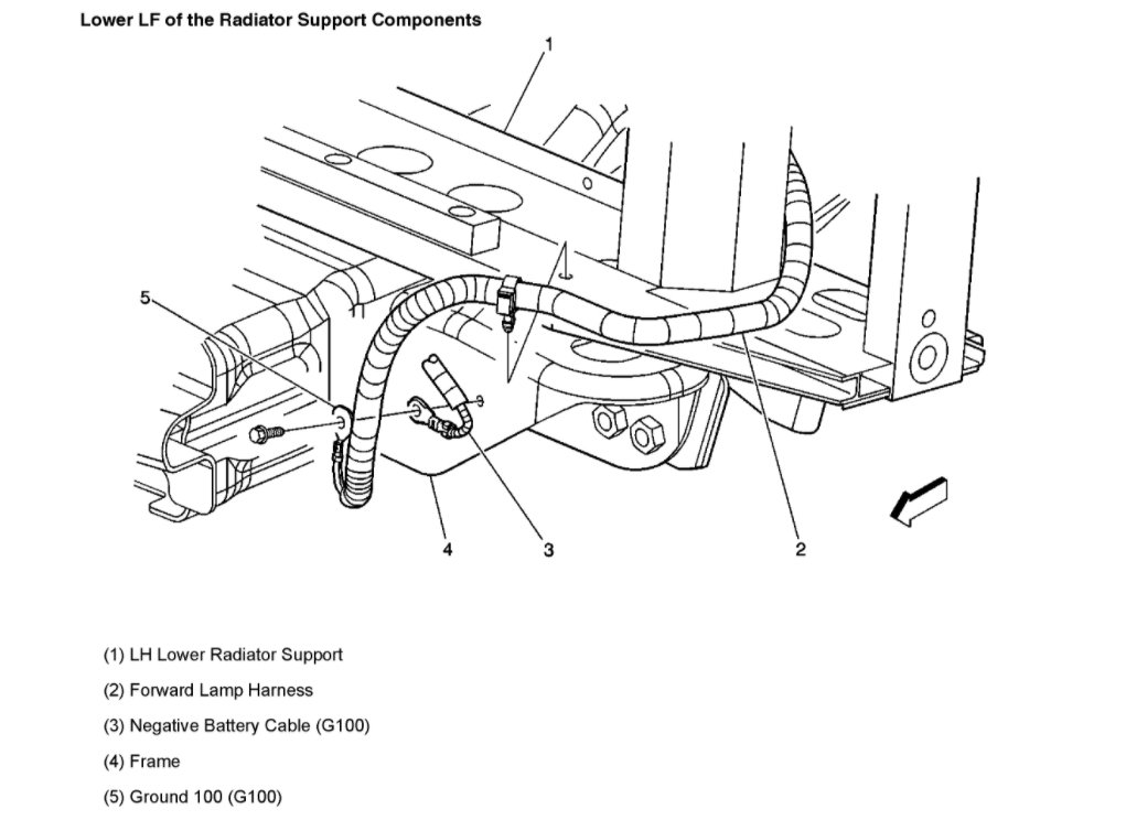

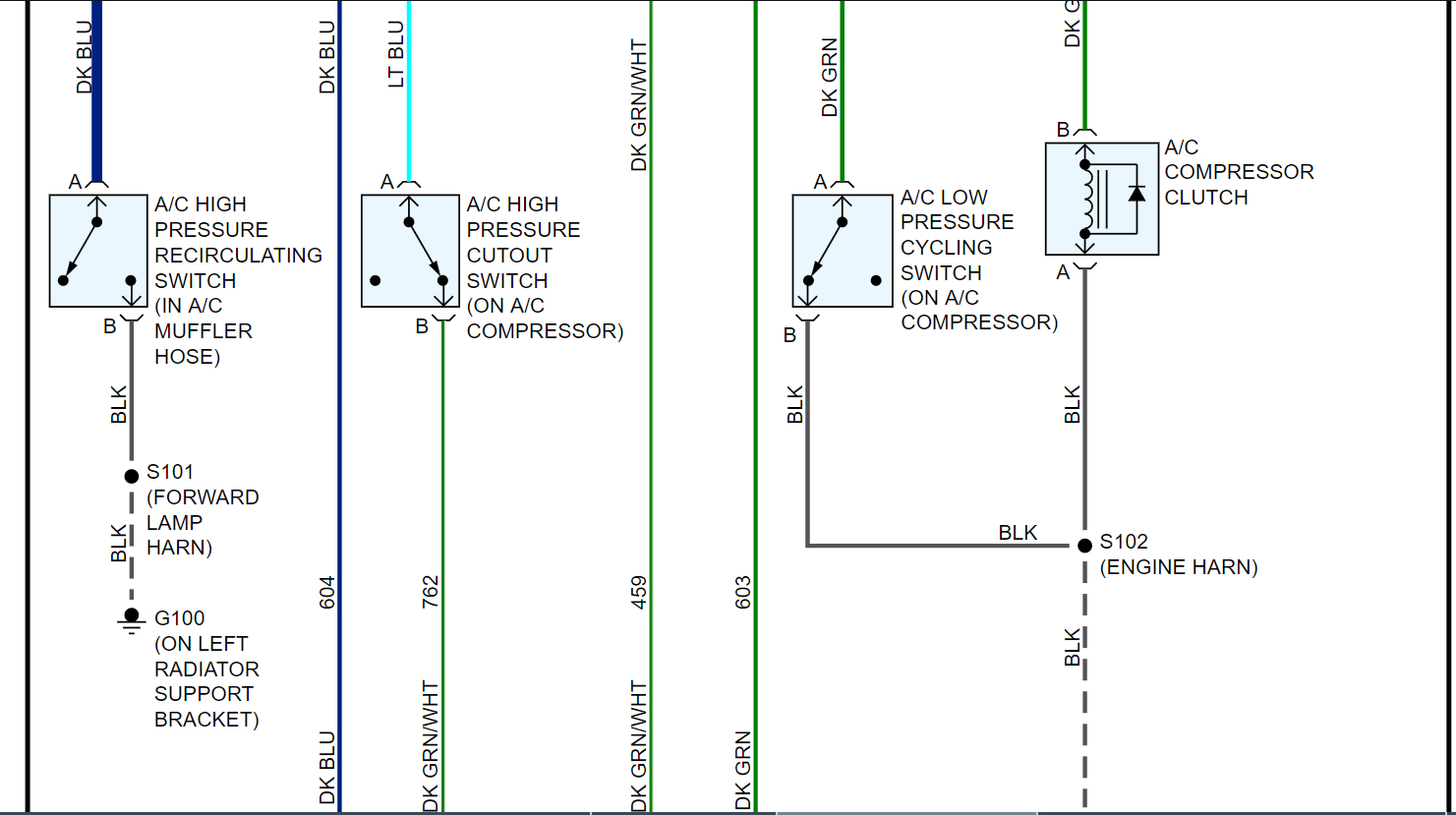

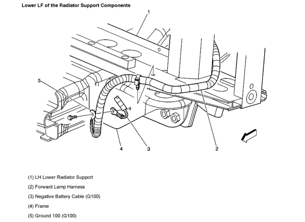

The ground for the control side is on the diagram. It is pin 43.

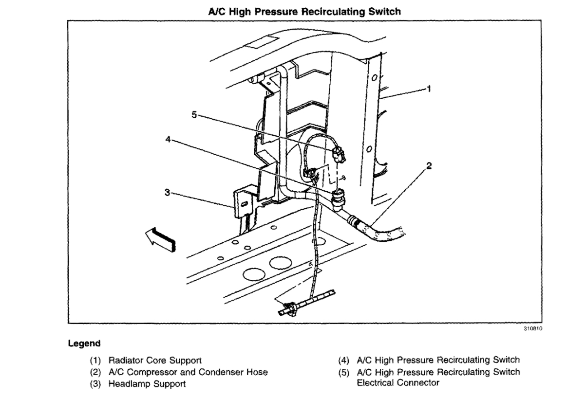

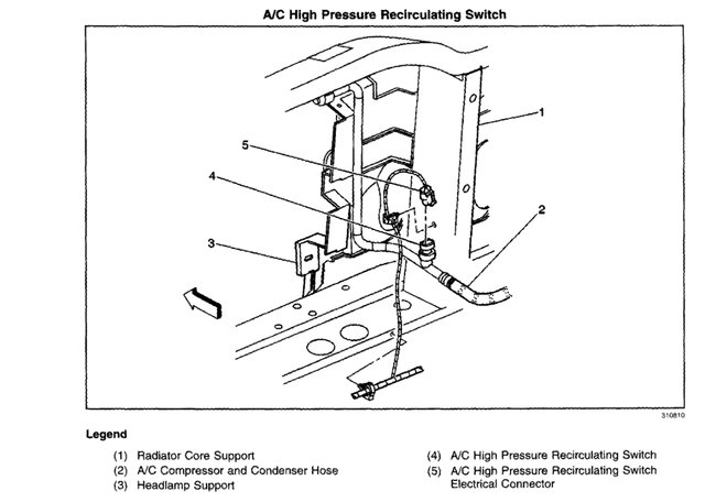

Again, the high pressure switch is grounded externally, not by the ECM. It is G100 as in the diagram.
I attached the location for you.

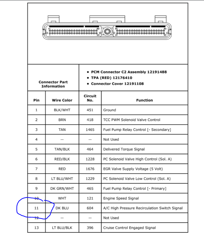

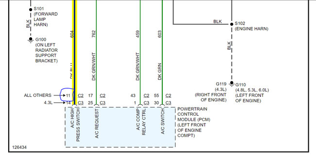

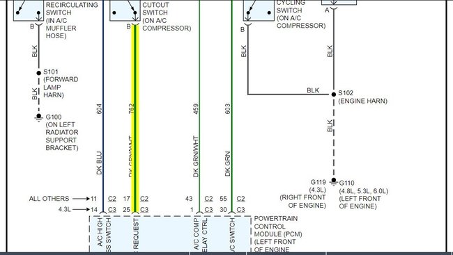

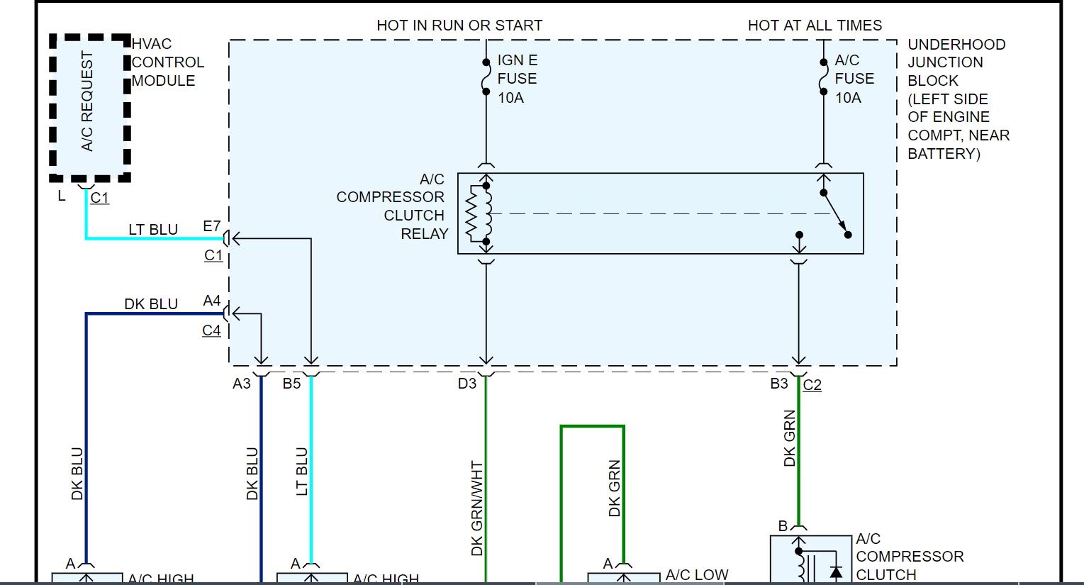

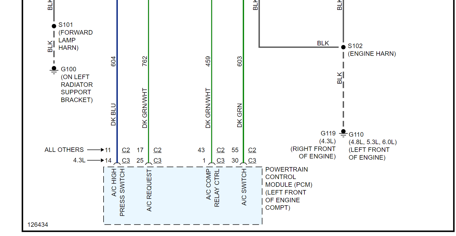

Where does the high pressure switch go on the ECM? What color of connector is it and what pin terminal?
Where does the AC Request go on the ECM? What color of connector is it and what pin terminal?
Thanks
Nov 3, 2020 at 5:44 AM
Pin 11 on the ECM. It supplies voltage to the high pressure switch. Check for voltage with the key in the on position.
I attached the diagram for you of the AC request. I highlighted the wire for you.
Nov 3, 2020 at 6:08 AM
FRO250
  • 52 POSTS
But you said the diagram was generic. What Pin is the AC request?
Nov 3, 2020 at 8:01 AM
The pin is identified in the diagram and the wire color.
All you need to do to confirm is check for power to the high side switch with the key on. If there is power, the ECM is sending the voltage.

Correct. There are some things that you do not have.
I have already told you the pin is marked in the diagram I sent you but you need to test for voltage to the high pressure switch. If you have power, there is no reason to test the pin at the ECM.

I tested for voltage at the high pressure switch 2 weeks ago. I want to test the high pressure switch at the ECM. The high pressure switch is an input device. When the Freon pressure is below 375 psi the switch will be closed. Therefore the voltage can't be 12 volts when the switch is connected to ground. So if the high pressure circuit is working correctly and the pressure is below 375 psi the voltage at the ECM Pin (where the high pressure switch terminates) will be zero. Your diagram doesn't indicate the Pin number. Again what pin is the high pressure switch at the ECM?
Nov 3, 2020 at 10:58 AM
Okay, that was 2 weeks ago and this is now.
Retest the voltage to be sure.
No, the voltage will always be 12 volts to the switch whether the switch is open or closed. The difference is when the switch is grounded.
The ECM pin is where it originates, not terminates.

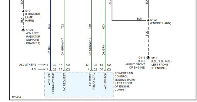

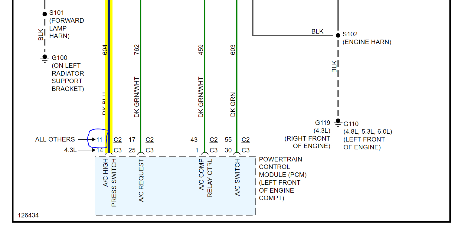

It is pin 11 on C2 connector. I reattached it again for you.
Nov 3, 2020 at 8:07 PM
FRO250
  • 52 POSTS
I'm sorry, but I don't remember seeing an image like that. This is much clearer than the others.
Thank you
Nov 3, 2020 at 10:36 PM
It is the same. I just enlarged it to be clearer.
You are welcome.
Nov 3, 2020 at 10:38 PM
FRO250
  • 52 POSTS
Can I get the rest of that image enlarged like that? Much easier to see on the Phone.
Thanks
Nov 4, 2020 at 1:25 AM
I would not use your phone. I would use a laptop or desktop and print it out.
I enlarged the other sections and attached them for you.

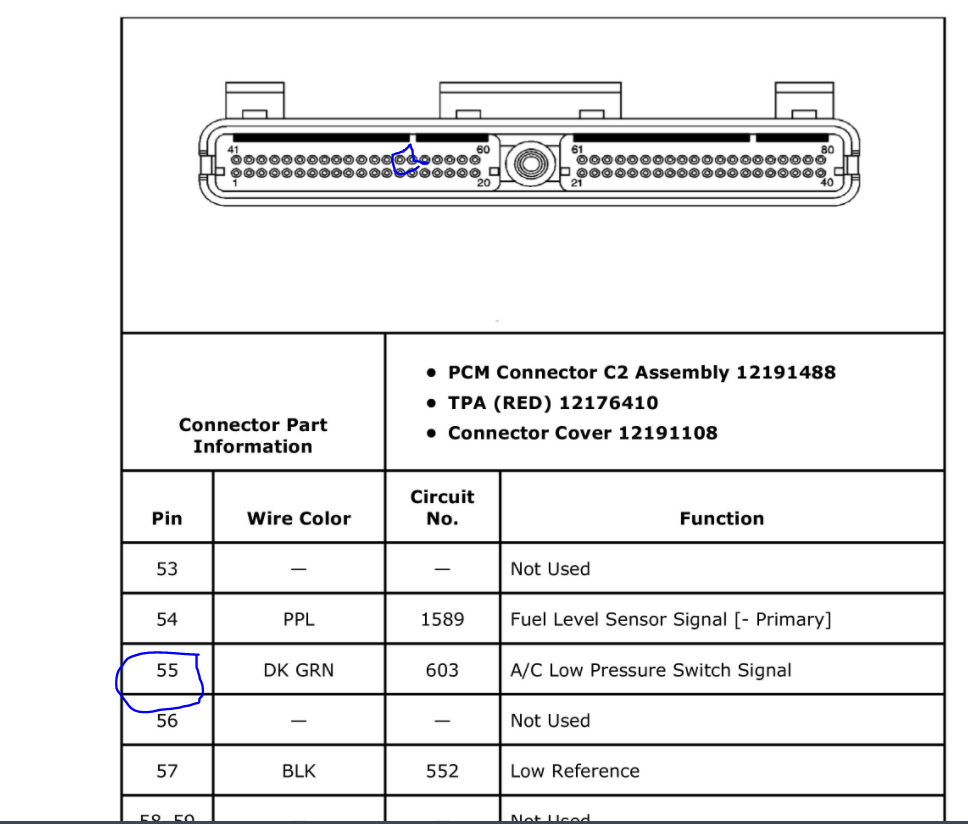

Pin 11 High Pressure switch has power all the time.
Pin 17 AC request is grounded all the time. When the AC button light on or off Pin 17 is grounded, checked both ways 3 times each.
Pin 55 Low Pressure switch is grounded all the time. unless I unplug the low pressure switch then it would have power.
Pin 43 never changed to a ground.
I think Pin 17 being grounded all the time is an issue. I wasn't sure if I could unplug the connector from the ECU and then check for ground on the ECM.
Question
If Pin 11, 17, and 55 are grounded is ECM supposed to ground Pin 43?

Pin 55 is the low pressures switch. Pin 55 has power when the low pressure switch is unplugged, but is grounded by the switch when plugged back in. Which I think is normal.
Nov 7, 2020 at 7:48 AM
Pin 11 is supply power to the high pressure switch. When the switch closes, the other side goes to ground. The power will remain on the positive side. Once power is consumed the ground side goes to 0.

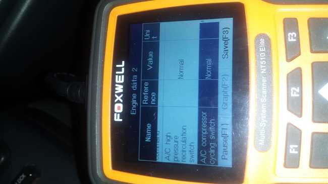

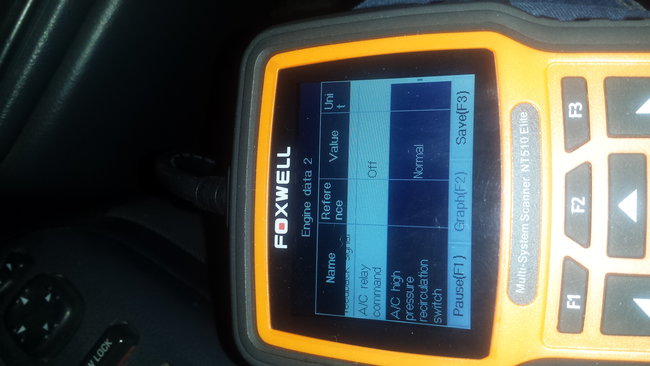

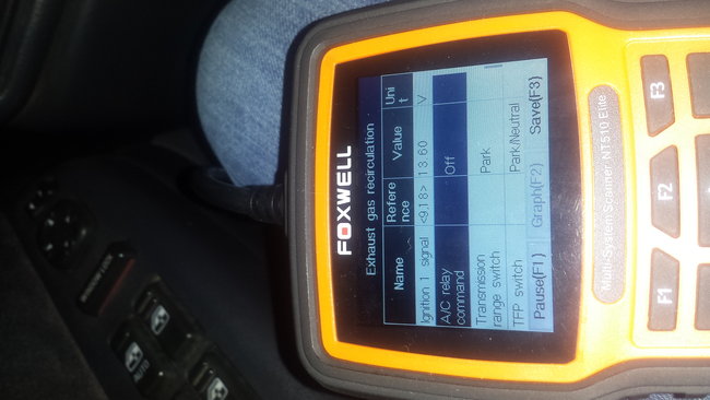

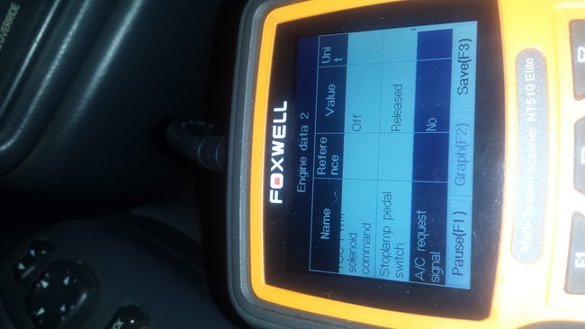

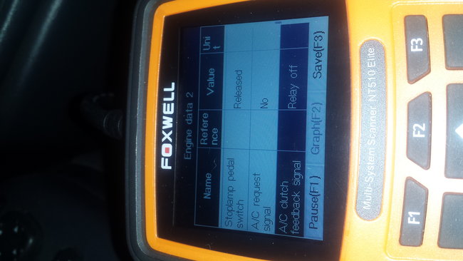

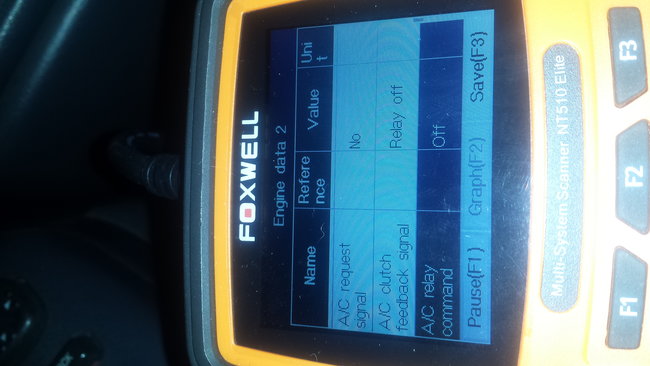

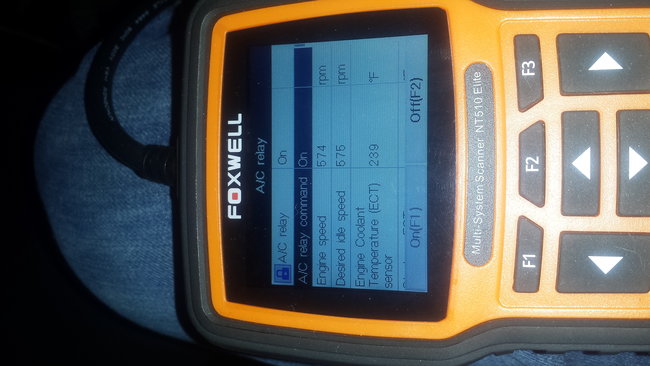

I bought a scanner. There wasn't any faults. A/C system passed. The low and high pressure switches passed. I even unplugged them to see if they would fail, and they did. I was able to force the compressor clutch on with the scanner, that also worked. How can I test the Computer Climate Control(HVAC control Module)? Please show me a Pin out for the Computer Climate Control. What else could hold out the A/C? Is there any inputs to the Computer Climate Control? Please provide diagram. Is there a wire connections, other than ones on the back of the PCM and the Computer Climate Control module that I could un plug and test from? The last picture shows the A/C Relay forced on.
Nov 16, 2020 at 4:49 AM

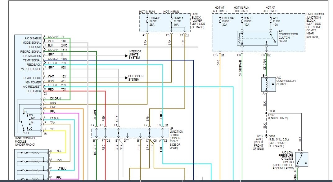

I posted the HVAC module pin for the pressure sensor back on the second page. That is the only control for the compressor. The module has nothing to do with the compressor coming on. The relay and the ECM are the controls.
We have already come back to the ECM 3 times now and the fact that you can ground it through the scan tool tells me the ECM refuses to do it on its own. This means again that it needs an ECM.

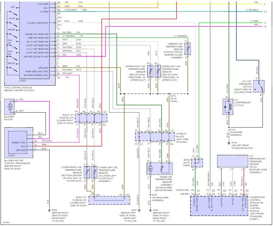

We haven't ruled out everything that could be causing the problem. For instance if the outside ambient temperature is too low something doesn’t all the AC clutch to be activated. The scan tool didn't find anything wrong with the PCM, BUT it did indicate there wasn’t an AC request. I’m not going to replace the PCM before confirming everything else is operating correctly. Isn’t there a temperature sensor on the evaporator?

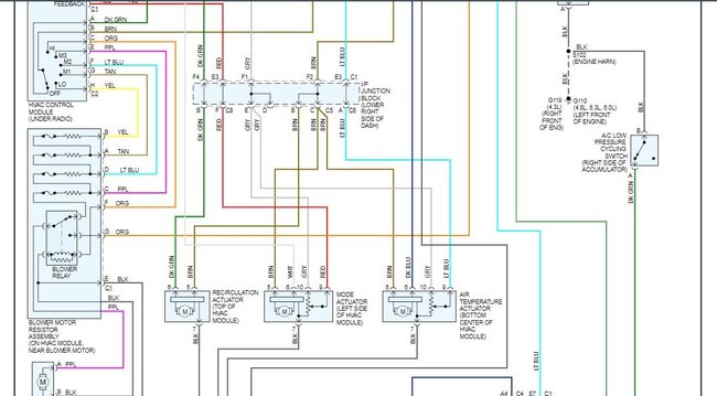

I didn’t ask you what Pin ID on the back of the PCM. I want a schematic of the computer climate control (it is the HVAC control interface in the dash) so I can see all connected equipment. While we are at it, I want a list of all the Pin IDs on that terminate at the PCM. Both connectors.

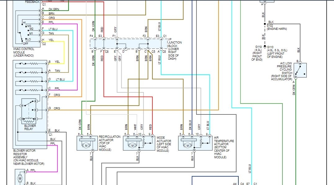

I didn’t ask you what Pin ID on the back of the PCM. I want a schematic of the computer climate control (it is the HVAC control interface in the dash). I want to be able to see all connected equipment. While we are at it, I want a list of all the Pin IDs that terminate at the PCM. Both connectors. Red and blue.

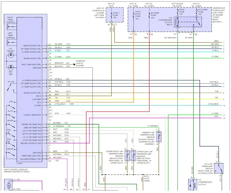

I have attached 2 images of examples of the schematic I'm looking for. Together they show the computer climate control and connected devices. Unfortunately these are not for my vehicle.
Nov 17, 2020 at 3:57 AM

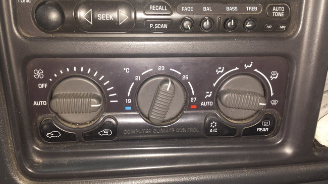

Do you have automatic climate control?
Nov 17, 2020 at 4:23 AM
FRO250
  • 52 POSTS
I'm not 109% sure but I think so. Here is a picture. There is a small vent in the head liner that I think is for sampling air temperature. I can give the last 8 digits of the VIN if that would help.
Nov 17, 2020 at 9:21 PM

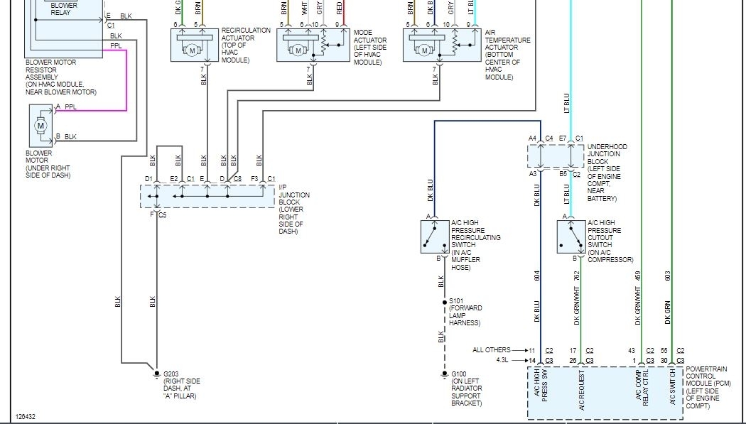

Okay, I attached the one for automatic climate control for you to view.
Nov 18, 2020 at 1:23 AM
FRO250
  • 52 POSTS
Those 2 diagrams are mismatched or there is one in the middle that is missing.
Nov 18, 2020 at 3:41 AM
I attached the small missing portion of the diagram.
Nov 18, 2020 at 3:57 AM
FRO250
  • 52 POSTS
It doesn't look like that diagram is for the computer climate control I have. Mine has 2 Auto settings, 14 position fan speed control.

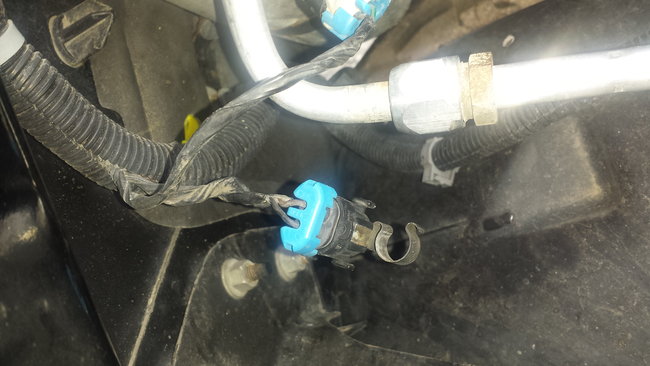

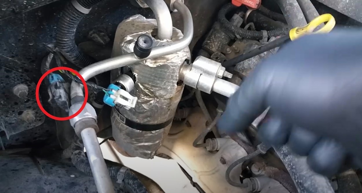

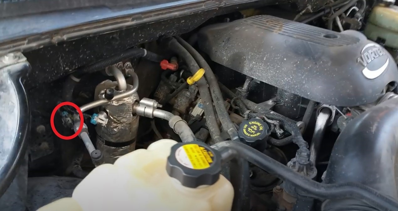

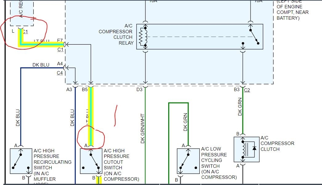

What is this sensor clipped onto the AC line downstream of the orifice? It is circled in red in both attached images. You can see the Low Pressure Switch to the right which is unplugged.
Nov 19, 2020 at 12:49 AM
Yes, I see the switch.
What color wires are on the sensor attached to the high side line?
Nov 19, 2020 at 1:31 AM
FRO250
  • 52 POSTS
Brown and black.
Nov 19, 2020 at 2:40 AM
Okay, I just went over the A/C diagram again and there is nothing in the system that has a brown and black wire attached to something.
Whatever it is, it has nothing to do with the A/C system which is what we are concerned about.

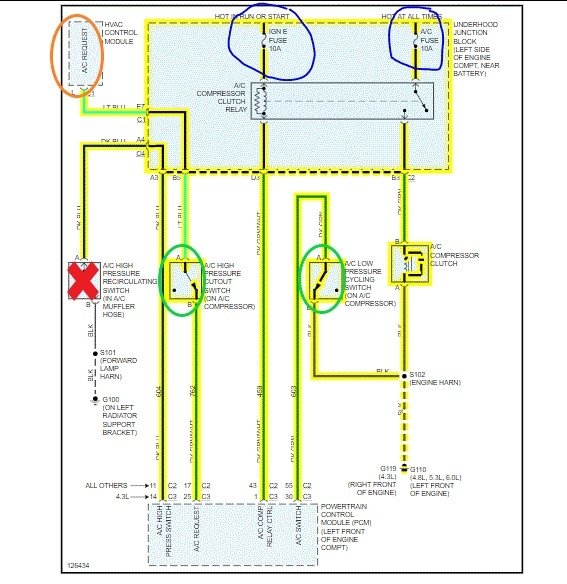

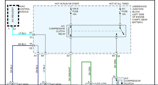

According to all the diagrams you have provided the A/C request comes from the HVAC control module, Through the A/C High Pressure Cut Out switch, to the PCM Pin 17. My scanner didn't find any trouble code. The scanner was able to toggle the AC relay proving that portion worked. The scanner reported a fault for the pressure switches when they were disconnected; it even said which switch was disconnected. The scanner also reported a low pressure fault code to the high pressure switch when I forced on the AC relay for too long during cold weather. The scanner indicates it's not getting the AC request. This makes me think it's not the PCM. I don't see anything in any of the info that indicates a faulty PCM. What is the reason you are saying it is the PCM? My thinking is the computer control module isn't putting out an ac request.
What i need to know is how the computer climate control module works, and connected devices effect it's function and the devices are connected to the computer climate control module. There could be a HVAC input device causing the module not to put the ac request or maybe the computer climate control module is faulty or maybe it is the PCM, but until i know for sure before i replace something or get a PCM programed by the dealer.
Nov 19, 2020 at 6:54 AM

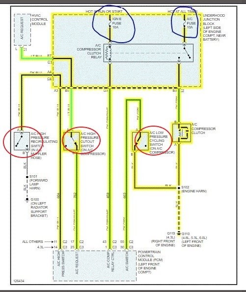

I put up another diagram of the AC request. That light blue wire from the control head goes to the high-pressure switch.
You stated way back you had power there. The wire changes color to dark green/white as you see. Is there power at 17 with the connector disconnected? Look for power on the harness, not the ECM.
