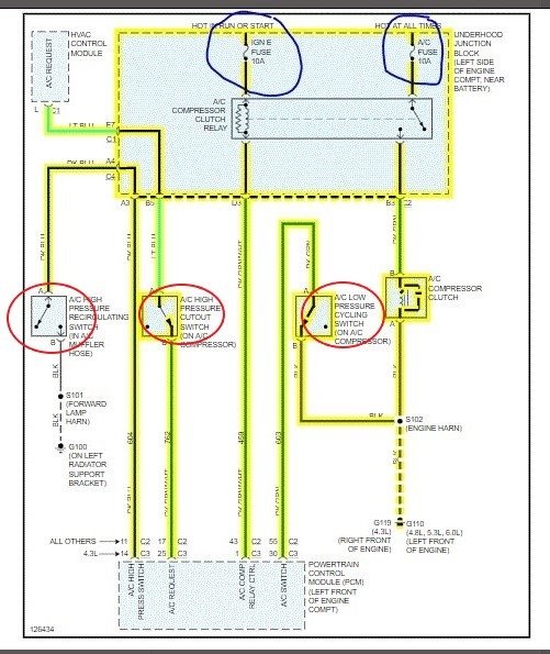

Good afternoon,

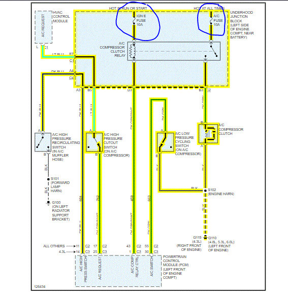

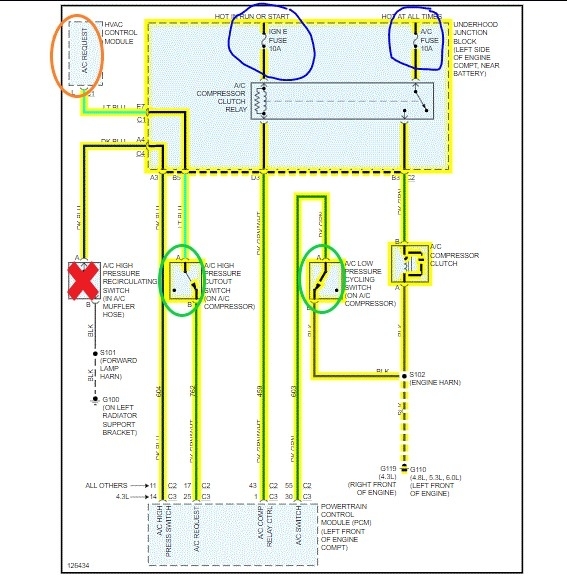

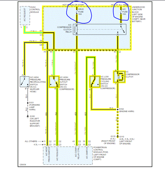

I attached the wiring diagram for you to view of the compressor circuit.
Check the fuses I circled for power on both sides. It is not a visual test, it is a power test.
Check the voltage at the low-pressure switch and high-pressure switches as well.
Let me know when you want to do some testing and I will help guide you through.

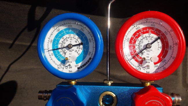

Okay, the next step is to check the Freon pressures. Can you give me the high and low side readings of the Freon?
Oct 10, 2020 at 8:42 AM
FRO250
  • 52 POSTS

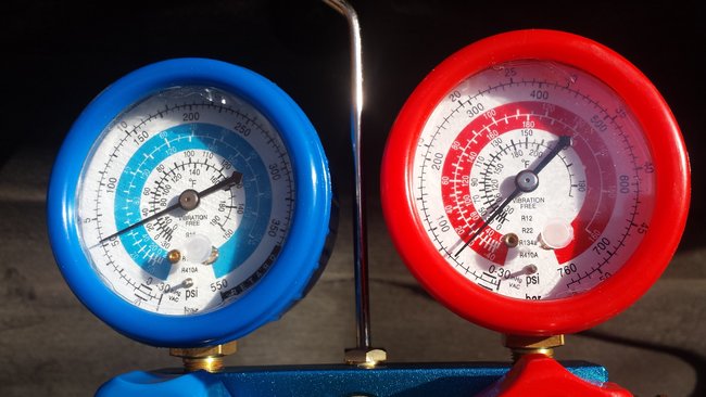

Low side 67 psi
High side 67 psi
See attached image.
Oct 14, 2020 at 10:02 AM
What is the outside temperature?

42 degrees Fahrenheit.

Okay, I posted the diagram of the relay previously. Can you verify power to the clutch relay with the key in the on position?
Oct 14, 2020 at 10:20 AM
FRO250
  • 52 POSTS

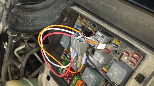

I failed to mention that my GMC dealer says there is 2 A/C Compressors listed for my truck and mine is the least used. GMC part # 89024907. I only mention it, because I can't the third A/C Switch in the diagram. I don't have any wires going to my A/C Compressor.
I made a Relay Buddy to make it easier to verify power to the relay.
Pin 85 has power and goes to one side of the relay coil.
pin 86 doesn't have power and goes to the other side of the relay coil. When pin 86 is grounded the relay closes and the A/C clutch is activated.
Pin 87 has power.
Pin 30 doesn't have power and goes to the A/C Clutch. When pin 30 is jumpered to positive on the battery the A/C clutch is activated.

Okay, pin 30 should have power all the time.
Pin 87 goes to the clutch itself.
Pin 86 is ignition power.
Pin 85 is the ground. That is controlled by the ECM based on inputs from the pressure sensors.
When you ground 85 and the compressor runs, what happens to the pressures? Can you tell me those pressures?

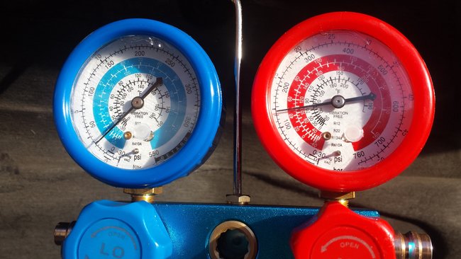

Low side was 25 PSI
High side was 140 PSI
That was after one minute.
The high and low side were both 52 PSI before the compressor was started. The outside temperature 50 degrees Fahrenheit.
Oct 27, 2020 at 10:05 AM
Okay, the pressures look good when it is running.

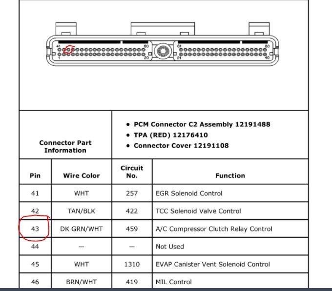

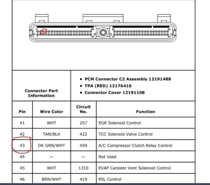

I attached a diagram of the red connector on the ECM. You need to back probe the wire I circled. There should be 12 volts there. If there is, the ECM is not grounding the relay and the compressor will not work.
Oct 28, 2020 at 6:36 AM
FRO250
  • 52 POSTS
I don't understand your statement. You said there should be 12 volts there, and if there is the ECM is not grounding the relay.
Oct 28, 2020 at 1:20 PM
That is correct. The ground will have voltage from the clutch relay until the ECM grounds that wire. Then there will be 0 voltage and the relay will engage.

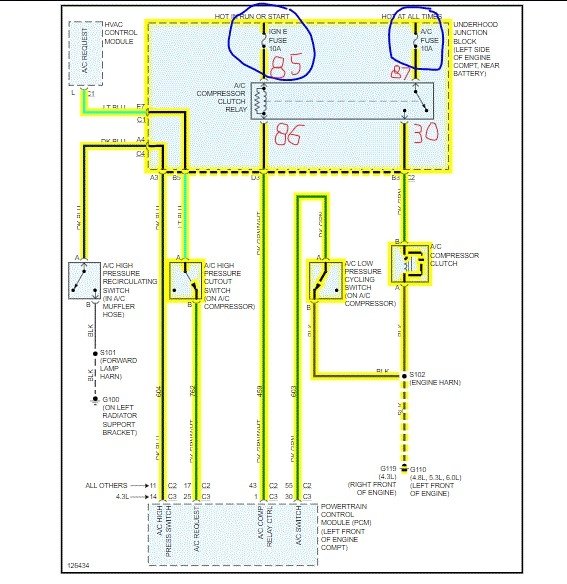

I said
Pin 30 goes to AC Clutch coil and when jumpered to +12vdc the clutch pulls in and the compressor runs.
Pin 87 has +12vdc all the time
Pin 86 doesn't have power and goes to the other side of the relay coil. When pin 86 is grounded the relay closes and the A/C clutch is activated.
My 86 and 85 is the opposite of yours
My 30 and 87 is the opposite of yours
I have marked the Relay Pins on your diagram according to my findings. Please see attached image.
Oct 29, 2020 at 2:30 AM
FRO250
  • 52 POSTS
Also I can only find 2 pressure switches on my AC circuit. One on the low side of the orifice and the other on the high side of the orifice. Which high pressure switch in the diagram am I missing and where is it supposed to be?
Oct 29, 2020 at 2:34 AM
Okay, they are backwards
Pin 30 is constant voltage. It is where you have 87 marked.
Pin 87 goes to the compressor .
Pin 86 is ignition power or is where you marked 85.
Pin 85 is the ground for the control side of the relay.
Oct 29, 2020 at 2:59 AM

I see now the relay can be installed 2 ways and it works both ways.

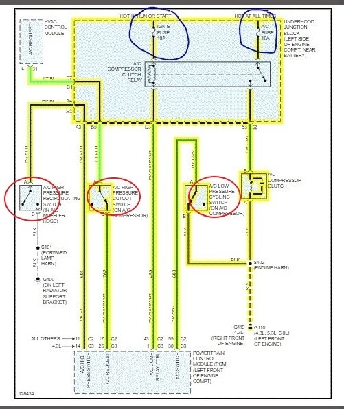

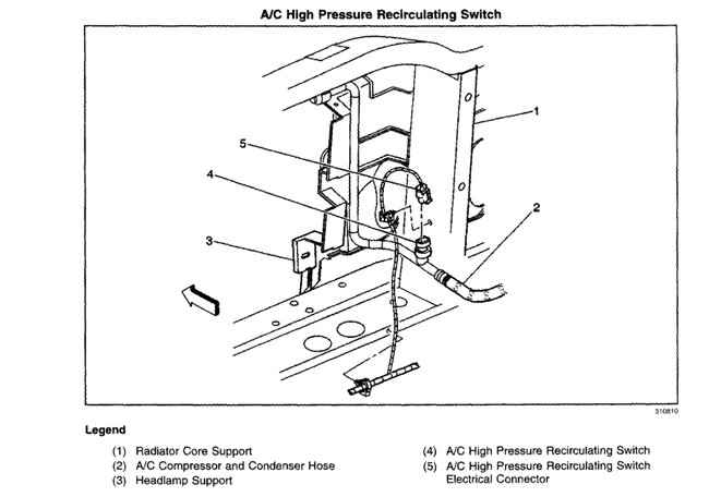

What about the third pressure switch I can't find?
Oct 29, 2020 at 5:16 AM

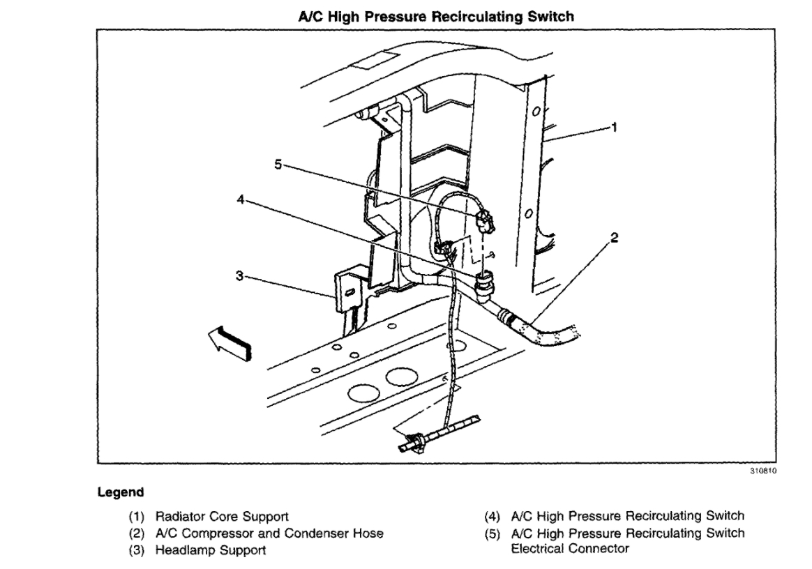

I attached a picture of the switch for you to view.
Oct 29, 2020 at 5:24 AM
FRO250
  • 52 POSTS
I have accounted for that one. Where is the other one?
Oct 29, 2020 at 6:16 AM
There are no other switches.
Oct 29, 2020 at 6:28 AM
FRO250
  • 52 POSTS
In the picture it shows 3 switches. I have only found 2 of them. I circled the 3 pressure switches. Please confirm.
Nov 2, 2020 at 12:44 AM
I see that. The only thing is that the wiring diagrams are generic for most models.
You only have 2 switches.

I checked ECM. When I back probed pin 43 to ground the compressor relay closed and the compressor clutched pulled in. I let it run for 5 minutes at 2,500 rpm's and the temperature at the vents was 43 degrees F. But before I decide to get a ECM, I would like to test the request for AC input into the ECM. Can you tell what pin that is please.
Nov 2, 2020 at 2:34 AM

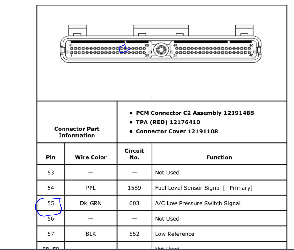

Okay, red connector pin 55 in the diagram I attached.
Check for power with it disconnected. You should have voltage. Then hook it back up and there should be 0 volts if the ECM grounds the signal.

I would like to check all input devices to the ECM. I reference the diagram you provided.
1. The red X is the pressure switch you said my Sierra truck doesn’t have. Have I crossed out the correct switch?
2A. The A/C request / High Pressure switch is a series grounded circuit that comes from the HVAC control module, through the High Pressure Cutout Switch, and to the ECM Red Pin 55. The switch will open if the pressure is too high. Is this correct?
2B. The A/C Low Pressure switch is a grounded circuit that grounds the ECM Red Pin (Please provide Pin ID). The switch will close when the Freon pressures is too Low. Is this correct?
3. Once the above statements 2A and 2B are proven Grounded the ECM will ground Red Pin 43 which will activate the A/C Compressor Clutch Relay coil. Is this correct?
4. The AC Relay closes providing +12 volts DC to the A/C Compressor clutch, thus engaging the compressor. Is this correct?
List of A/C devices:
-HVAC Control module (only provides a ground via through the High Pressure Cutout Switch)
-A/C High pressure cutout switch (opens when the Freon pressure is too high) circled in green
-A/C Low pressure switch(Closes when the pressure is too low) circled in Green
-A/C Relay
-A/C Compressor clutch
-TWO 10AMP fuses
-ECM
-Wires and connectors
What other devices, if any, can be the cause of the A/C relay not to close?
Thanks
Nov 3, 2020 at 2:07 AM
2. Correct. It opens at 375 pounds.
2B. I did in the last response. Pin 55 is the ground for the low pressure switch.
3. Correct. Once the ECM sees this signal, it should ground that pin.
4. Correct again.
Your X is incorrect. That is the one you have. The other sensor is the one that does not apply.

Low pressure switch to Pin 55.
High pressure is an external ground not controlled by the ECM. The ECM provides power to the switch as in the diagram I posted.
