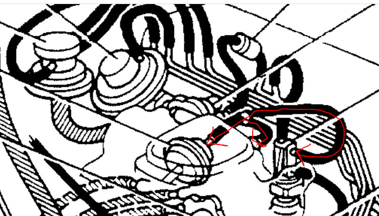

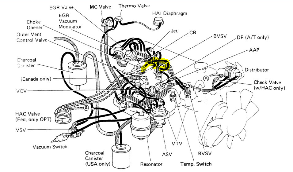

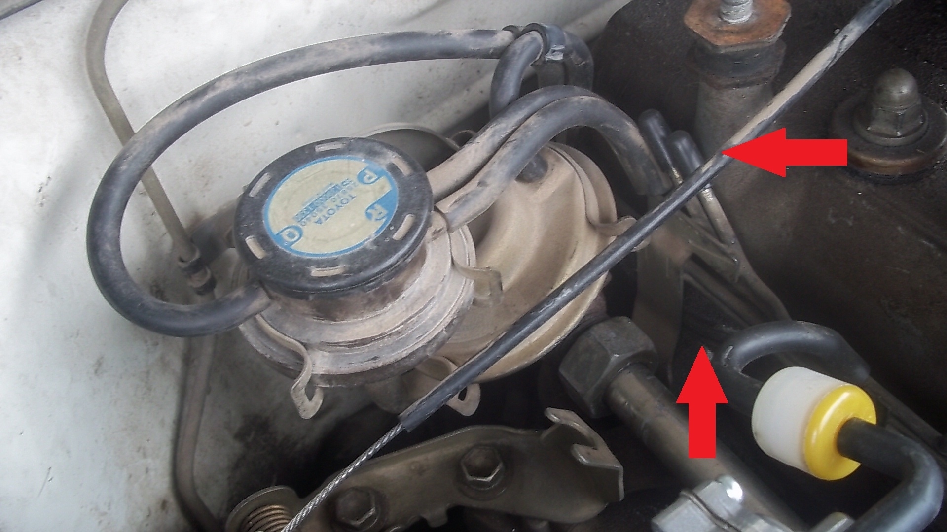

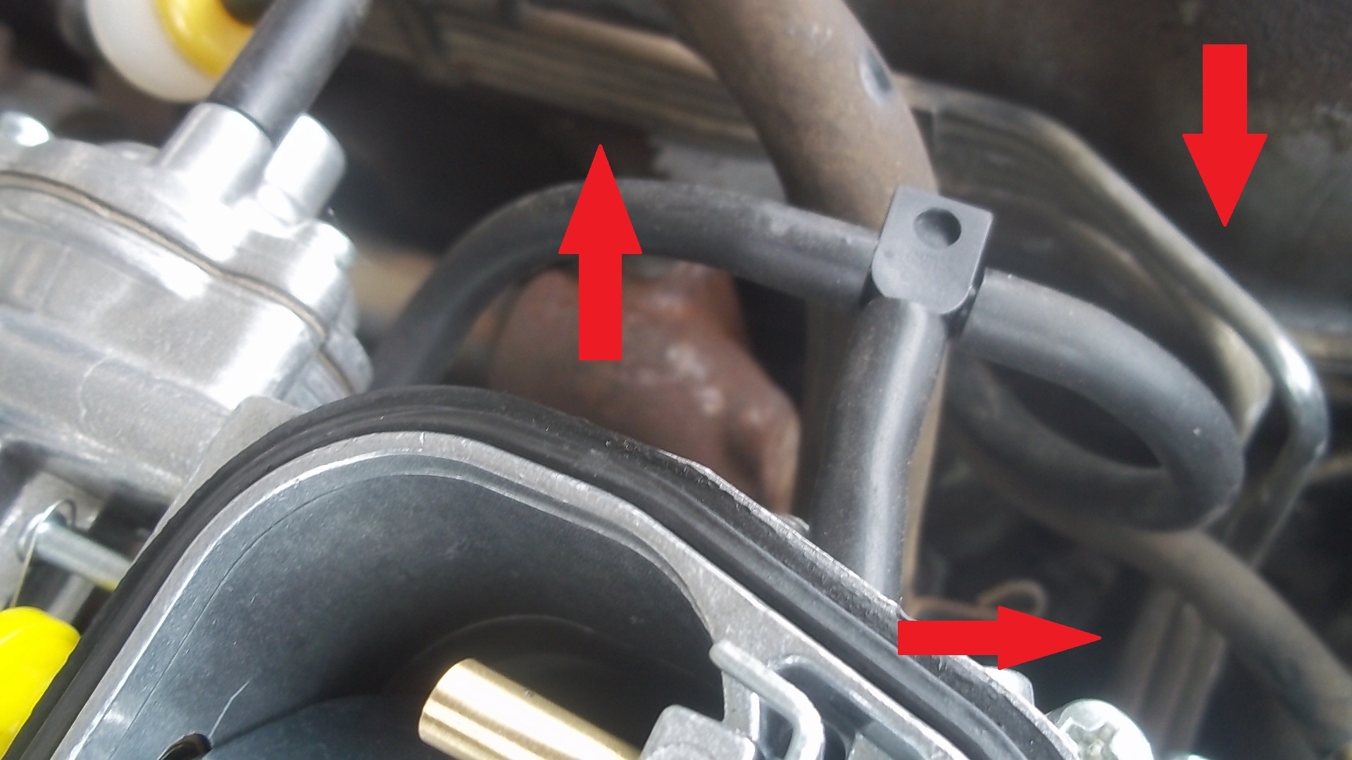

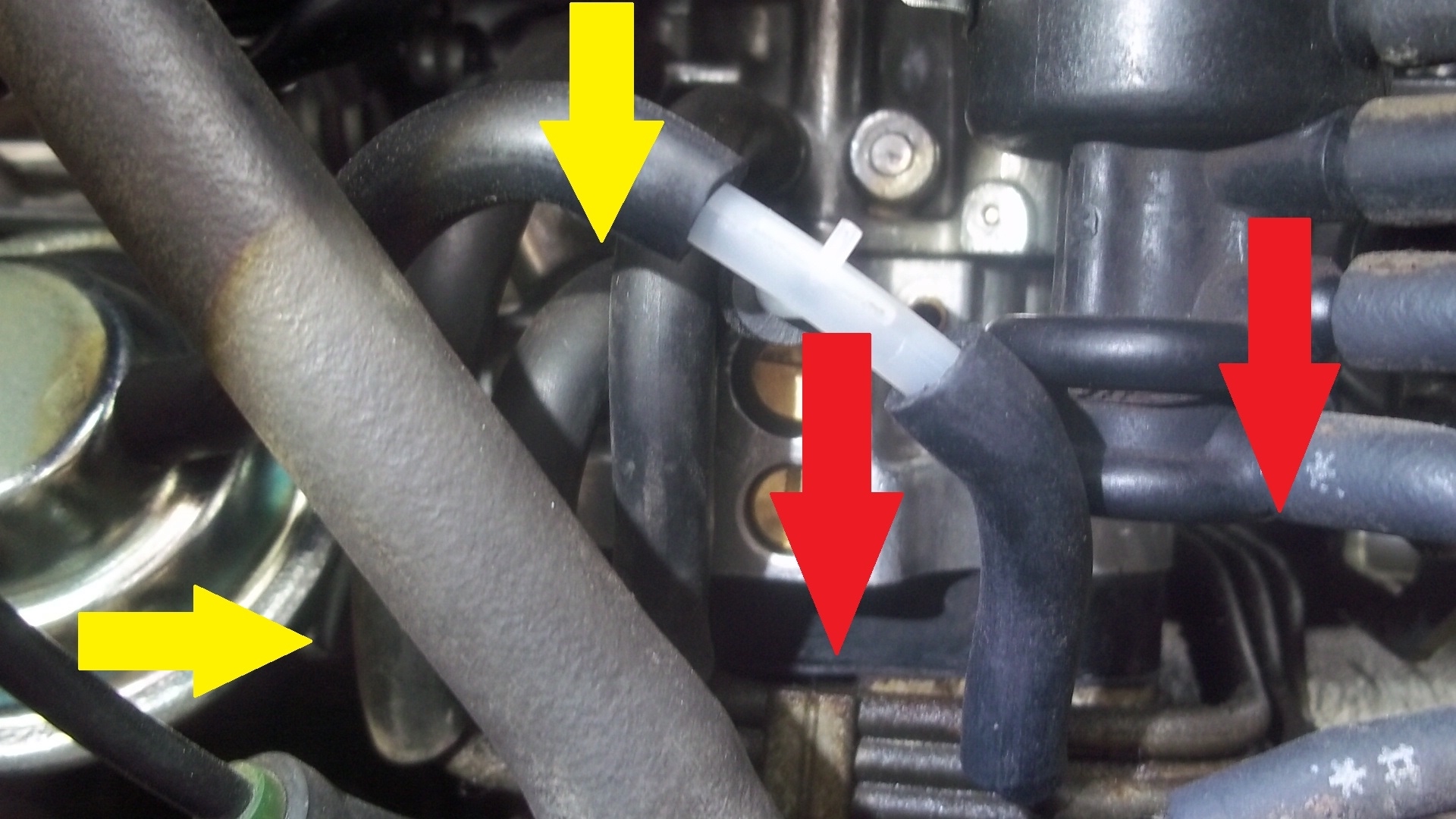

We can't give up. I noticed in pic 1 is the distributor. Is that correct? If so, one of those hoses should go to the base of the carb. The two plugged in pic 4 appear to run between the EGR modulator and the outer vent control valve. I also noticed that three of the steel lines in pic go to the EGR modulator. Two of them are on one side of it and the third is 180 degrees away. Did you notice that?

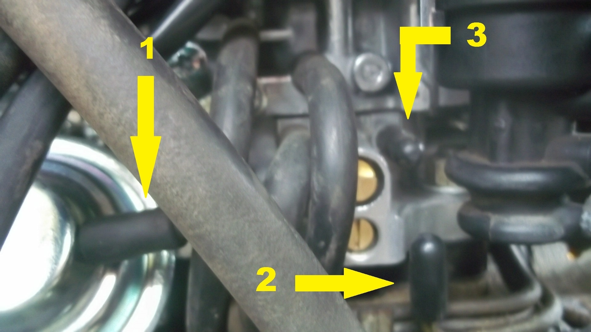

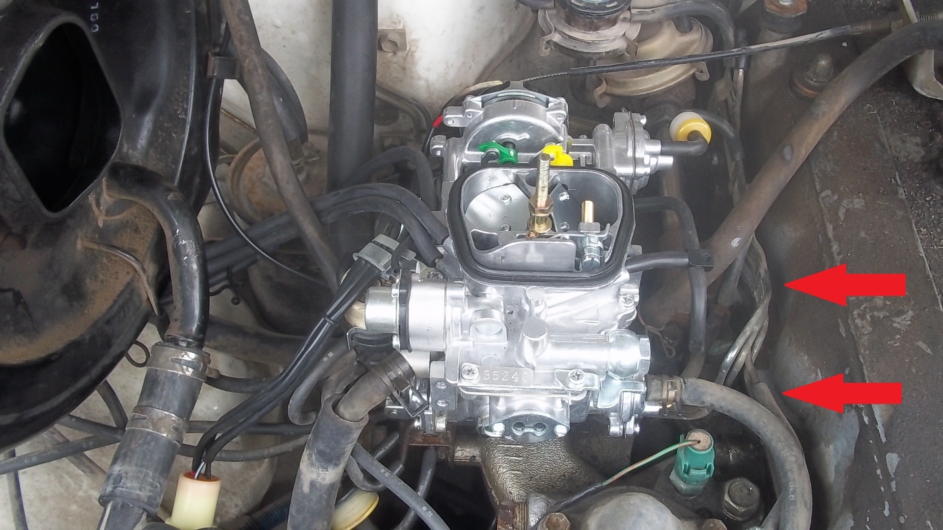

There are two rubber vacuum hoses coming from the distributor attached to two 1/8" metal tubes (pic 1) that appear to be going to the carburetor. These two metal tubes cannot be specifically traced to the carb because they join another header of several tubes wrapping around the carburetor (pic 2) in tight areas that cannot be accessed with clarity.
In pic 2 the red arrows point to the header of metal tubes that the two metal tubes from the distributor join in with. The yellow arrows in pic 2 show that there are rubber vacuum hoses connected to the carburetor from the metal tubes header. But it is impossible to know where they are going to.
As for your comment, "the two plugged in pic 4 appear to run between the EGR modulator and the outer vent control valve. I also noticed that three of the steel lines in pic go to the EGR modulator. Two of them are on one side of it and the third is 180 degrees away. Did you notice that?" i do not understand what any of this means. I do not know anything about what or should not be with this.

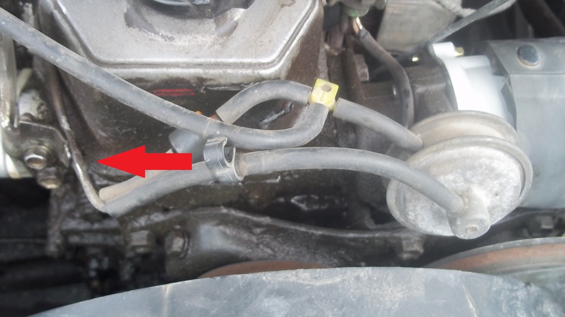

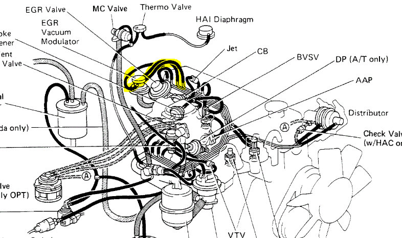

I was wondering if you were able to trace the ones from the EGR modulator. See pic below.
In the areas where you can't trace the steel lines, disconnect a few hoses on both ends and force low air pressure through one at a time to see if you can locate the opposite side.
