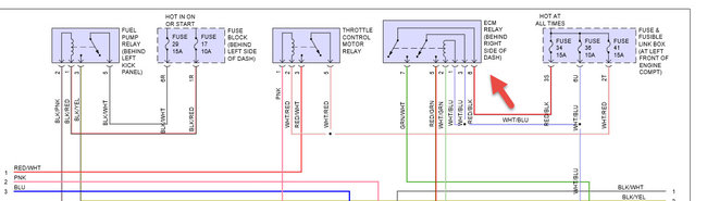

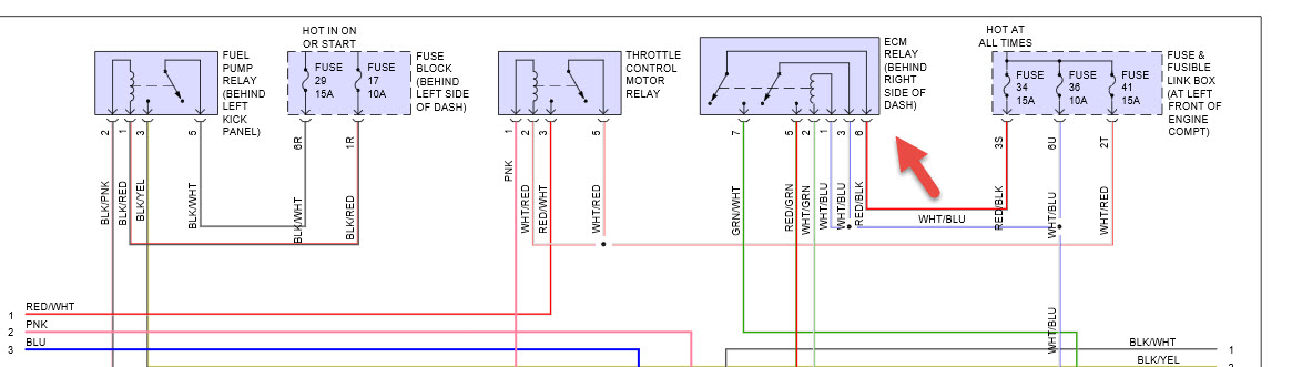

HMAC300
  • 48,601 POSTS
Ok and it showed no codes? Then check all fuses under hood and ecm relay under hood see pic. Also check fuses in dash if you haven't already.
