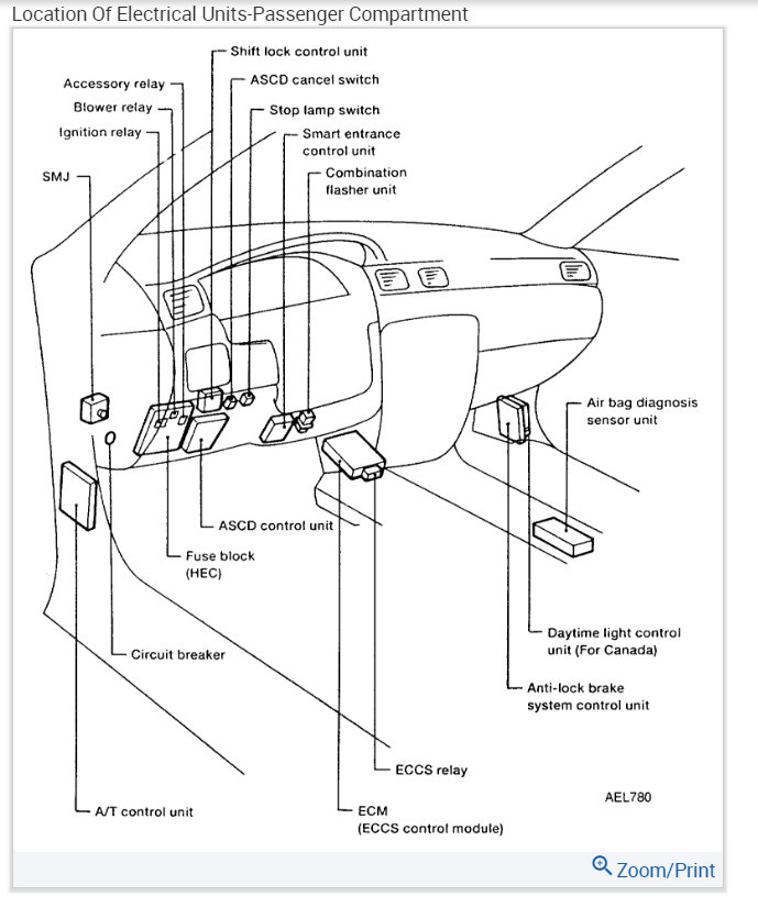

Changed the distributor cap and rotor, changed the spark plugs and wires, fuses are fine, battery is fine. Car turns over but will not start.

There is an ECCS relay that powers the computer that sounds like it is not working. Here is a guide and the location of the relay so you can test it and go from here:

You nailed it the relay was wet once. I replaced it it started right up. ;) Cost me $32.00 for the relay. I love this site.
