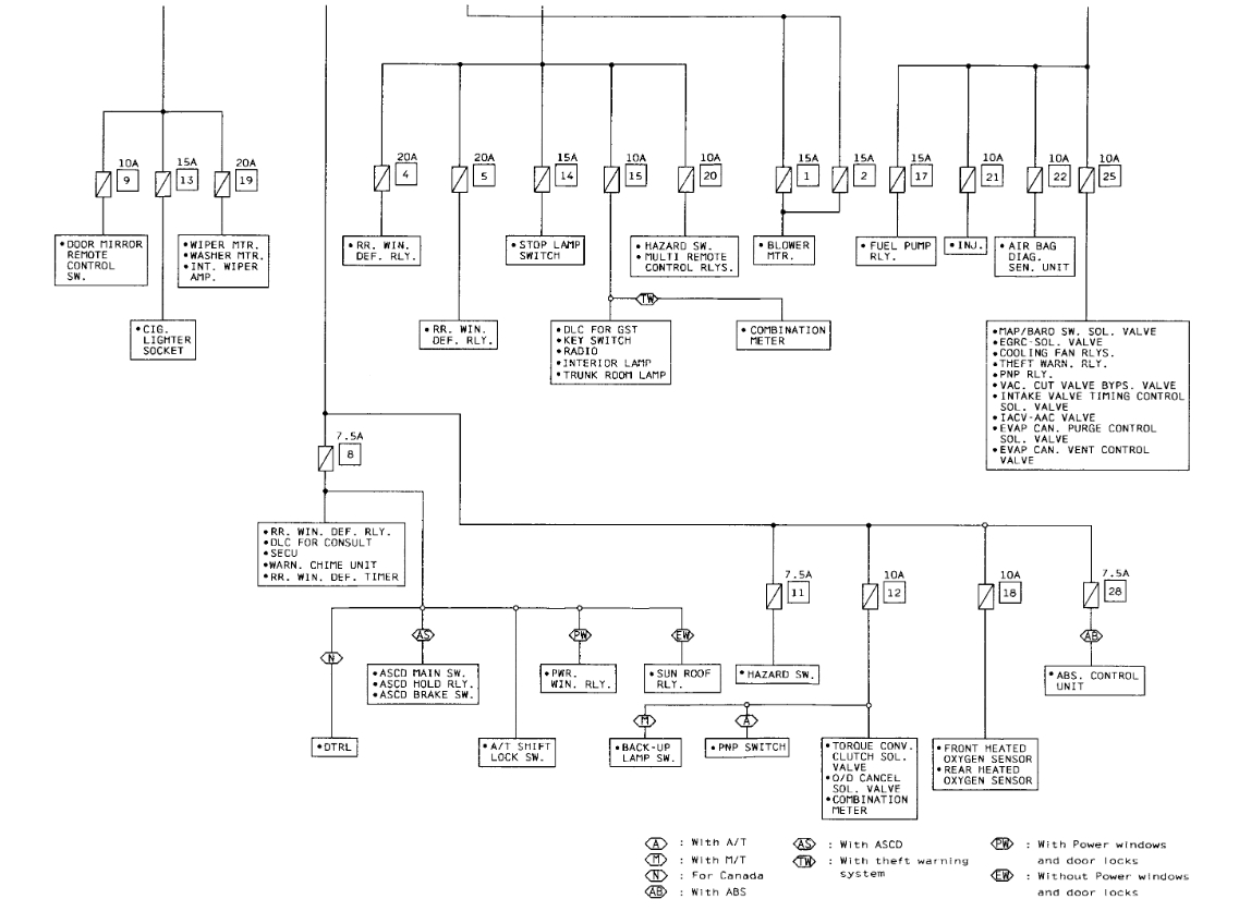

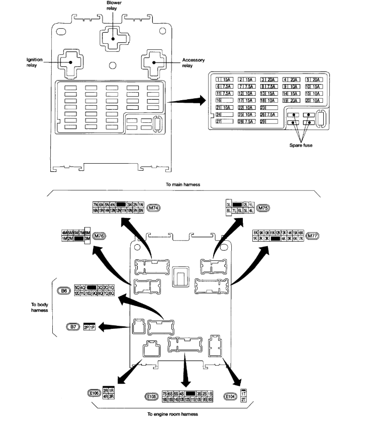

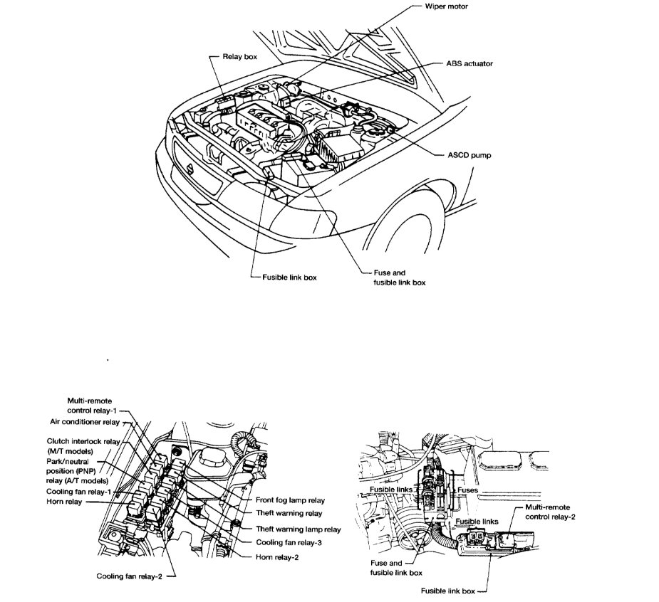

Car stalled then started back up, after parking it engine cranks but will not start, replaced battery replaced starter engine just clicks a little now, when i put a code reader on it says there is no connection.
Jul 14, 2010 at 12:08 PM
  • 75,992 POSTS

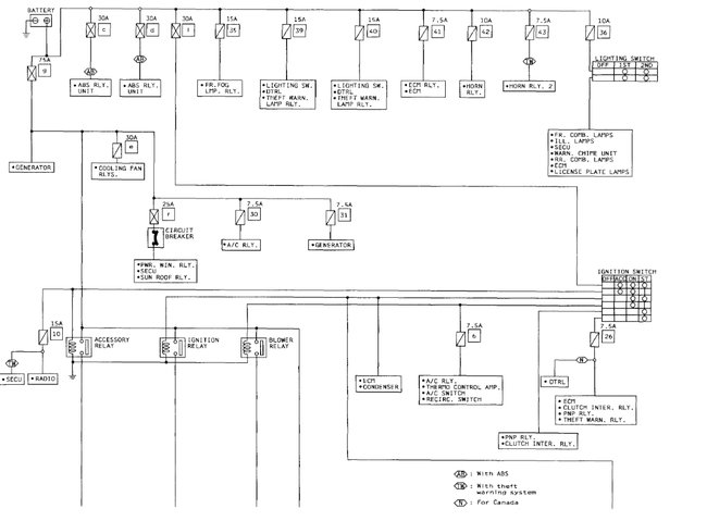

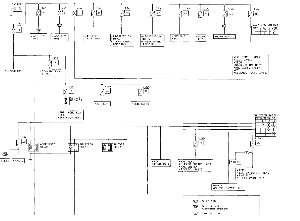

It sounds like you could have a fuse out but to be sure lets check the fuses using this guide with the fuse diagram below turn the key on before you begin.
This guide can help as well.
Check out the diagrams (Below). Please let us know what you find.

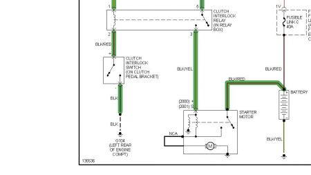

3PITBULLS
it's been a really good car(reliable)no problems with it before,yesterday we stop at the gas station to put gas,turned off car,when trying to go home we disable the alarm(factory),got in the car,nothing it will not start,everything else works,light,stereo,power windows,all,but it just won't start,so i disconnected the battery,thinking it was the engine demobilizer from the alarm,after a few seconds,put it back,nothing,checked battery,is good,the only way it works is by pushstarting it,the starter itself does not make anyclicking noises when trying to start the car,im going to check the switch thats behind the clutch pedal(there's 2)to see if thats the problem,ANY OTHER IDEAS, i should try,thanks you guys,this is my first time on this site,i think is great to have something like this and somebody pro's like you guys helping all of us with our problems!!!!!!!!! thanks again....ZAMCHO(from New Mexico).............
Mar 27, 2020 at 5:18 AM (Merged)
  • 75,992 POSTS
Try the fuse and interlock relay see below start circuit diagram
https://images.2carpros.com/forum/automotive_pictures/12900_s1_4.jpg
https://images.2carpros.com/forum/automotive_pictures/12900_s2_4.jpg
