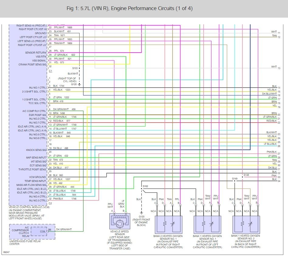

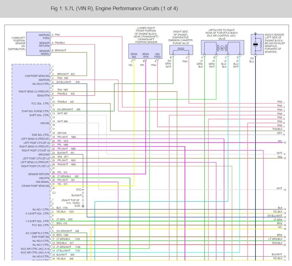

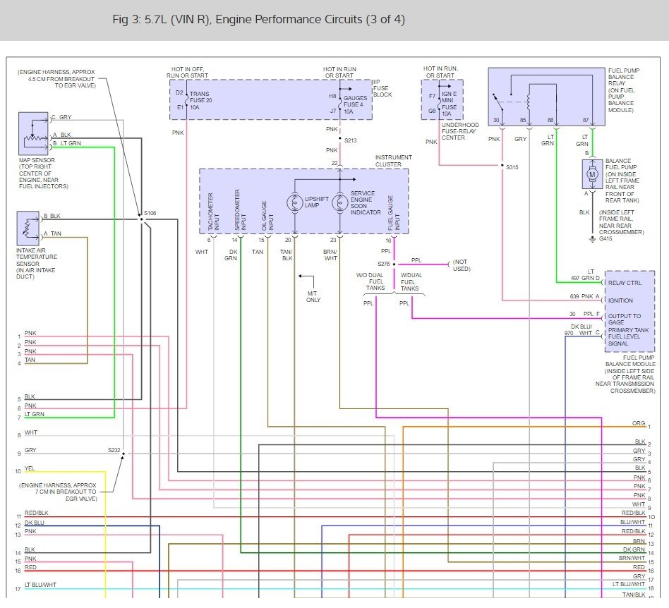

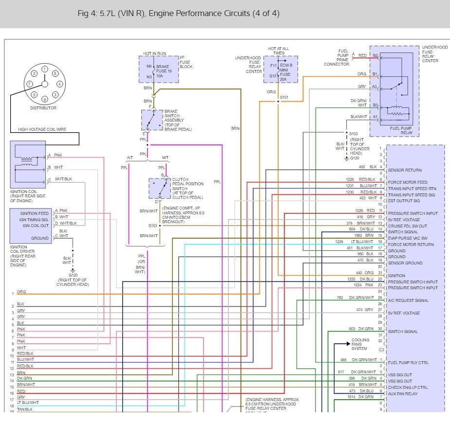

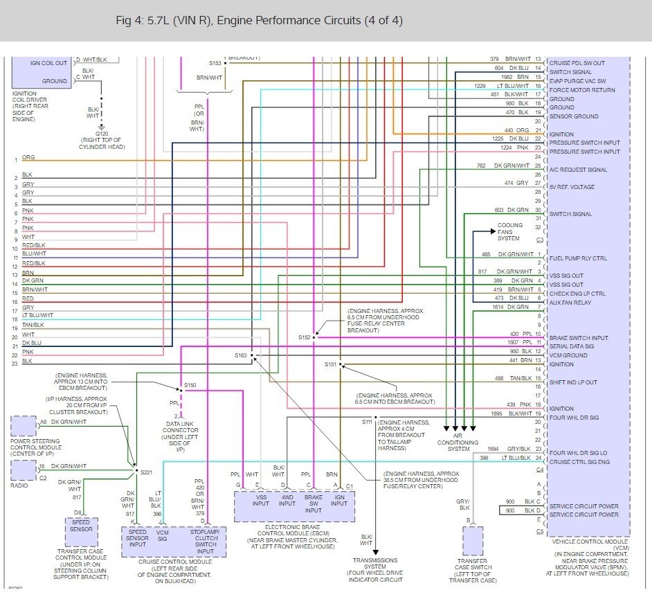

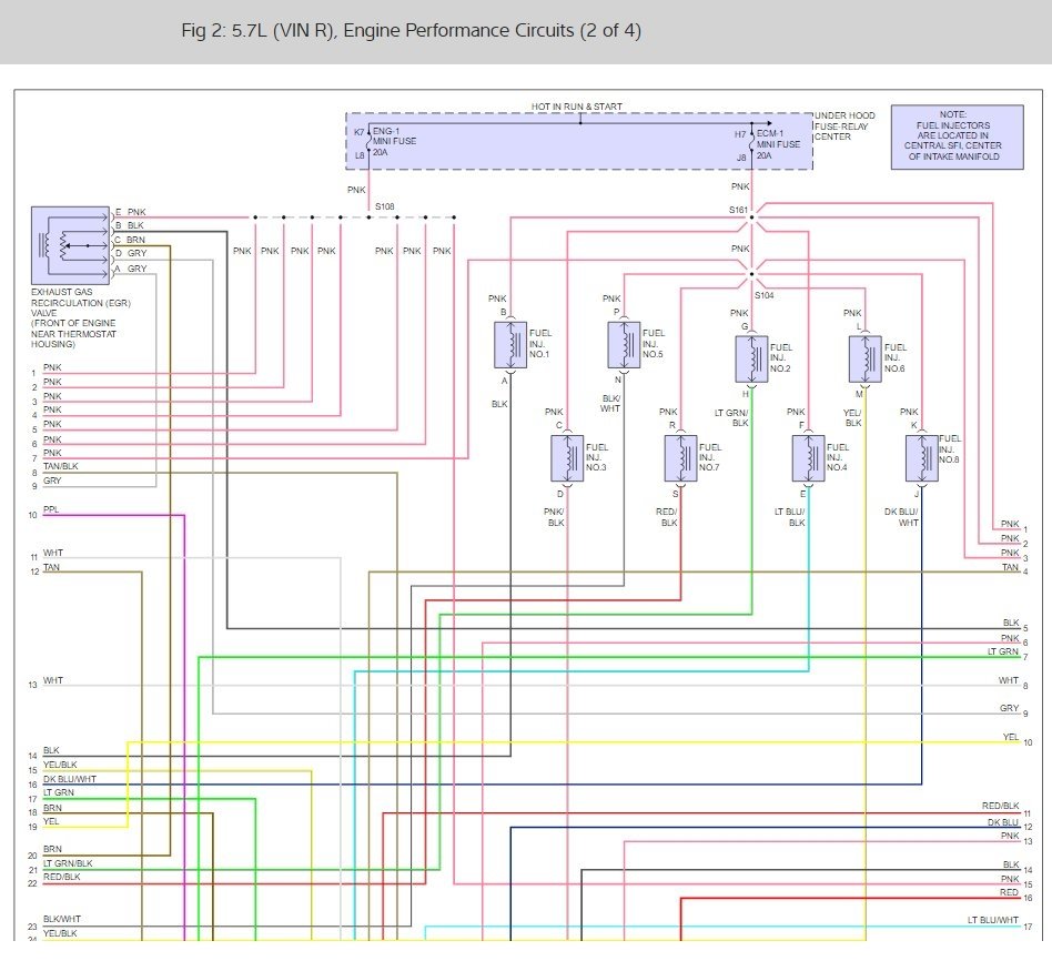

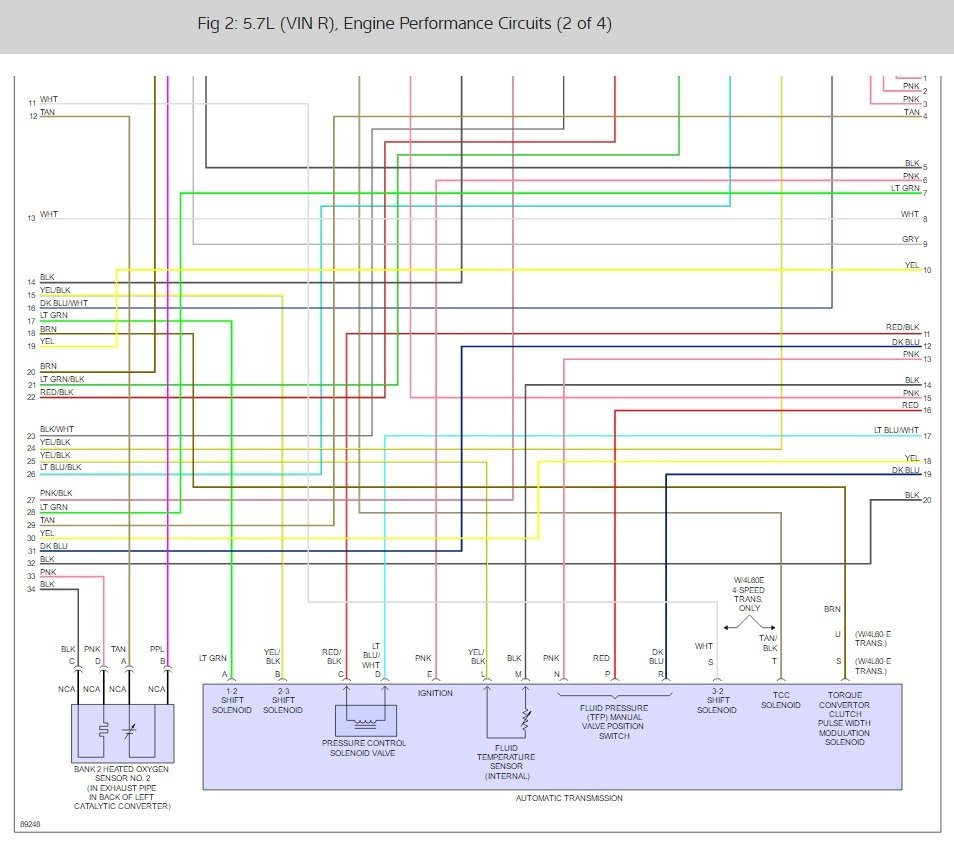

Okay, lets check to see if the system has power there are some fuses that need to be checked first, Here is a guide and some diagrams to help you find the problem.
You are looking for power at the injectors with the key on. This will tell us if the computer is powered up.
Please run some tests and get back to us so we can continue helping you.

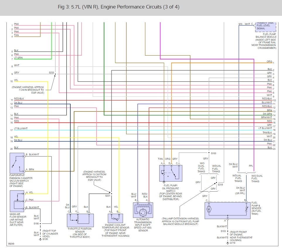

Okay, if it tried to run on starting fluid it has spark. Check the actual fuel pressure. I have seen a lot of bad pumps straight out of the box. Also, did you replace the pump connector with the new pump? Second, check that the fuel pump relay is actually working as well as the oil pressure sender. GM uses the relay to prime the fuel system but once it has oil pressure the power feeds through the oil pressure switch to the pump. That way a loss of pressure shuts the engine off. The normal symptoms in them are, Long crank and then the engine starts, this is usually the relay or it's socket causing a lack of the first prime and the oil pressure switch has to trip on before fuel flows. The next most common is for the engine to start and then die real quick. This is a failure in the OP switch causing the power to the pump to shut off. A quick way to test for both of those is to jump battery power directly to the fuel pump prime wire. This will be a gray wire that is taped up near or in the harness near the fuse box. It feeds power directly to the pump. If you apply power and the truck runs, the oil pressure switch has failed.

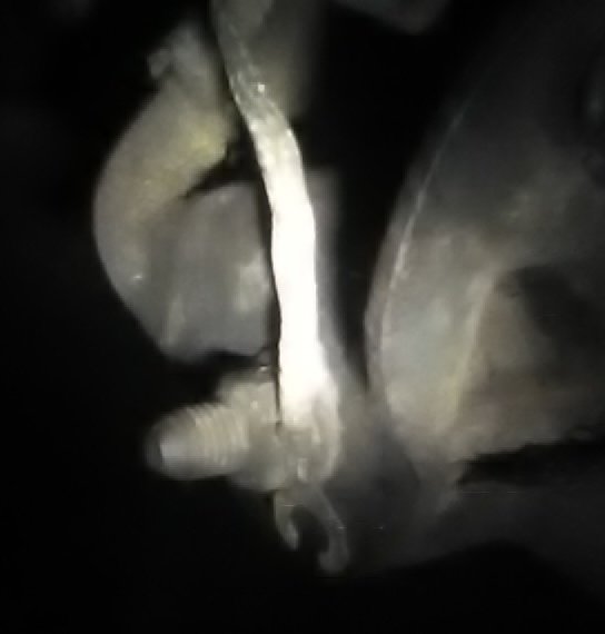

Okay, I will check the items you have suggested. I did replace the fuel pump sending unit and I replaced the fuel relay. Are you referring to the fuse box under the hood for the grey wire? I decided to walk through the whole truck today just to make sure that there was not anything that wasn't completely connected and I noticed this cable wire hanging. One end of it is bolted to the frame by the fuel spout and the other end is not connected. Do you know what this cable wire is for and where is it suppose to be connected to? Thanks a bunch for all your assistance I greatly appreciate it.
Jun 26, 2019 at 6:36 PM
STEVE W.
  • 15,352 POSTS
That is the ground wire for the tank and filler, it should bolt to a clean spot on the top of the tank usually at the pump to provide a ground.
Yes the grey wire will be near the underhood fuse box.
