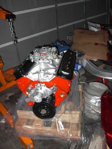

The engine is a new 350 which ran great and then started to miss, then not start. I've changed the HEI dist. starter, new plug wires, confirmed timing and unhooked all of the wiring to the alternator and the rest of the car. I still have great compression in all of the cylinders and everything is moving the way it should. I am dropping to just over 9 volts while cranking. How much voltage does the HEI need, and what else could be causing this problem. This is the 3rd HEI dist. all with the same problem. Fuel is OK.

I would say remove the old resistance wire and rewire it from the switch to the HEI
The HEI takes full battery voltage to function properly. The HEI coil throws out a higher spark than the cylindrical coil. Makes sure you put that special grease under the ICM.

Re-route the spark plug wires to prevent crossfire and replace old fuel with fresh higher-octane gasoline. Also feed the HEI full battery voltage instead of a resistance wire, and apply the specified grease under the ignition control module.

The owner of a restored 1963 Chevrolet Bel Air with a new 350 reported intermittent spark and hard starting after the engine had run well. Compression, timing, the starter, plug wires, and several HEI distributors were checked, and voltage dropped to just over 9 volts while cranking. An expert advised supplying full battery voltage to the HEI and using module grease. The owner had already installed a new 12-volt feed; the problem was corrected by re-routing the plug wires and replacing old fuel with fresh 92-octane gasoline.
