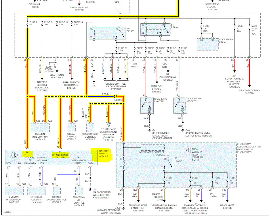

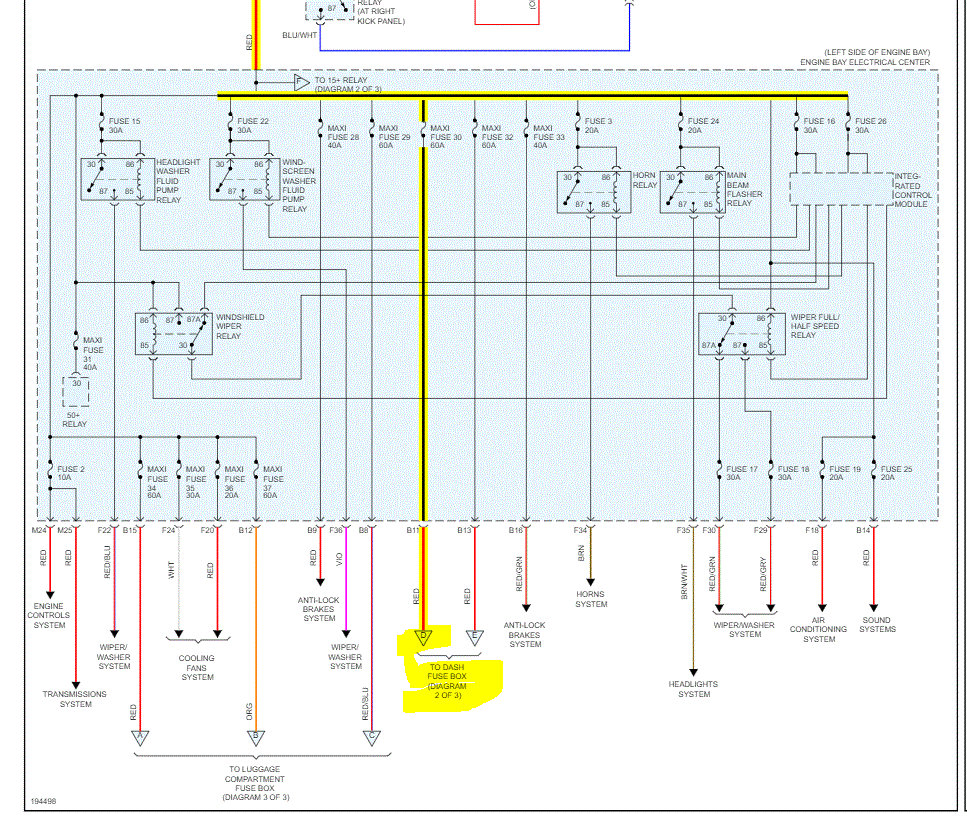

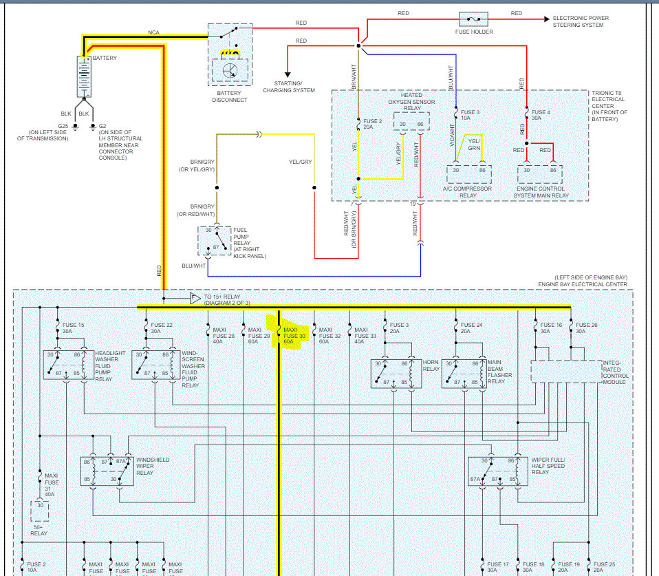

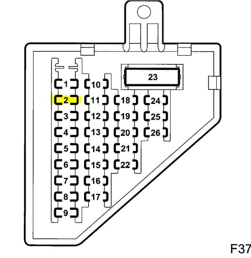

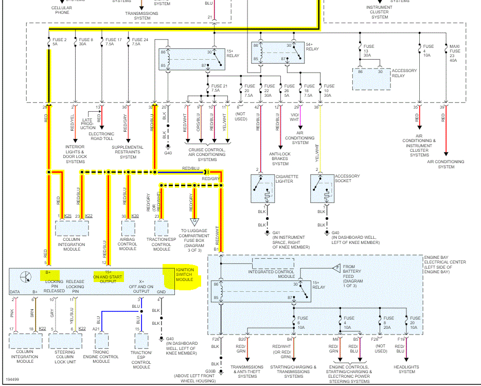

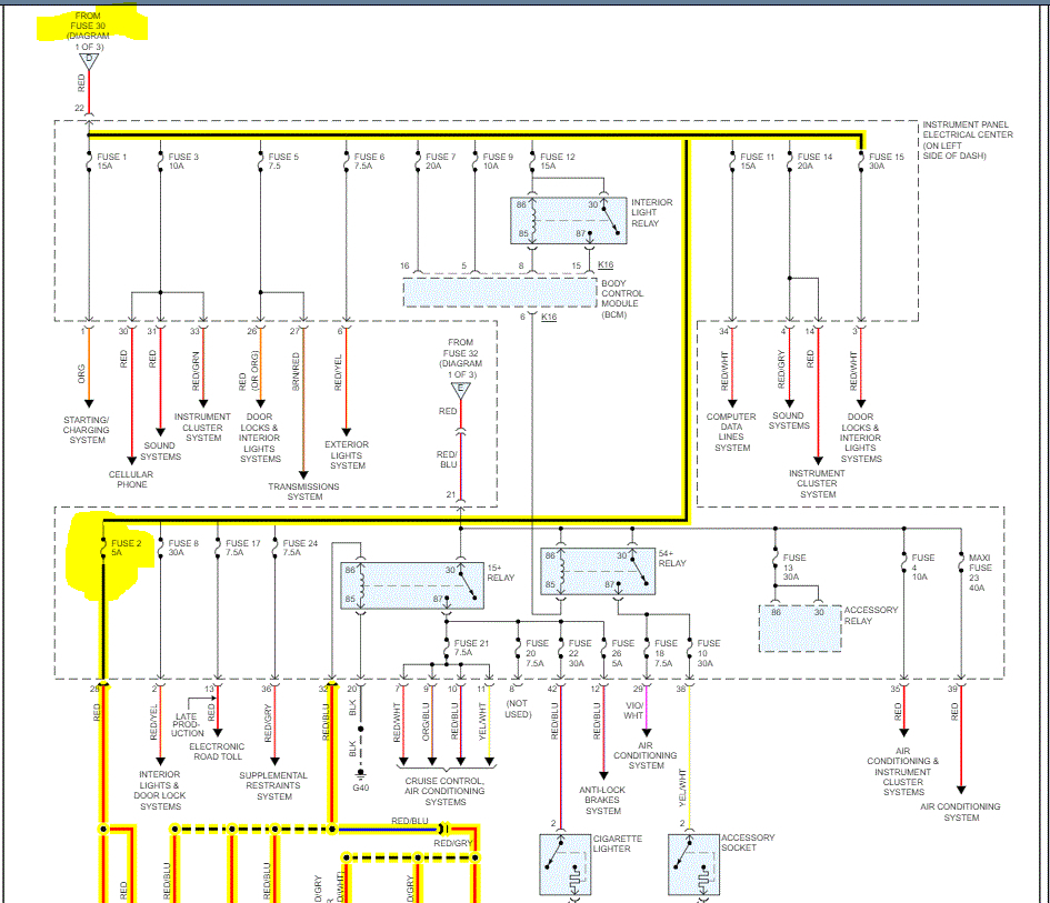

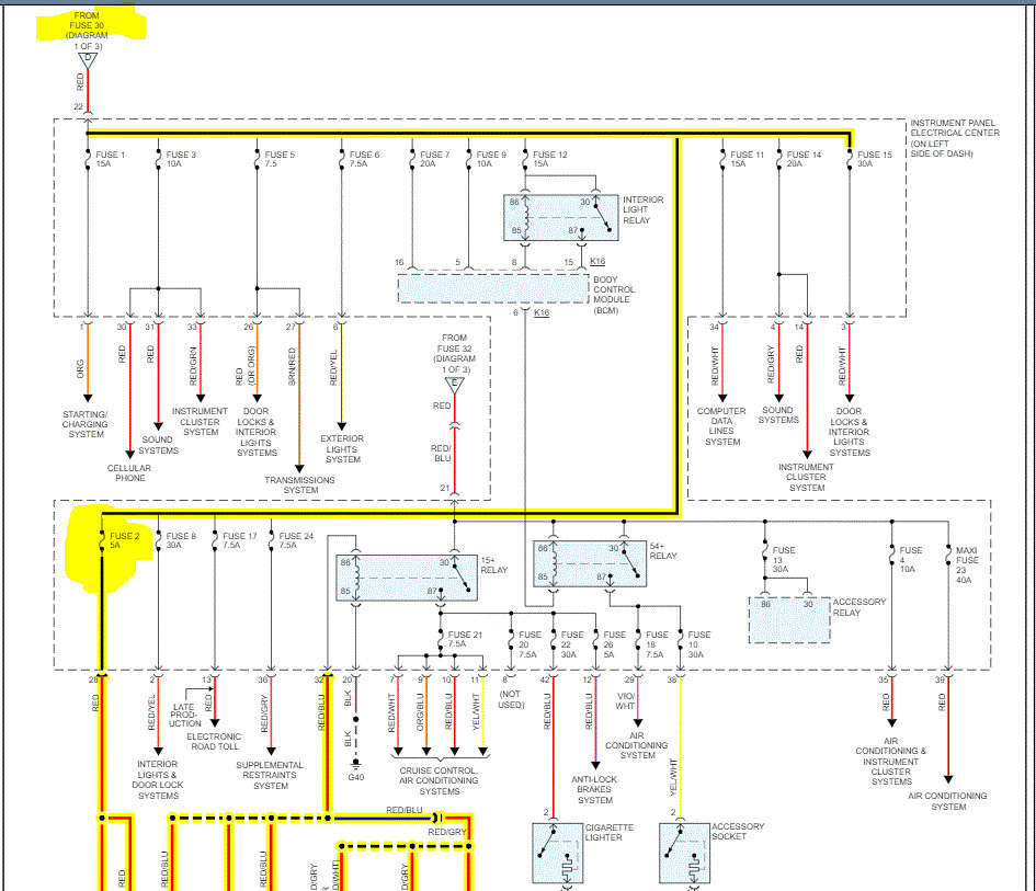

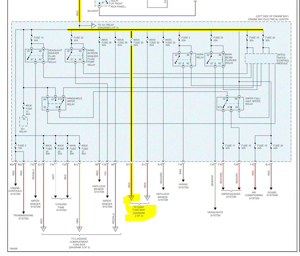

We need to work backward to see where power is lost. I attached a wiring schematic below, so you have a reference to my madness. LOL
Here is what I would suggest. First, in the instrument panel fuse box, check to make sure fuse 2 is good. In addition to checking the fuse, it is really important to know if there is power to it. Here is a link that explains how to test:
Even if the fuse appears good, please follow that link, and confirm power.

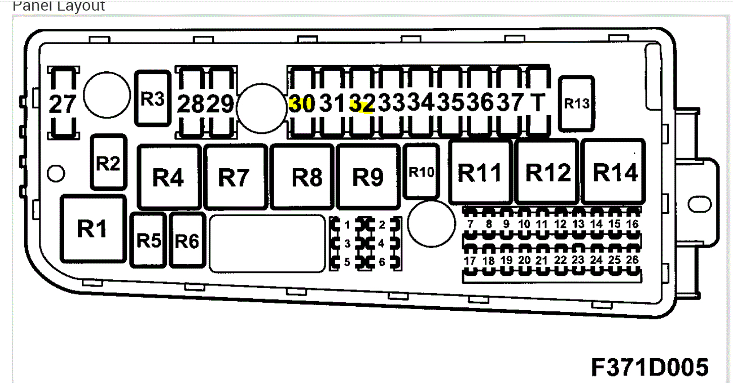

If there is no power, work backward to the fuse box under the hood. Check maxi fuses 30 and 32. Follow the same procedure as above.
Let me know what you find.

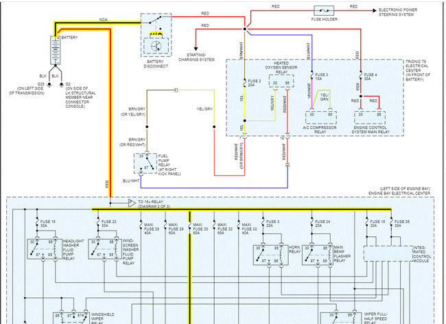

See pics below. Also, the last two pics show the fuse boxes and fuse locations. The schematics were cut in half to make them readable for you. I did overlap them so you can follow from one to the next.

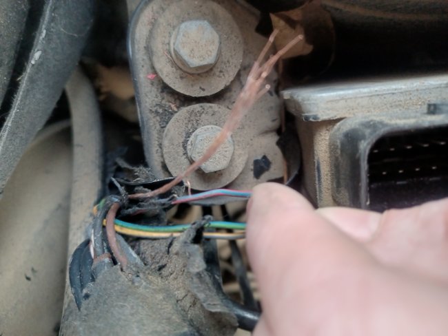

Hey:) so, I was wondering if you have a diagram of the fusible links for the Saab or if it was in the pictures, you sent, and I was not looking for it right. I really am feeling like that might be the issue as I have found 1 wire that appears to be melted a little bit.

I believe fuses 30 and 32 are the primary supply. Power to the under-hood fuse box comes directly from the battery. Have you been able to check them? They are identified in the last pic I attached above.

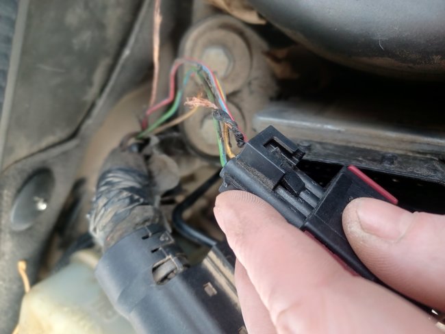

I did check them and that's when I found the melted wire. If I did it right again all fuses are good even the passenger compartment #2 that you said to check. I'm just not getting power to any fuses except the luggage compartment box. I don't remember if I mentioned before that the trunk release is an electronic button on drive door that can't open if the battery is drained, and I can open it and that's the only place that the light stays on and functions normally is in the trunk. I also have notice if I disconnect the battery and reconnect the Taillights come on for a short period up to 30 seconds or so and I have no control I can't turn them off or on the only lights I can control is the high beams. Also, I just learned that while my radio turns on with no power from the ignition it displays on the SID what station ect. But even with the locking mechanism bypassed on the ignition switch to turn freely without power, when turned to the on or start position there is still no SID, no system checks, no dinging, nothing. But the SID is perfectly fine to run the radio with display? and the somewhat melted looking wire i found is coming from only 1 wire of a 4-pin unit that is the harness/connector to the shut off switch relay on the positive battery cable and it is on the male side of connection. The car is not in front of me right this moment but if I remember correctly, it was a turquoise-ish color give or take more blue or green.

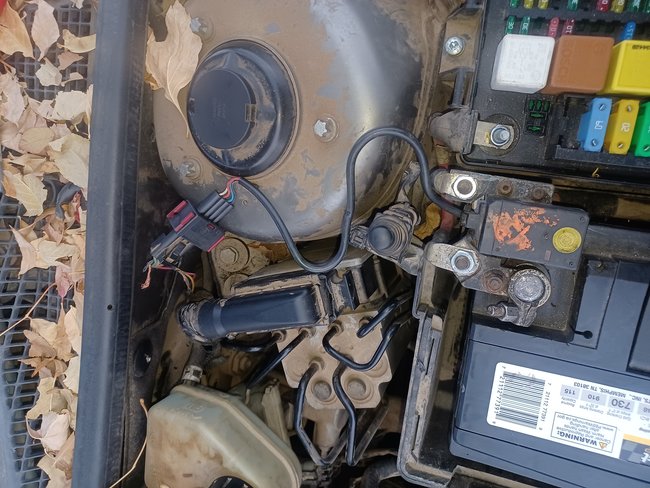

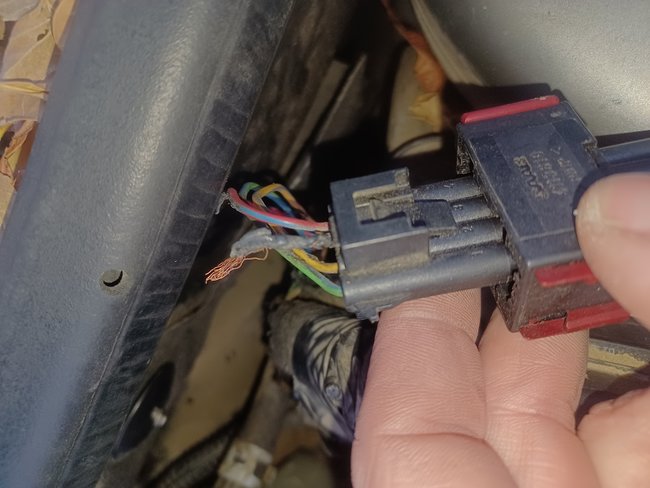

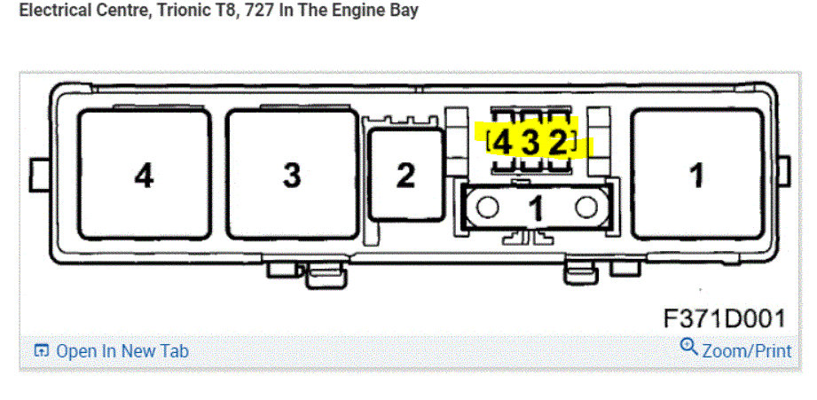

When you get a chance, get me a picture of the damaged wire. Also, in front of the battery box, locate the trionic fuse box. That box gets power after the disconnect. I believe that is where you see the melted wire.
There are three fuses there, 2, 3, and 4. Fuse 4 is my main concern, but I would like to know if they all are getting power.
I attached a pic of the box and the fuse locations. Let me know what you find.

I misplaced my test light, so I don't know yet if that fuse box is receiving power or not yet, but I did find that fuse #4 is a good fuse. Also, I was way off on the color of the wire it is actually black, which is left of the casing anyway. I peeled down the taping around the collection of wires it's grouped with, and it is the only wire that is visibly compromised/damaged. It looks like it burnt itself clean on most of what I can see anyway. And thank you for sharing your time and knowledge I really appreciate it!!!:)

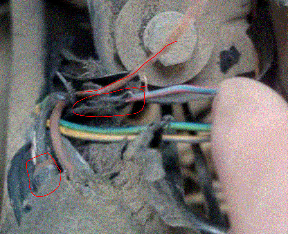

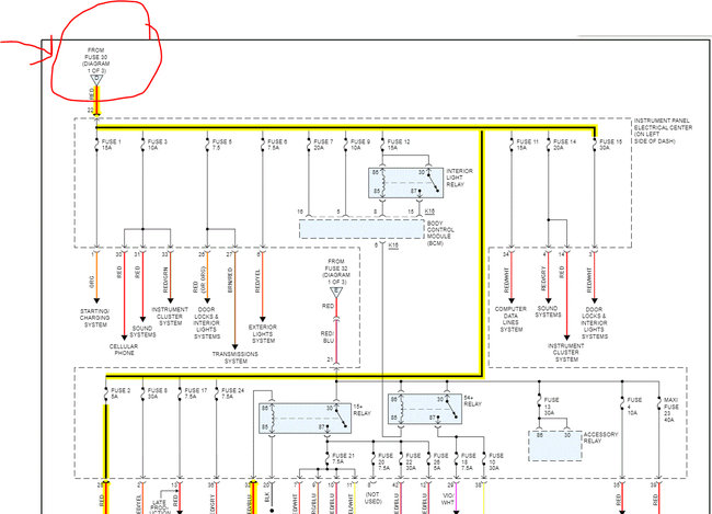

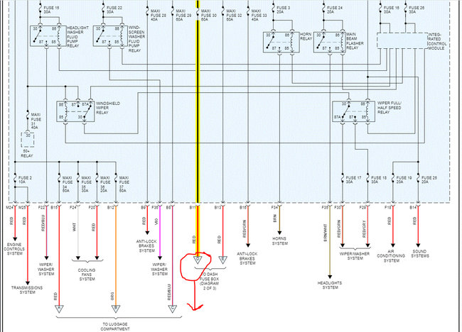

Wow! That is certainly a problem. I'm just wondering why a fuse didn't fail first. The black wire that is broken, does it have power from the battery side? Also. I copied one of your pics below and circled a couple of things. Are they bad as well?
Let me know. Also, let me know if you find the test light. I have a feeling you are going to find fuses that have no power to them. The only thing I can't confirm is what the black wire goes to. In the manual (schematic) it indicates NCA which means no color available. However, it does go to a red wire and then to the box.
My other concern is the idea that the wire is black. I went through both the power distribution schematics and ground schematics. Every wire in the ground schematic is black. LOL
They don't make it easy. However, check to see if the broken "black" wire is getting power from the battery.

Also, I can't find the picture you sent back and circled stuff in. It's usually right at the bottom of the message I just don't see it. :(
Mar 1, 2022 at 12:02 AM
  • 110,248 POSTS
I'm not sure why that pic didn't go through. I attached it again.

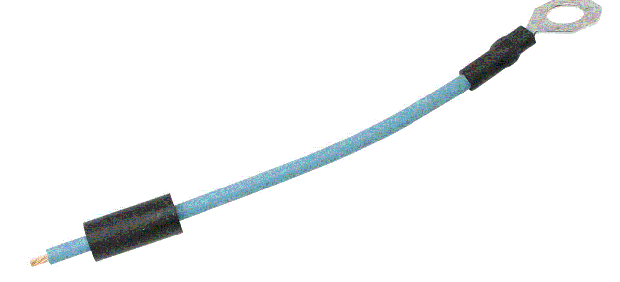

As far as a fusible link, it can look like a traditional wire. See pic 2 below. It is placed in line with a power supply and is designed (like a fuse) to fail if a specific amperage is drawn through it.

So, the top one you circled is the other side of that broken wire and I've found it is a ground. I made a new connection to the body of the car and now all my lights work as the should and I can even turn my headlights switch and if the Door is open it will ding until I put the key in and turn to any position it will stop. Also, my key fob works now to lock unlock the doors. I can also get the alarm to go off and it makes the honking sound, but my horn doesn't work. I can turn my hazards on and see the blinkers on the dash, but nothing happens when I try to start it there are no dash lights. I can again turn my radio on with no key in and it displays the station on the side but nothing when I try to start it no system check or anything. I did discover power is going to both sides of the relay on the disconnect switch, but nothing is coming out of the connecter itself power or ground. But what's even weirder is with the test light to my ignition connector I'm getting power to my power wire and my communication wire. Idk if it's getting a ground though because the test light doesn't reach from the battery to inside the car. Also, my cim connector reads its receiving power as well same as my ABS module. I also found that everything that's not working (ignition, steering lock etc.) Are all clustered together in the B harness under the battery. I'm sorry it took so long to reply I hope you're still able to help:)

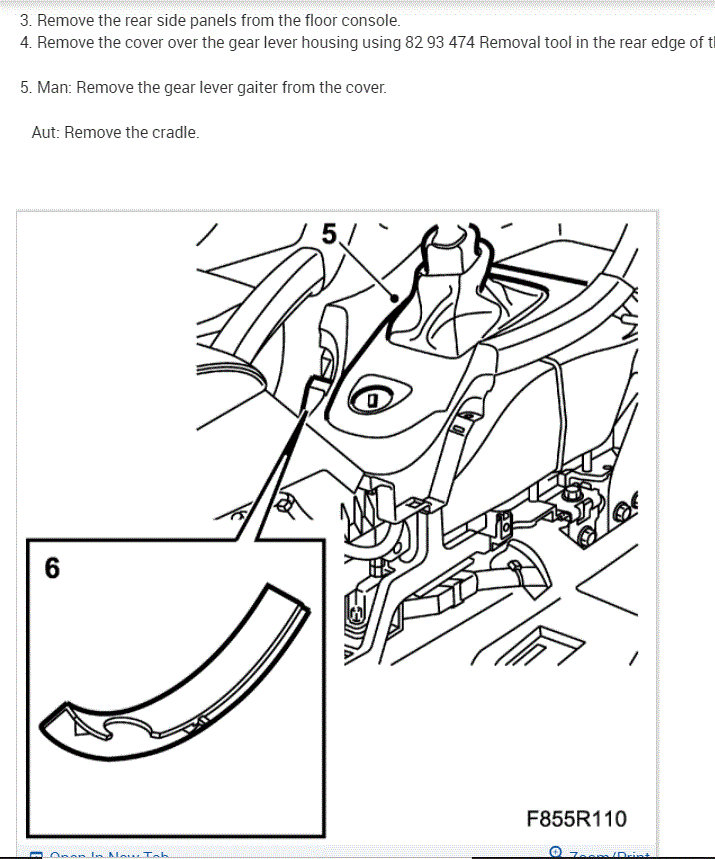

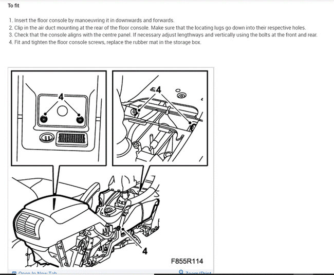

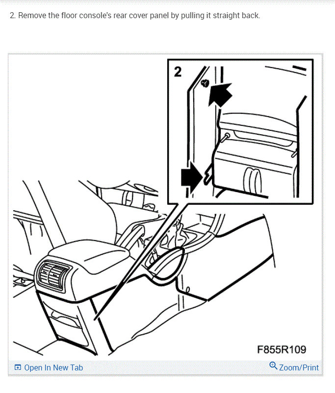

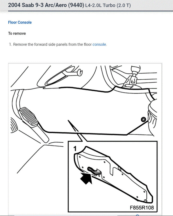

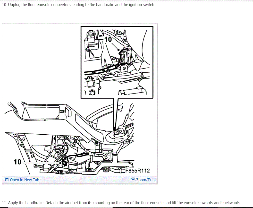

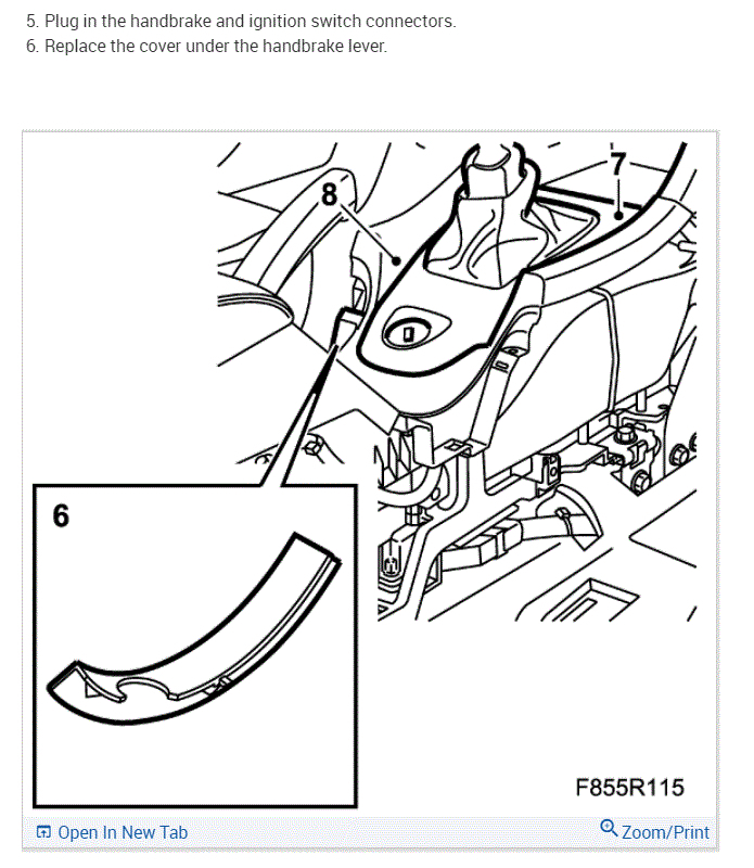

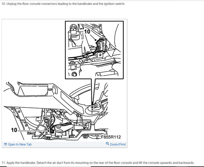

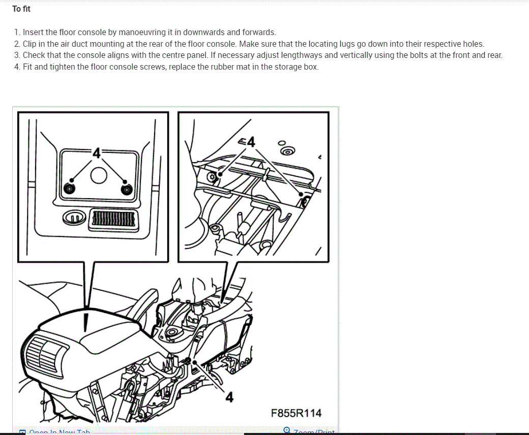

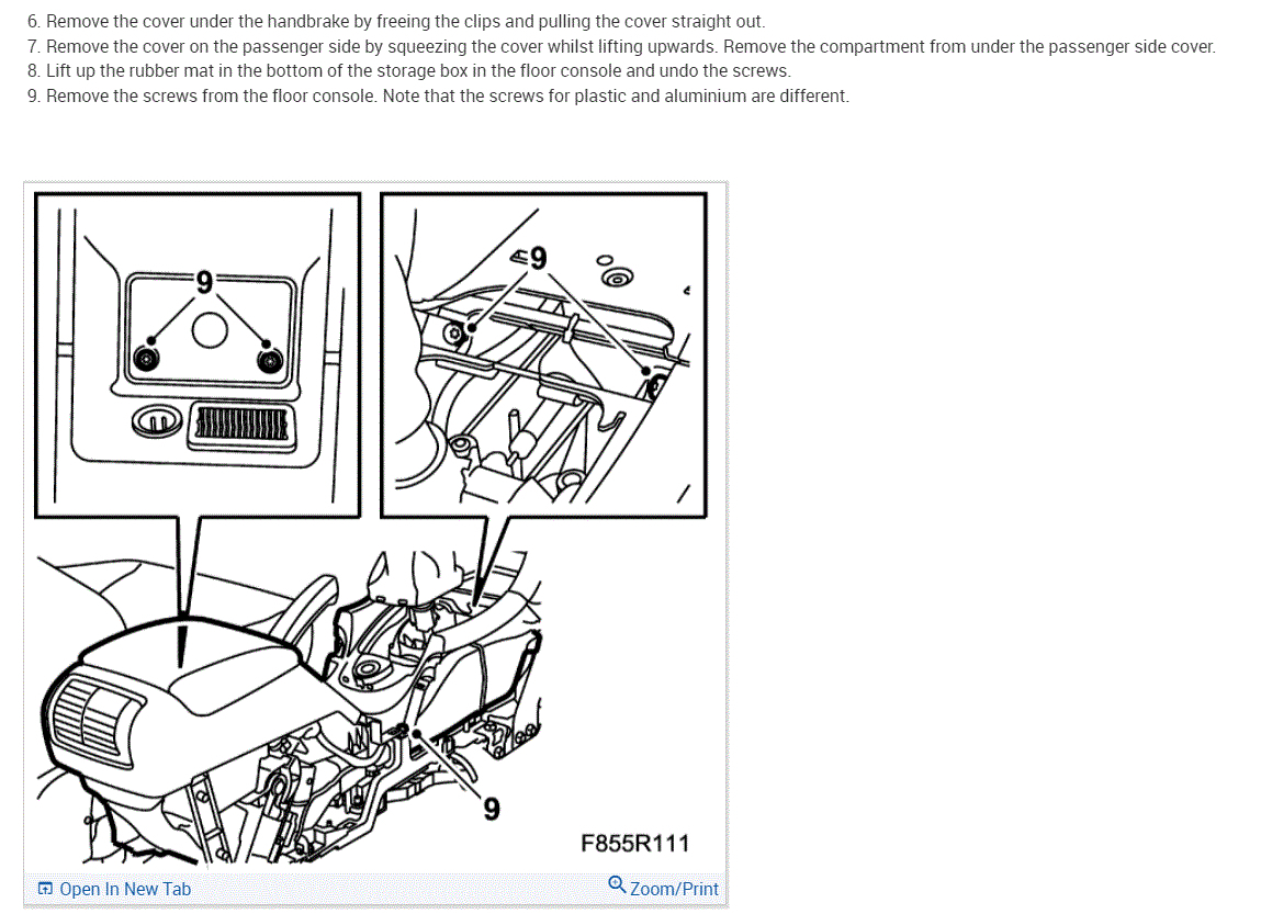

Will do. Do you have any tips to get the console out? :(
Mar 25, 2022 at 7:08 AM
  • 110,248 POSTS
LOL the :( made me laugh. I know it can be a pain. With that being said, I suspect you are referring to the center console.
I attached the directions below for you. Let me know if they help.
One other thought, if you ever experience issues with the heater/AC blower motor acting odd (turning on and off), replace the connector to the motor. They are known to fail and can cause a fire.

  • 110,248 POSTS

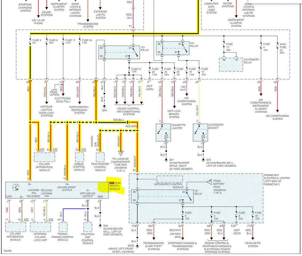

This is a tough one. Based on what you have already done, I suspect there are no power issues related to the switch. However, I feel that is where we need to start. When you turn the key to the start position and nothing turns on, that sounds like a power supply is missing.
Take a look at the schematic below. I highlighted the power supply from the battery to the switch. I need you to confirm all power supplies are good, fuses are good, and there is power to all fuses to the switch. (Red wire).
