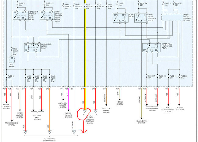

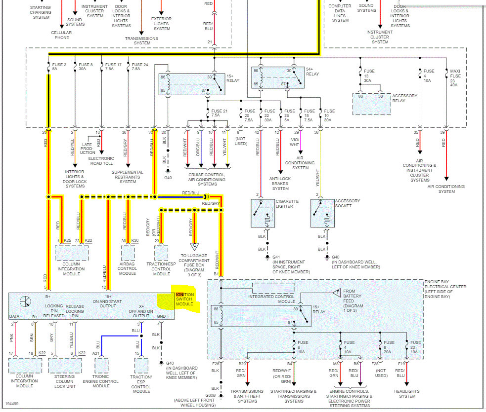

This is a tough one. Based on what you have already done, I suspect there are no power issues related to the switch. However, I feel that is where we need to start. When you turn the key to the start position and nothing turns on, that sounds like a power supply is missing.

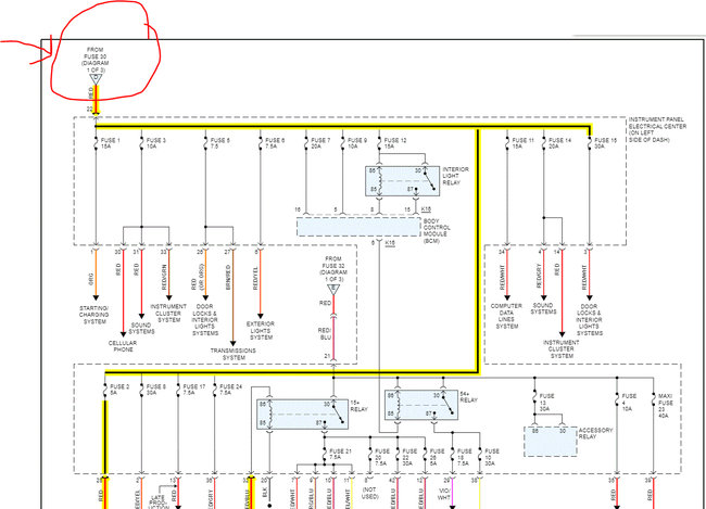

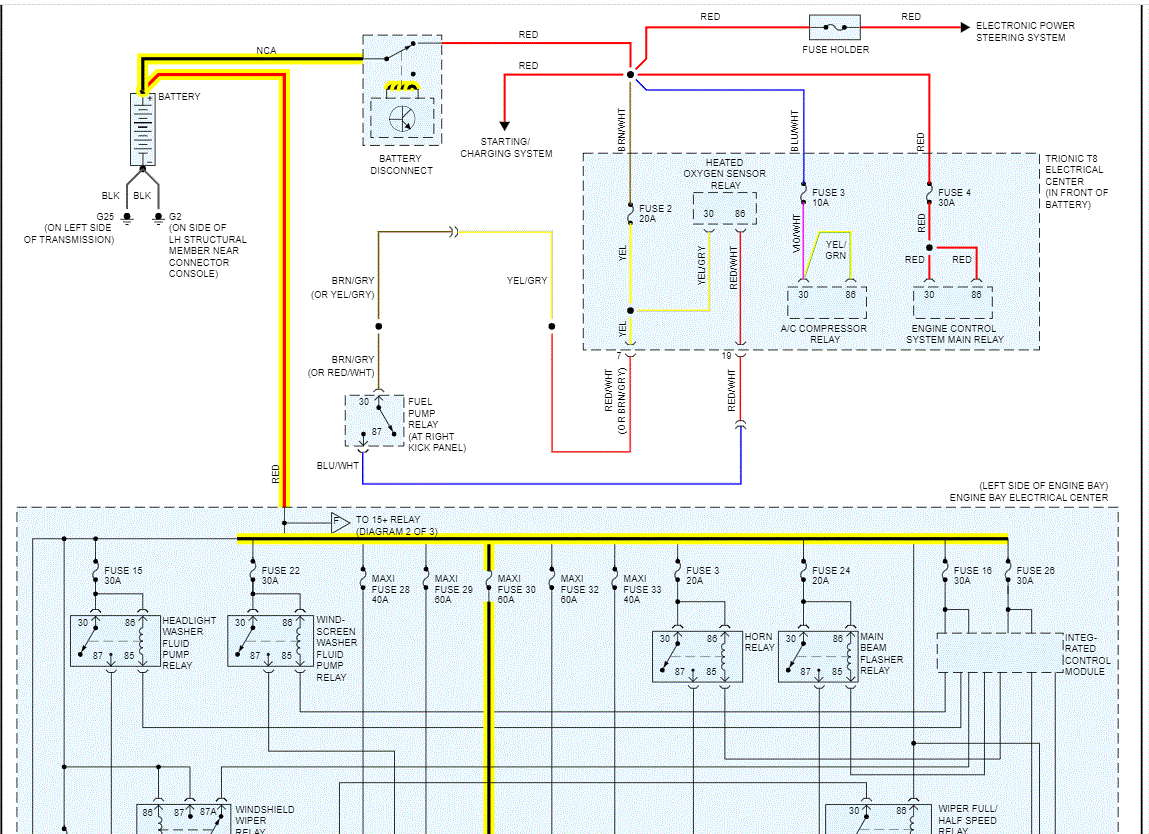

Take a look at the schematic below. I highlighted the power supply from the battery to the switch. I need you to confirm all power supplies are good, fuses are good, and there is power to all fuses to the switch. (Red wire).
