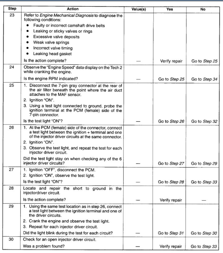

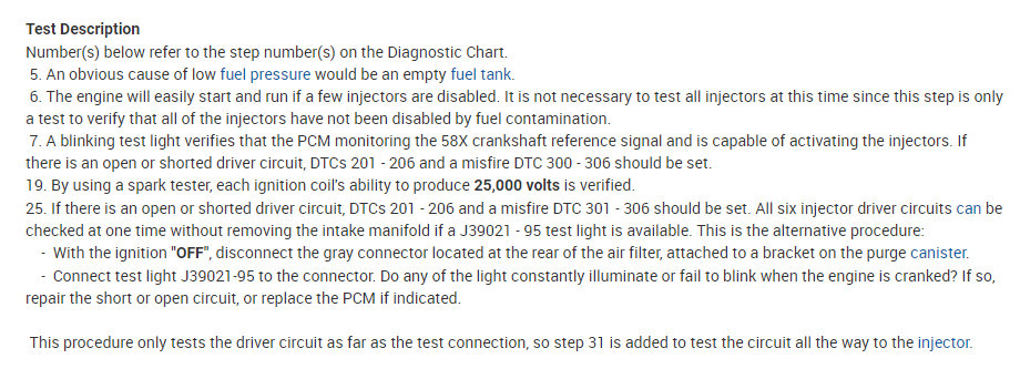

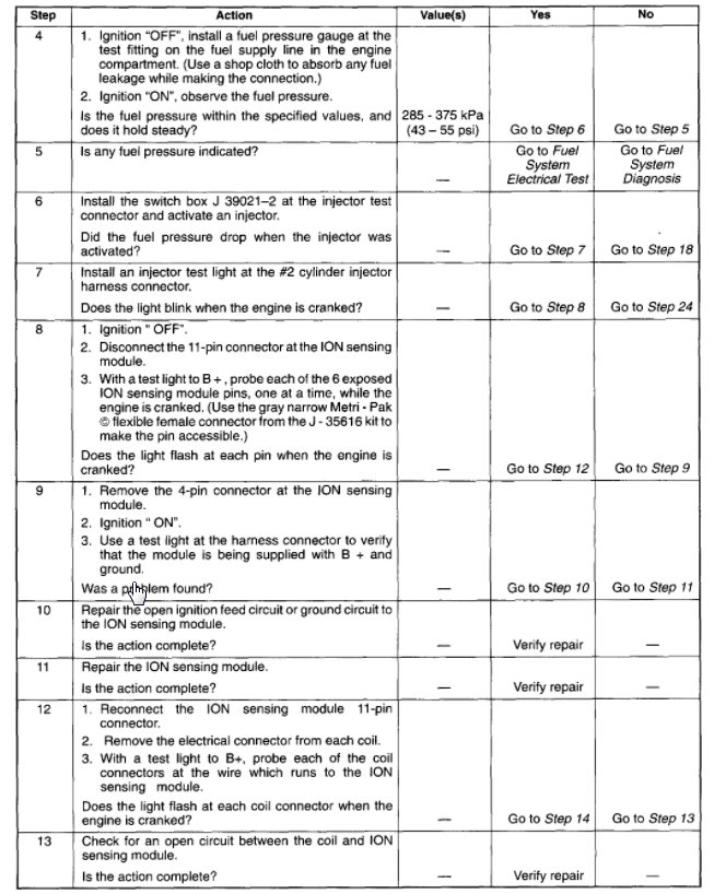

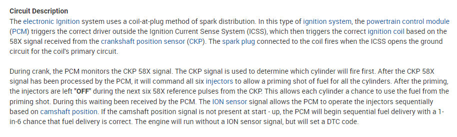

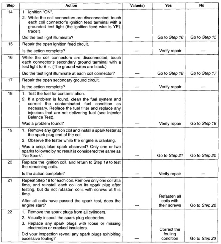

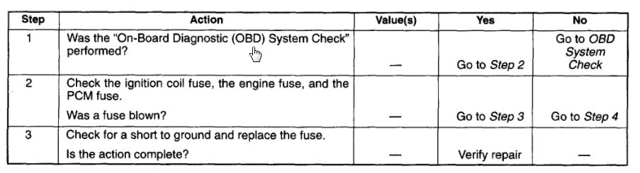

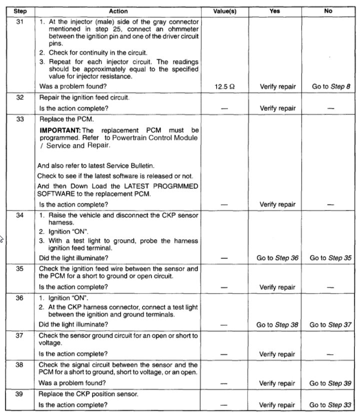

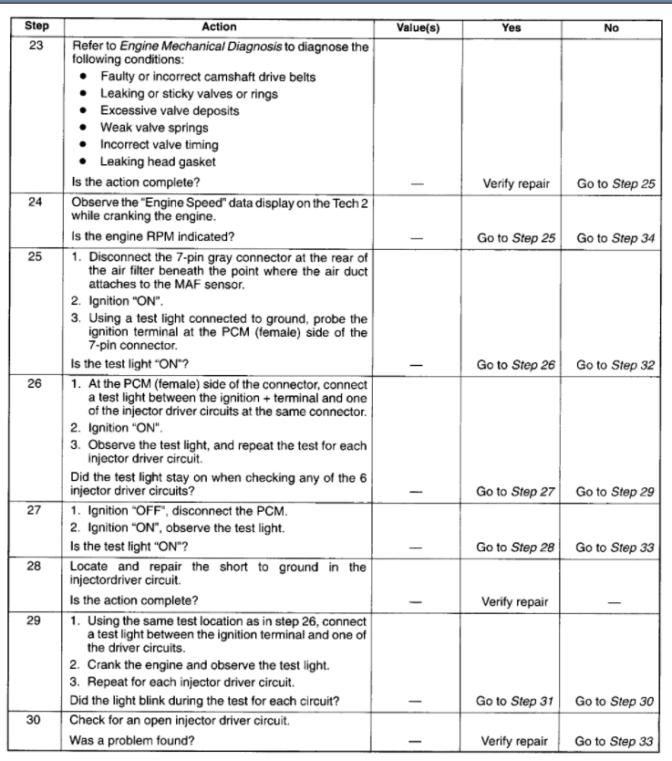

If this started after the head was off then we may just have it out of time which would explain why it is backfiring and not running. Let's check the compression on these cylinders and that will confirm it.
I also attached the info below on the basic testing that we need to go through from the manual on these codes and the engine does not start. However, i would suggest starting with the compression and going from there.
Let me know what questions you have. Thanks
