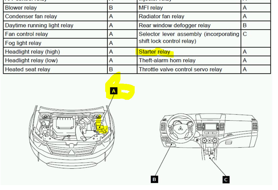

The starter has been replaced and the battery is new, yet when the key is turned it just clicks one simple click. Lights and everything else work fine.what else should I do?

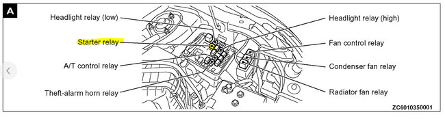

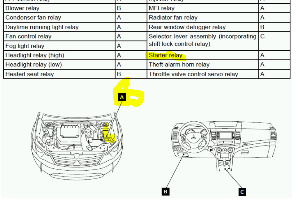

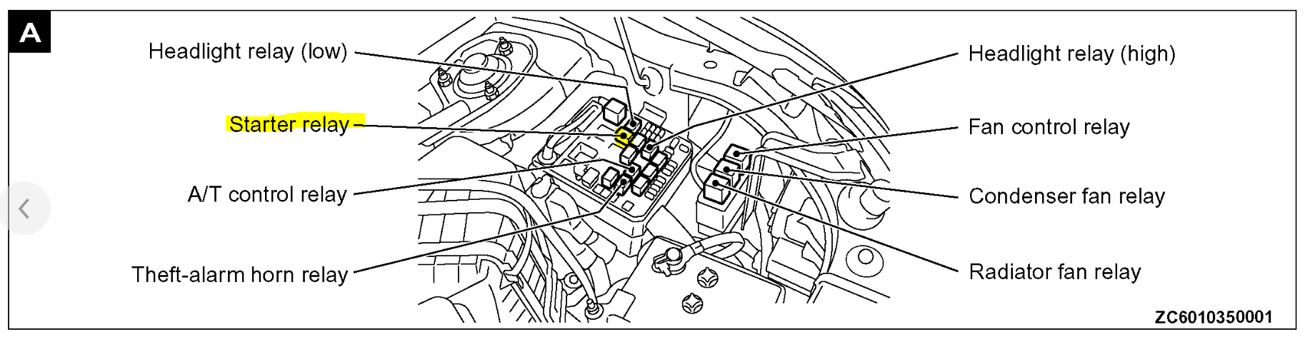

If there is no power to the S terminal, then check if the starter relay is bad. I attached two pics below to help you locate it.
