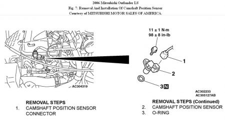

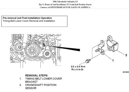

Here are the location of the sensors. I have sent the diagnostic files to your email as they are too large to be printed here. Let me know if they arrive safely.

Okay, so obviously I have done something wrong here as I have replaced the camshaft position sensor and the car still will not start.
What I know is, I have followed the cam position sensor diagnostic that you sent me and I have now replaced the sensor itself.
I have battery positive voltage at terminal three. (Harness side)
I have five volts at terminal two with key on. (harness side)
I have continuity of less than two ohms at terminal one. (Harness side)
I guess I am now moving on to the crankshaft sensor.. Any more advice would be much appreciated.

Also, I removed the timing belt case since my last post and took the crankshaft sensor off.
My timing belt has teeth missing all around the crankshaft pulley. Is this typical of when a sensor goes out?

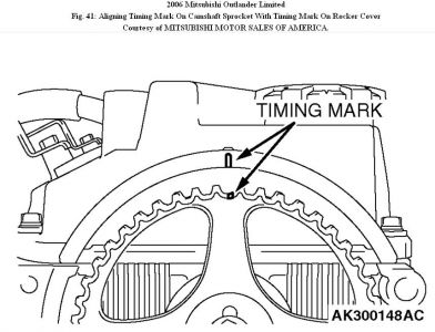

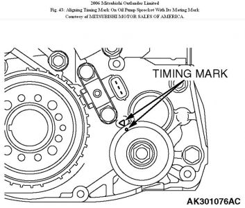

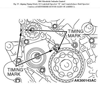

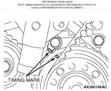

You should have come back here if you require additional assistance. Check if the following diagrams are helpful.
https://images.2carpros.com/forum/automotive_pictures/192750_TimingBelt06OutlanderFig29_1.jpg
https://images.2carpros.com/forum/automotive_pictures/192750_TimingBelt06OutlanderFig41_1.jpg
https://images.2carpros.com/forum/automotive_pictures/192750_TimingBelt06OutlanderFig42_1.jpg
https://images.2carpros.com/forum/automotive_pictures/192750_TimingBelt06OutlanderFig43_1.jpg
If the timing had been installed incorrectly, it can cause the cam sensor to show an error too. Did you check the valve clearances? That is to ensure the valves had not been damaged due to the timing belt failing. Intake is 0.11 mm ( 0.004 in) Exhaust is 0.20 mm ( 0.008 in)

This is the problem, in figure 42 (the crankshaft figure.) it says "aligning timing mark on crankshaft sprocket with timing mark on (?) case".
On my vehicle there is no mark on the sprocket itself except that half moon cutout that I reffered to earlier.
There is another hole drilled into the angle sensing blade that is behind the cranckshaft sprocket but no other marks to go by.
I finally got a Mitsubishi parts guy to tell me that the half circle shaped mark in the sprocket would be the right mark but it was very clear that he did not really know for sure.
Jul 16, 2010 at 1:58 AM
KHLOW2008
  • 41,814 POSTS
The half moon cut is the correct mark for the crankshaft. To reconfirm, you can use the timing mark on the pulley and the timing cover to verify.

I hope. so about the half moon thing.
One thing that worried me about using that mark is the fact that after I put it all back together and put the timing case back on, I noticed a couple of things.
1. The timing case has a place where -10 to TDC is indicated but nothing that I could see on the pulley lines up with these marks.
2. The only type of marks on the pulley itself are three holes in a line on the edge of the pulley.
Now, when I used the half moon to align with the timing mark on the case, these three holes end up a few inches to the right of the TDC indicator on the timing case.
Why do you think would that be?
Chris
Jul 16, 2010 at 2:48 AM
KHLOW2008
  • 41,814 POSTS
The three holes are driled out for balancing and are not the timing mark.
There should be a cut mark on the pulley to match the cover markings as it is for checking the ignition timing.
If there is any cut marks and it is not aligning with the cover marks, the harmonic balancer is bad and the outer ring has moved away from the original position.

It appears now that it is a timing issue.
I found a mark on the back of the crankshaft pulley by running my finger around the rim slowly. It is such a tiny cut that this is the only way to find it.
I tore everything back apart and found that the correct timing mark is not the half moon mark on the crankshaft sprocket at all, it is the hole that is drilled into the angle sensing plate behind the crankshaft sprocket.
When I lined all the timing marks up this time, using the hole that is drilled through the angle sensing plate, the little notch on the back of the crankshaft pulley is right on the TDC mark that is molded into the bottom timing case.
Now, this time when I tried to start the vehicle, it actually tried to start a little. I heard two kinda loud pops (kind of like it was back firing on the old vehicles) but the engine would still not start.
I have been told that this sounds like it is 180 degrees out of time and that I need to be sure that the right piston is at TDC and then allign all the marks. Does this soud correct to you?
