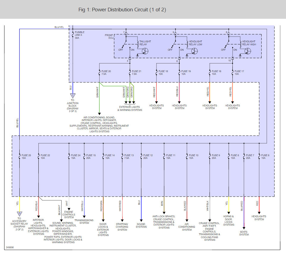

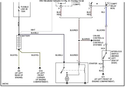

This problem started several months ago and has worsened recently.
When I go to start the car, and turn the key, you can hear a clicking of the relay, but the car will not start (no attempt to crank at all). Repeated tries to start, usually result in the car starting right up (some times the 2nd try, some times after the 15th!)
For a month or so, I discovered that if I wiggled the key just so, it would fire up first try, every time. But then it went back to not starting. Usually I have to try turning the key several times before it will start. It seems worse after the car has been parked for a short amount of time (doesn’t want to start at gas stations). If parked overnight, it seems to start on the first try more often.
Sometimes I just can not get it to start with a turn of the key, and have to result to push starting. It ALAWAYS starts when push started.
Any suggestions? Battery is new, otherwise car is due for tune up.
Nov 4, 2010 at 6:04 AM
KHLOW2008
  • 41,814 POSTS

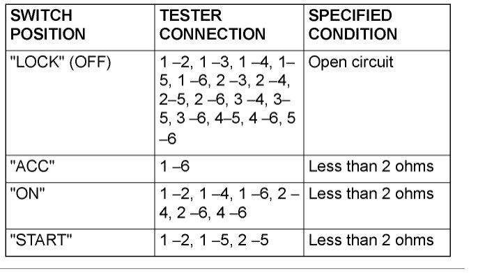

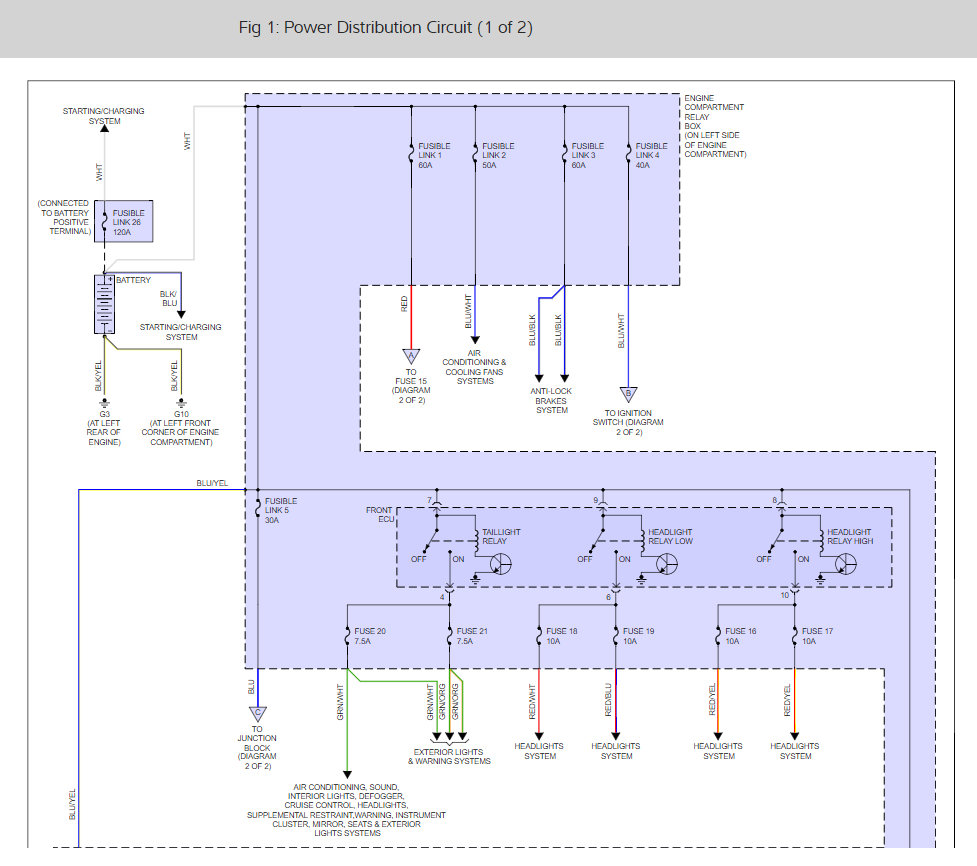

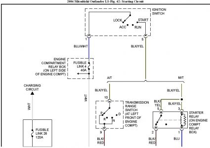

Hi appsolute, The fault lies in the starting circuit and possible causes are : 1. Faulty ignition switch. When starter does not crank, test the Blacl/Yellow wire from ignition switch for battery voltage with ignition turned to START positioon. If battery voltage is not available, the ignition switch is faulty. 2. Faulty clutch interlock switch. Disconnect the clutch interlock switch connector and bridge the teminals. If starter cranks, test the switch for continuity with pedal depressed. If continuity is not available, switch is faulty. 3. Starter. Disconnect the starter solenoid wire and use a remote wire to apply battery voltage. Test it a few ttimes and if starter cranks each time, it is good. You can test the ignition switch and starter from the starter relay. Unplug the relay and attach a tst lamp to terminal 3 or 5. When ignition is turned on, the test lamp should light up if the ignition switch is good. If applying battery voltage to terminal # 2 cranks the starter, the starter is good. Note: Sometimes the voltage from ignition switch might be lower than expected due to wiring or poor ignition switch contacts and under this condition, power supply test works but the voltage is insufficient to crank the starter. 4. Loose wire connectors. Check the connectors between the ignition switch and fuse box for signs of overheating at connectors. 5. Faulty Starter relay. Try swapping the relay with the headlight relays to see if it works. This guide cn help https://www.2carpros.com/articles/car-cranks-but-wont-start
https://images.2carpros.com/forum/automotive_pictures/192750_StartingCircuit06OutlanderFig42a_1.jpg
https://images.2carpros.com/forum/automotive_pictures/192750_StartingCircuit06OutlanderFig42b_1.jpg
Here is a guide and diagrams so you can confirm the problem https://www.2carpros.com/articles/how-to-use-a-test-light-circuit-tester Larger diagrams (below) Please let us know what happens. Cheers,

This is very helpful. I had a feeling it could also be related to the clutch.
I am going to do your suggested tests this week, and I will be back if I do not find the solution.

Hello, I had exactly the same problem as described in my 2005 outlander . Took it to an auto elect and he found the ignition switch to be faulty. replaced it for $200 ($100 for switch) and have had no problems since : )

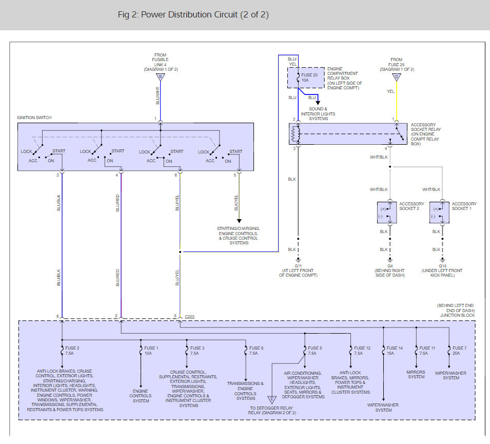

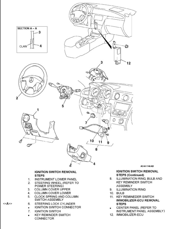

JOE DO
I had the same problem with my 2005 outlander not cranking every time it was the ignition switch which was $75 australian dollars and took 5 mins to do there are 4 screws to undo and a wire clip ...THEN being a tinkerer i opened the switch and had a dig around and noticed the starting pin was dirty and not getting a good connection so i cleaned it off and it was working well again so i spent $75 for nothing in the long run but now i have a spare JOE
Sep 25, 2017 at 1:54 PM
  • 55,423 POSTS
Great addition to this thread! :)

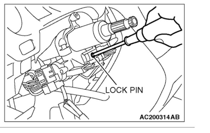

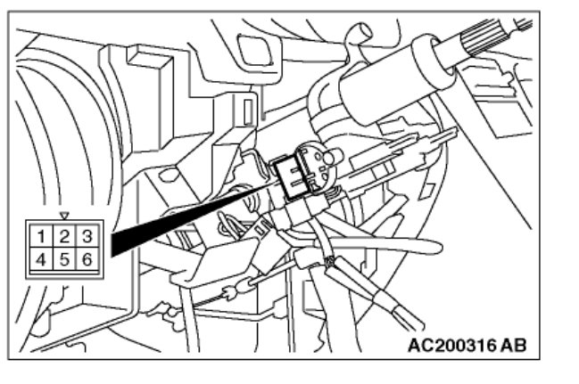

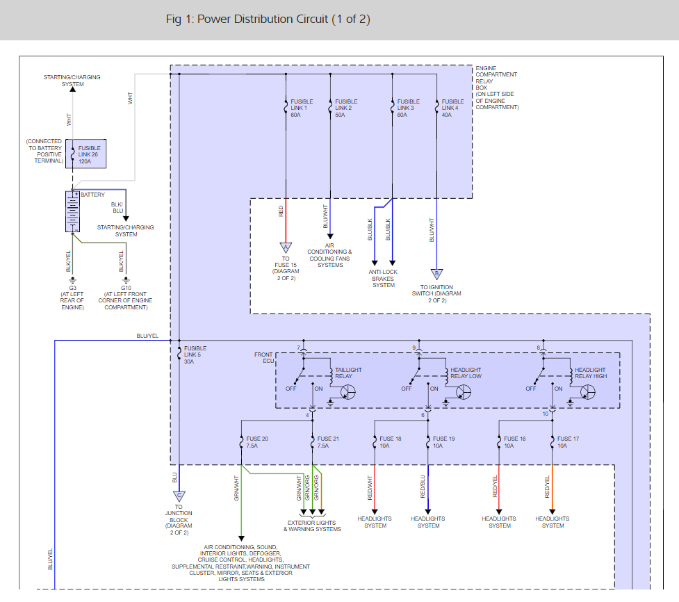

Here are some diagrams I found to help people that want to replace the ignition witch
Sep 26, 2017 at 6:31 AM

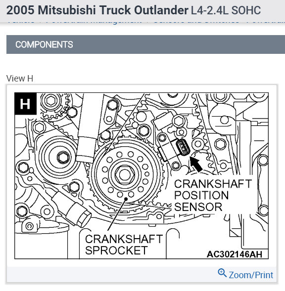

This sounds like you have crankshaft angle sensor that is not working which when they go out do not set a check engine light here is a guide to give you an idea of what you are in for when doing the job and diagrams below to show you car's location.
Cheers
Nov 1, 2019 at 3:05 AM (Merged)

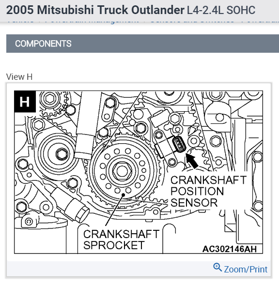

RAGAN175
2005 Outlander, Same issue, died all of sudden, now cranks but will not start. Tried to jump start eliminated battery & alternator as problem. Did spark test get no spark when crank key and have plug out against bolt head in fire wall, did with two plugs. So I followed this post and found the crankshaft sensor was not to bad to replace, it fixed the problem thank god! thanks to all who helped me I love this site.

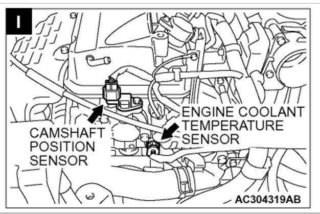

HANNIBALCAIN

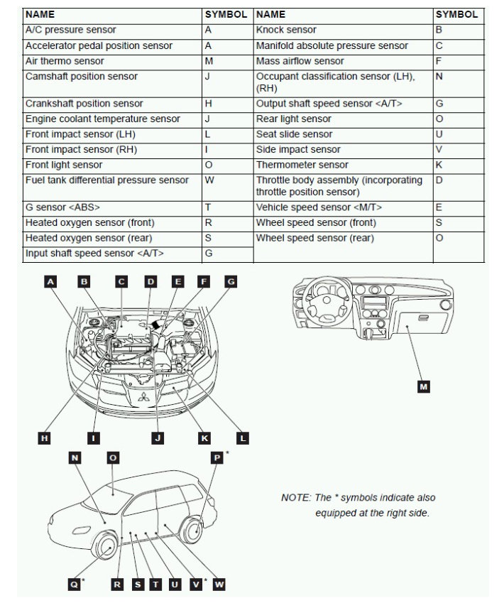

I ran into this problem on my son's 2003 Mitsubishi Outlander AWD 2.4L. It turned out to be the Camshaft Position Sensor. You can test it easily. The sensor is on the right side of the top of the engine, right above the end of the camshaft. 10mm bolt. When it is hot and won't start pull the Sensor out clean it and put it back in. If your car starts then it is the sensor. I got the import replacement at O'Reilley's for $59.99.
  • 55,423 POSTS
Here are some helpful guides and diagram (below) to get the problem fixed:
https://www.2carpros.com/articles/camshaft-angle-sensor-replacement

GINGERGRAYSHINN
computer readout said cam shaft sensor, changed that and changed spark plugs and wires still will not start
Nov 1, 2019 at 3:06 AM (Merged)
SATURNTECH9
  • 30,869 POSTS
What are the exact code numbers you have after replacing the sensor and clearing the codes?I need the exact code numbers not code descriptions?
GINGERGRAYSHINN
P0118 the other sensor has been replaced. Thanks
SATURNTECH9
  • 30,869 POSTS
Thats the code for coolant temp sensor high input check the connector going to the coolant tempo sensor.Do you have a scan tool that will read live engine data?Also do you have a multimeter?
