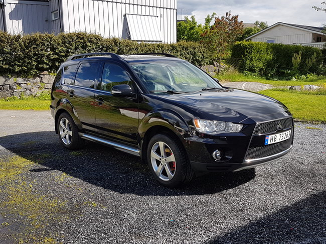

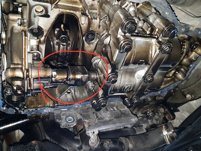

2.2 di-d mivec. Is this normal idle sound? Or is there something wrong with my engine

That sound like an internal engine problem, i would get it looked at by a mechanic ASAP i would go as far to say do not drive it as you may destroy the engine, this will have to be diagnoses first hand, but it does sound like a bearing issue with that deep metallic noise, one this you can try is to remove the external drive belt and run the engine, if the noise is still there it will be internal of the engine.

OLE IVAR HAGEN
  • 5 POSTS
Problem solved!
Turned out to be rattling in the joint in the shaft going to the balance assembly.
Jul 1, 2017 at 4:18 AM

GEGGY
Hi
Was this a hard job to do? Could you tell me how to do it?
Thanks
Jul 19, 2019 at 4:49 PM

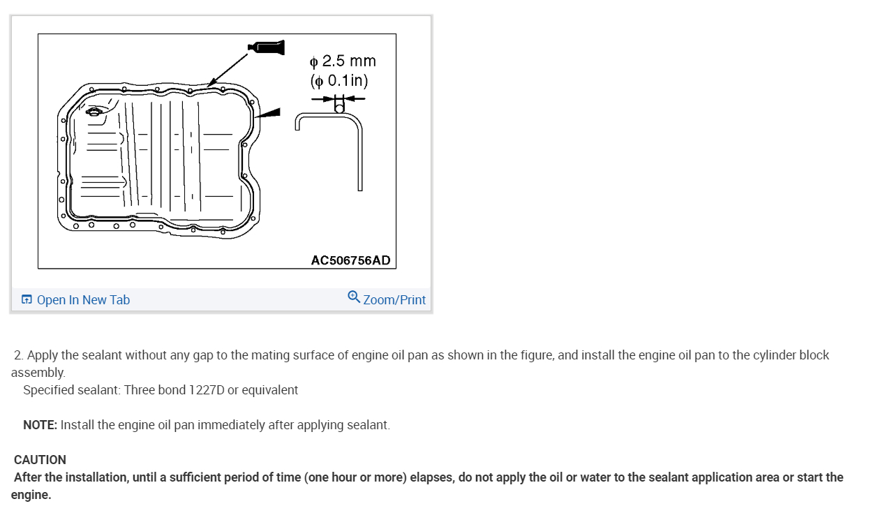

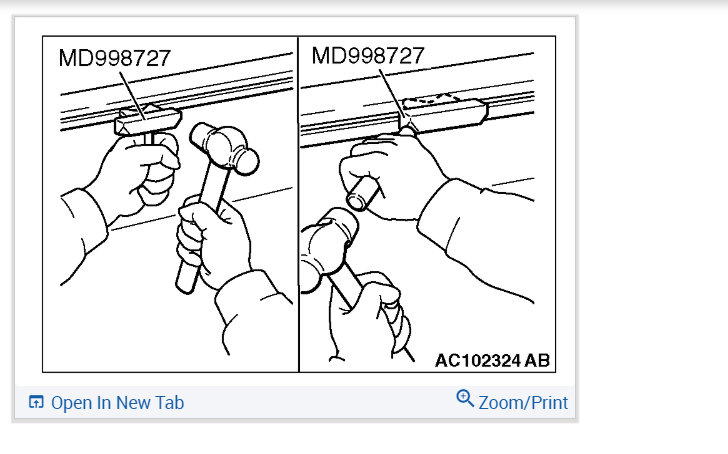

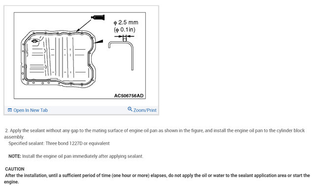

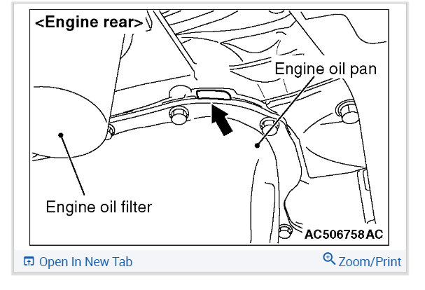

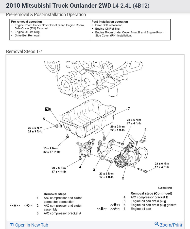

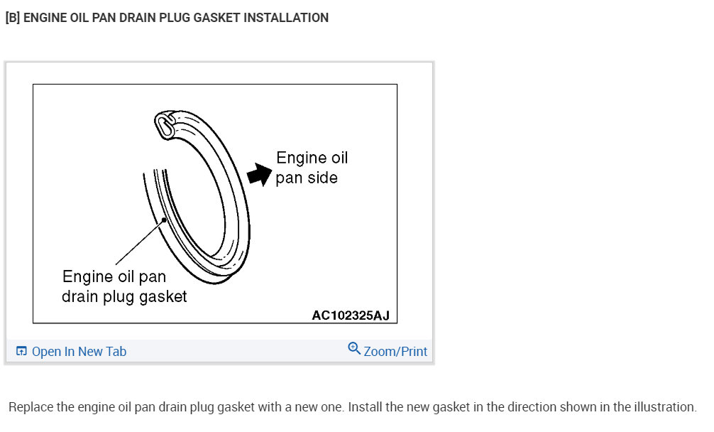

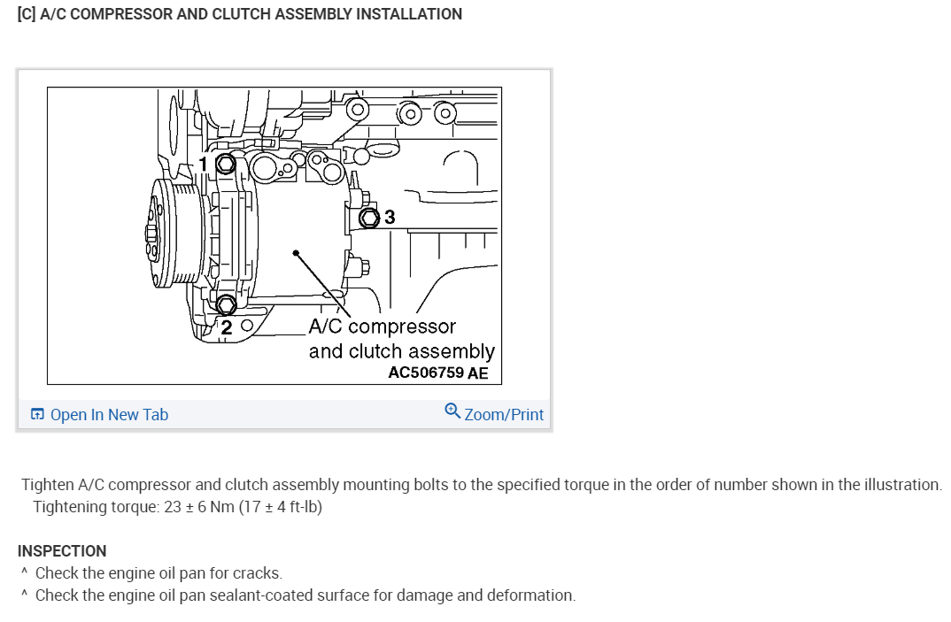

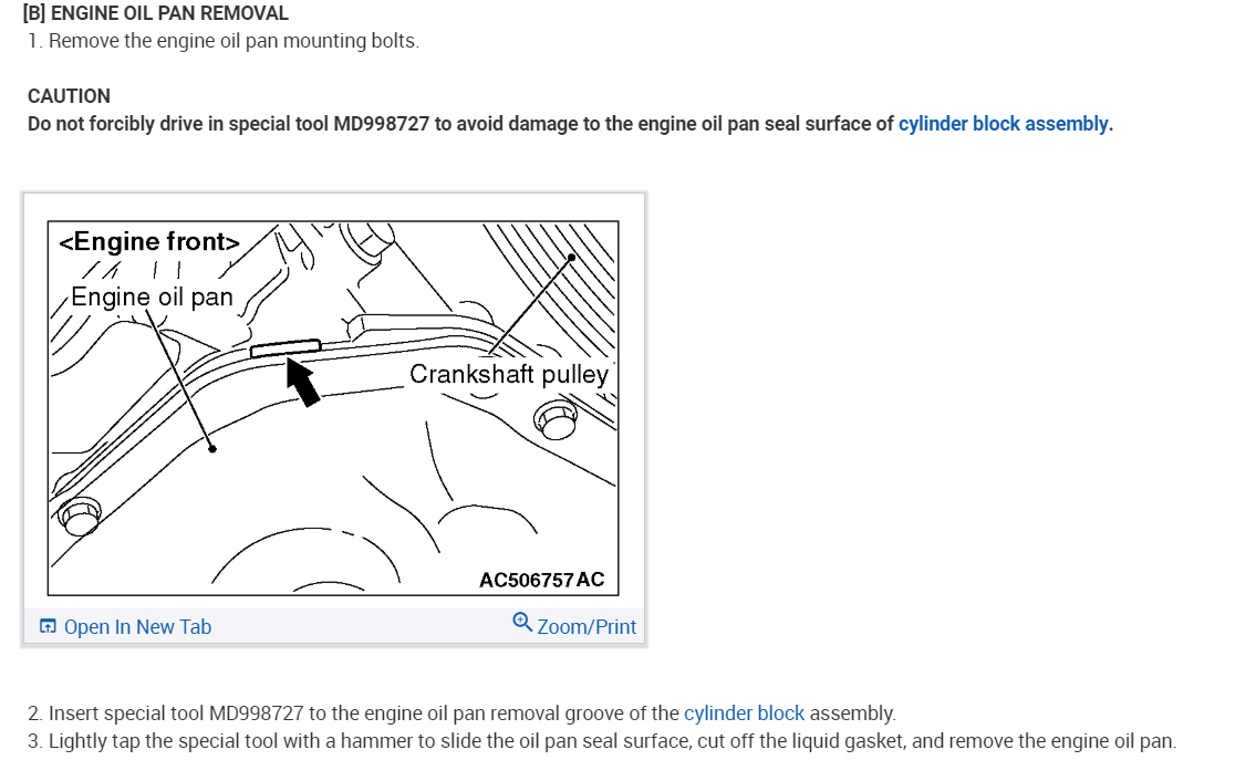

  • 55,381 POSTS
Its not too bad the oil pan must come off to do the job. Here are instructions/diagrams. Check out the diagrams (Below). Please let us know what happens.
Jul 20, 2019 at 3:56 AM
GEGGY
Thanks for reply
Do I need to buy the new part if so what part is it and is this only main agent part
Can the joint just be taken off and run with out
Thanks again
Jul 26, 2019 at 5:00 PM
  • 55,381 POSTS
You need to take it apart and see which parts are worn and making the noise. Please upload pictures/videos of any parts in question.
