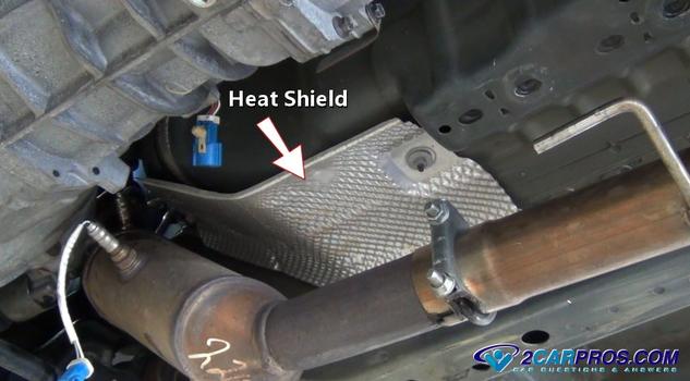

3. Loose Exhaust Heat Shield
The exhaust system in the car uses heat shields over the manifolds, catalytic converters and exhaust tubing to keep heat from penetrating the floor of the car and causing damage. These shields are made of thin metal and when they come loose or break they can make a rattling sound while the engine is running. Some of these shields are accessible from the engine compartment while other times you will need to jack up the car and get under it to check out the shields.
