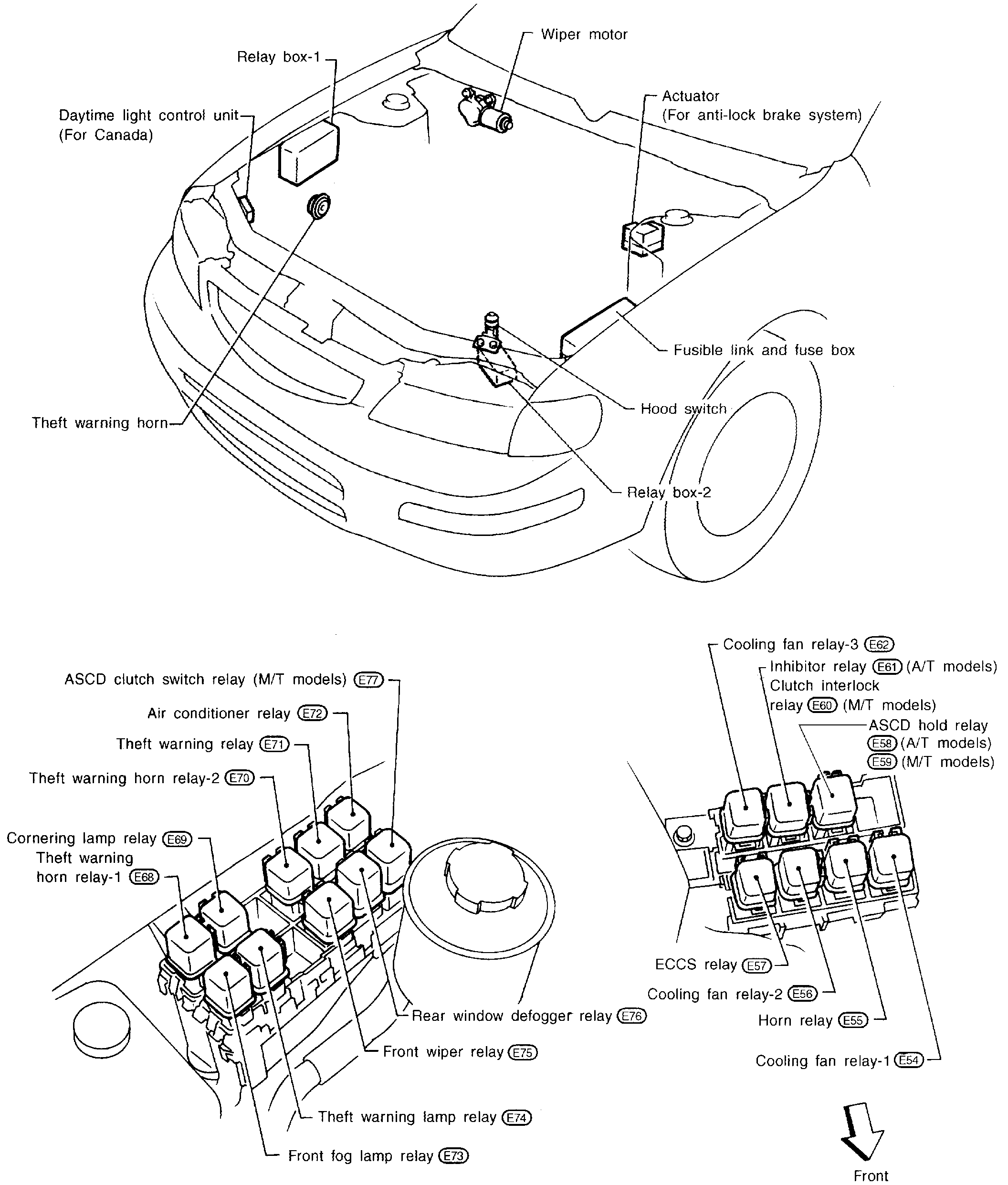

I bought this car from someone and I have never been able to drive it because of one reason or another. When I first bought it, it did not have a battery. So I bought one and I was able to start it but it was running real rough because it had been sitting for nearly a year and needed new gas in it. So we flushed the fuel system and changed the fuel filter, then the starter, then the fuel pump. Then I lost the keys to it and had to take the drivers side door lock cylinder to a locksmith and have a new key made. And the car still will not start. The dash panel lights up when I turn the key on and I can hear the starter clicking like it is coming on but when I turn the key the engine does not crank at all. What do I do?

Hi Amber.
If the battery is good, the first thing I would recommend checking is call the inhibitor relay. An inhibitor relay is for transferring power supply from main fuse box to starter solenoid. The engine gear shift must be in either park or neutral position. I attached a picture of the relay's location. There are two ways to check it. First, and easiest, is to switch the relay with a working one from the relay box that has the same part number. Or, you can actually check the relay itself. Here is a link that shows how:

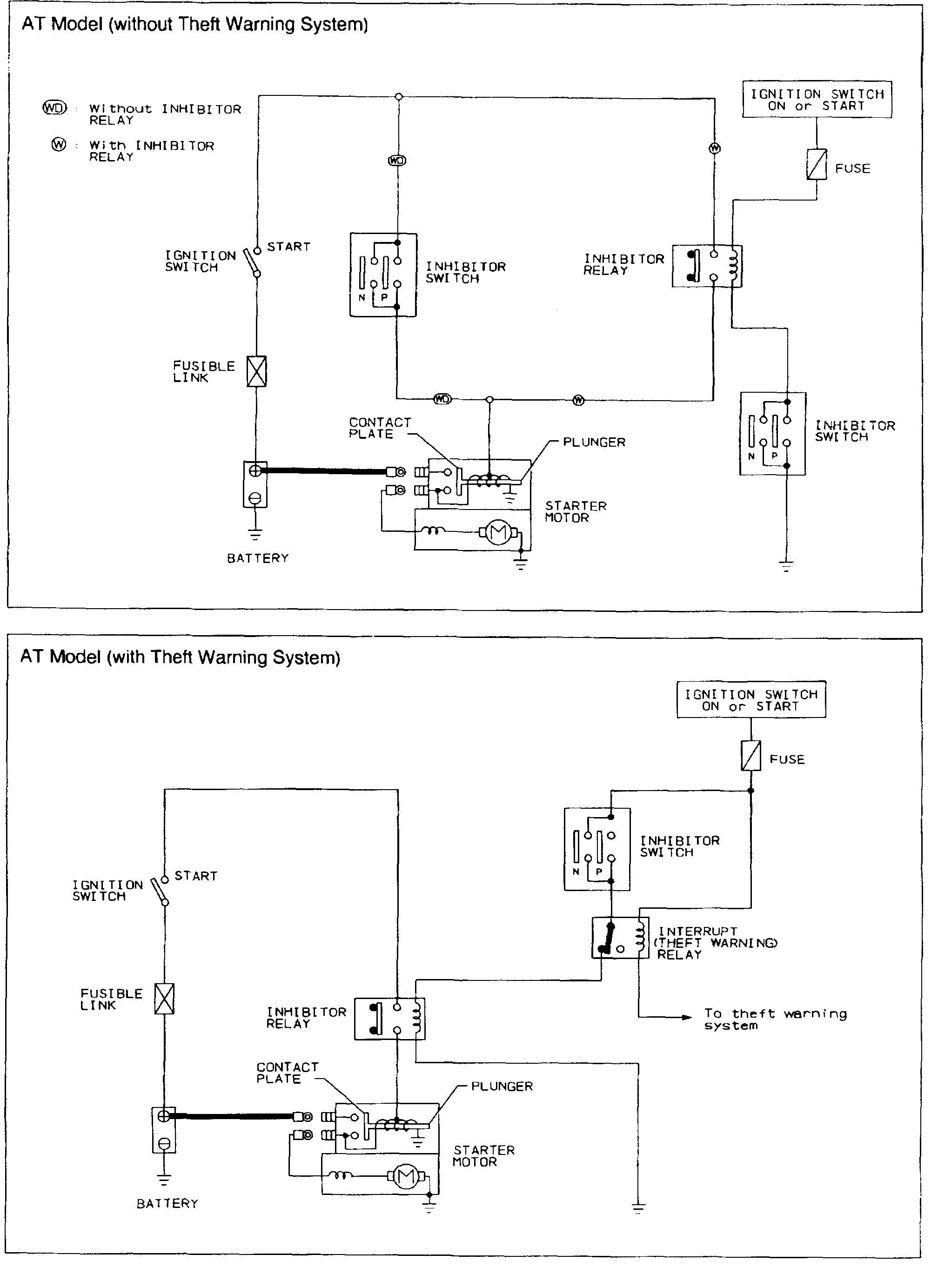

Also, keep in mind that the neutral safety switch, which only allows the engine to crank when the transmission is in park or neutral, can do the same thing. If you look at the second picture, you will find an inhibitor switch. That must also be working and indicating the vehicle is in park or neutral. Additionally, there is a what is called a fusible link between battery power and the ignition switch. This wire acts as a fuse. If that is burnt or damaged, again, the same thing will happen. Take a look at picture 2. It is the wiring schematic for this vehicle. Note where and how the power makes it to the starter solenoid.

Starter Motor Operation
When the ignition switch is in the START position, battery voltage is supplied to the starter motor through the ignition switch. The plunger in the motor is pulled to the left by a magnetic force as indicated in the following diagrams, then the contact plate of the plunger allows battery voltage to be applied to the motor directly, and the starter motor rotates.
When the engine is running and the ignition switch is returned to the ON position, the magnetic force required to pull the plunger in is removed and the plunger is returned to its resting position by the return spring in the starter motor. Battery voltage is no longer applied to the starter motor and the motor stops.
Starting System Operation
AT MODEL
^ Without Theft Warning System
With the inhibitor switch in PARK or NEUTRAL and the ignition switch in ON or START, battery voltage is ready to be applied to the starter motor through the inhibitor relay.
^ With Theft Warning System
With the inhibitor switch in PARK or NEUTRAL and the ignition switch in ON or START, without the interrupt relay (theft warning relay) activated, battery voltage is ready to be applied to the starter motor through the inhibitor relay.
MT MODEL
For USA
With the clutch interlock switch in ON (clutch pedal depressed), battery voltage is ready to be applied to the starter motor through the interlock relay.
With the clutch interlock switch in ON (clutch pedal depressed), without the interrupt relay (theft warning relay) activated, battery voltage is ready to be applied to the starter motor through the interlock relay.
Except for USA
With the ignition switch in START, battery voltage is directly applied to the starter motor.
Without the interrupt relay (theft warning relay) activated, battery voltage is ready to be applied to the starter motor through the interrupt relay (theft warning relay).

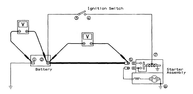

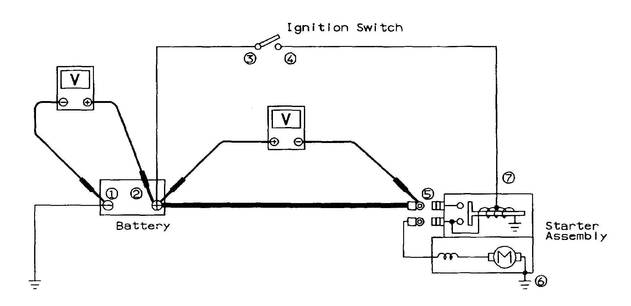

Checking Terminal Voltage
The following information contains techniques on how to perform a voltage drop test on a starter circuit. Performing a voltage drop test can aid the technician in locating and correcting starter circuit problems.
NOTE: To prevent the engine from starting during testing, remove the fuel pump fuse and bleed-off the fuel pressure from the fuel system.
Before performing the following test, visually inspect the starter, battery, cables and any other related components to ensure that the problem lies beyond a simple visual inspection.

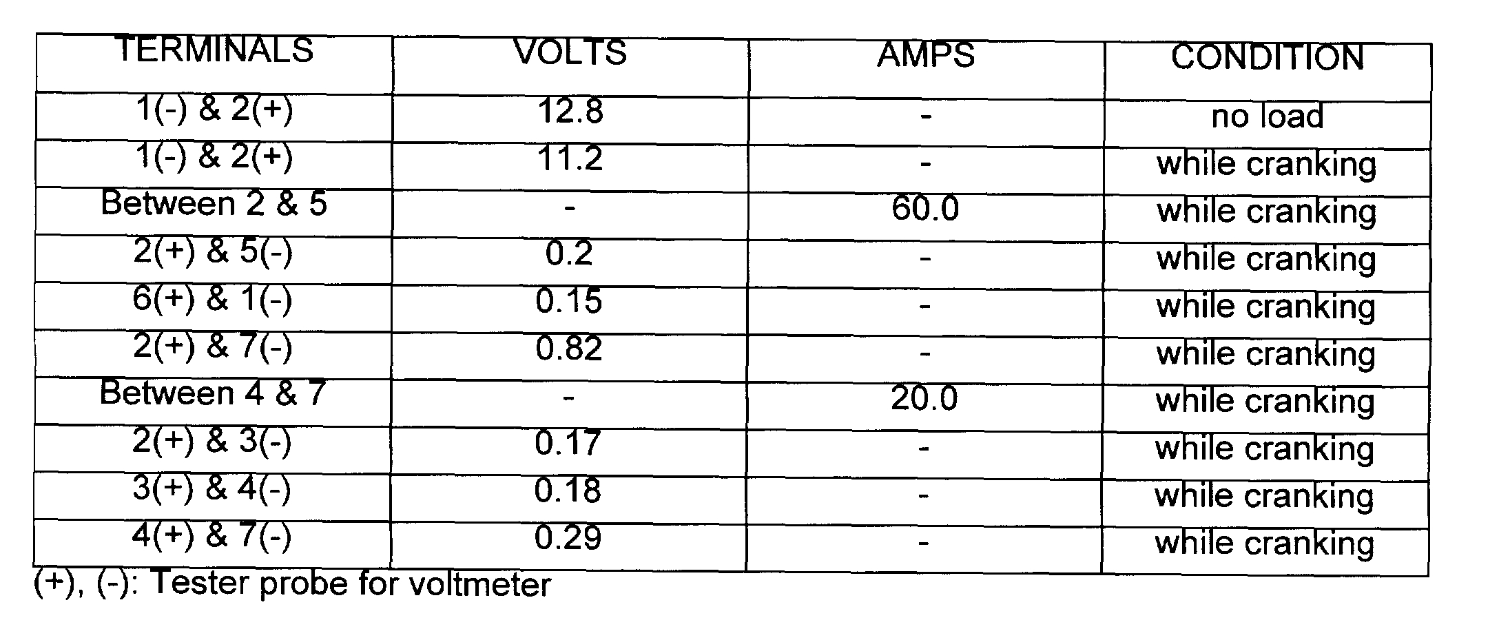

Let the following chart serve as a diagnostic guide in troubleshooting a starting circuit.
NOTE: System voltage is 12.2 volts unless otherwise noted. Values may vary depending on ambient or engine temperature, engine condition, oil viscosity, etc.
TEST POINTS: See last picture
