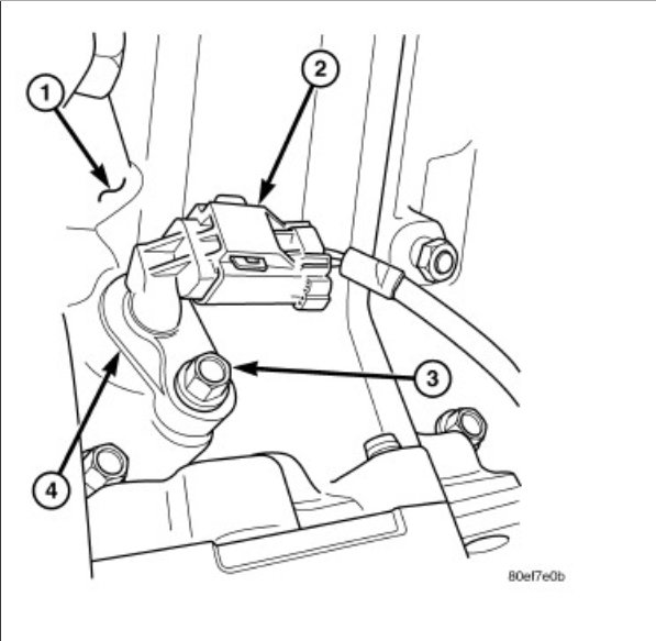

It sounds like the crankshaft angle sensor is going out which could be due to the heat of the overheating engine. When these sensors go out it may or may not leave a code this is why the dealer could not find anything.
Here is a guide to show you what you are in for when doing the job:
Here is a what it will be like on your car (below).
You may need to raise the car up safely.

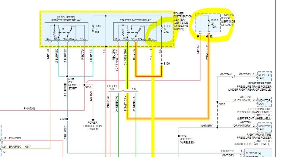

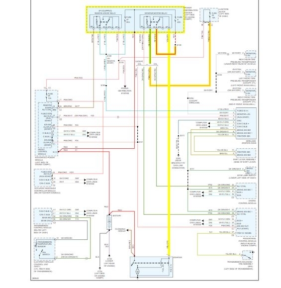

Good morning,
That is inaccurate information. Where did you hear that? There is no fuse you can pull to make it start.
Do you have a voltmeter to do some tests for the starting system?
Check the fuses I circled for power on both sides. Let us make sure there is power to the relay.
Aug 30, 2020 at 3:26 AM (Merged)
