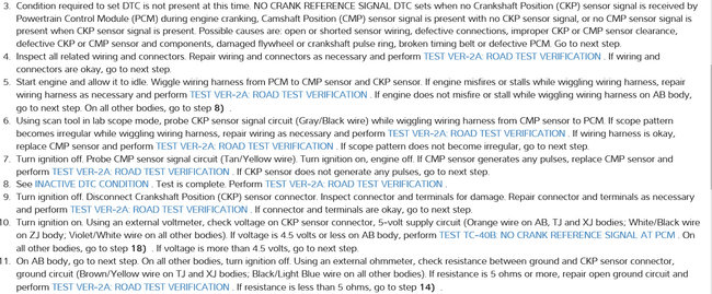

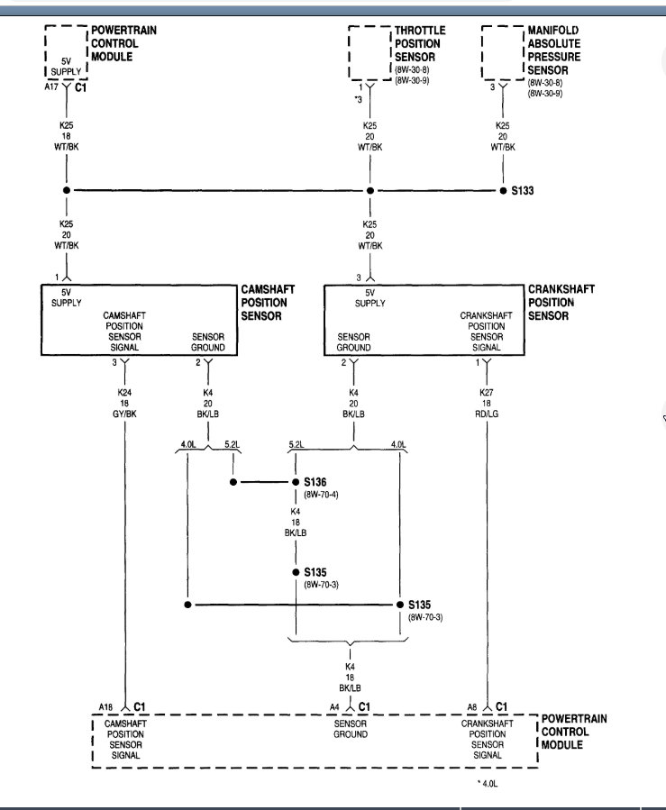

A couple weeks ago, my vehicle started running below 500 rpm when sitting still, stop signs, in traffic etc. In park seemed to be fine. It would run rough, and act like it was going to stall. Recently it got so bad it did stall while sitting in traffic. I managed to get it home, shifting in neutral and pumped the gas to keep it running. Now it will not start. No codes. Do not want to just throw new parts at it, seems like every sensor is at least $50.00 and up. Has fuel pressure at the rail, and spark. Any help would be appreciated. Thanks.

I finally got a code. p0320 ignition distributor engine speed input circuit.

It is back to not starting again.

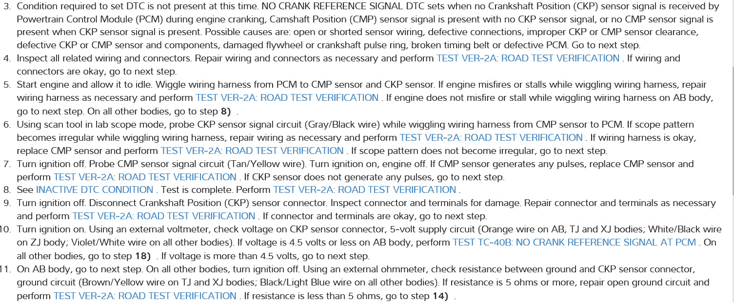

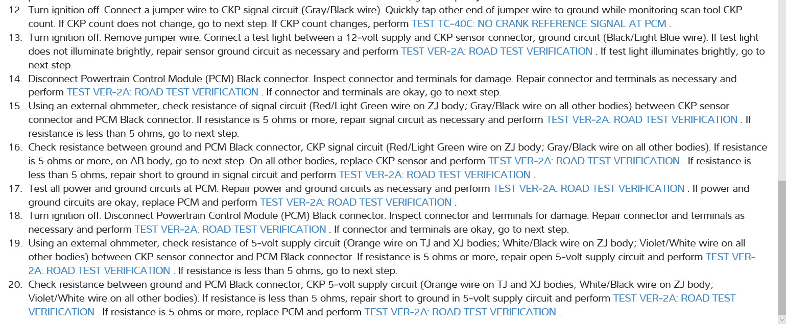

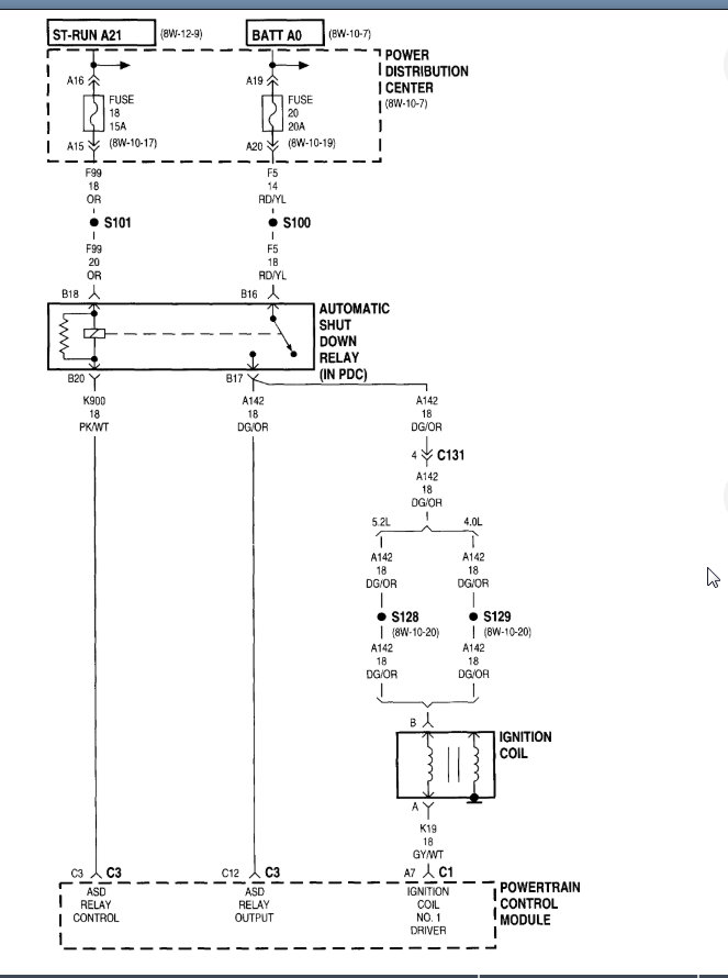

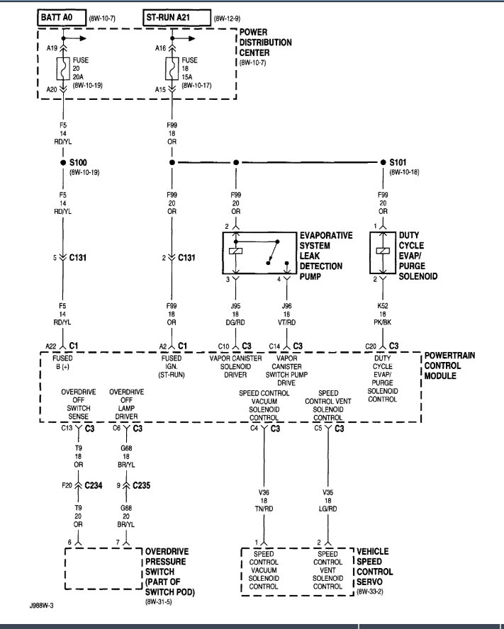

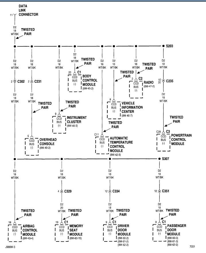

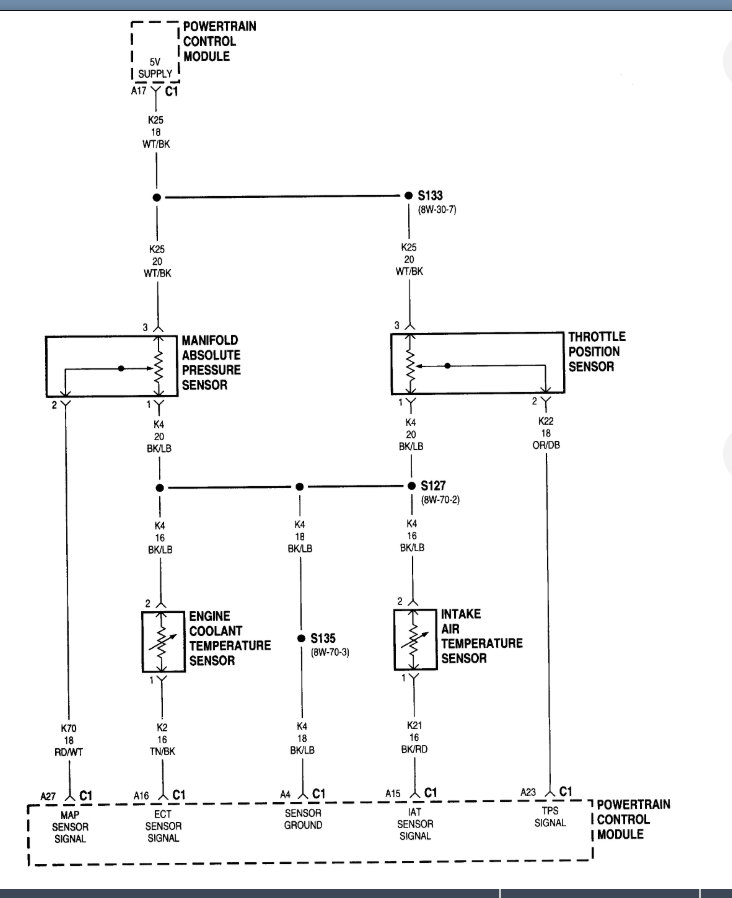

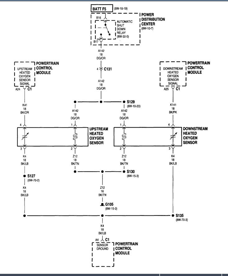

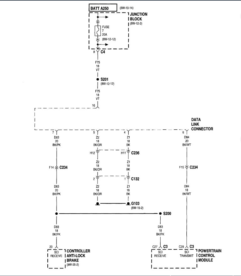

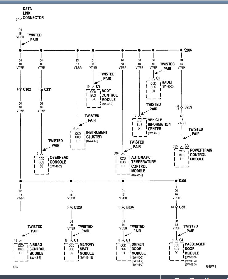

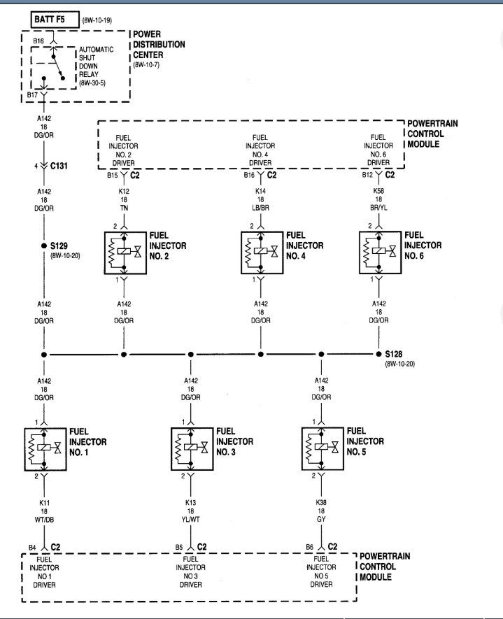

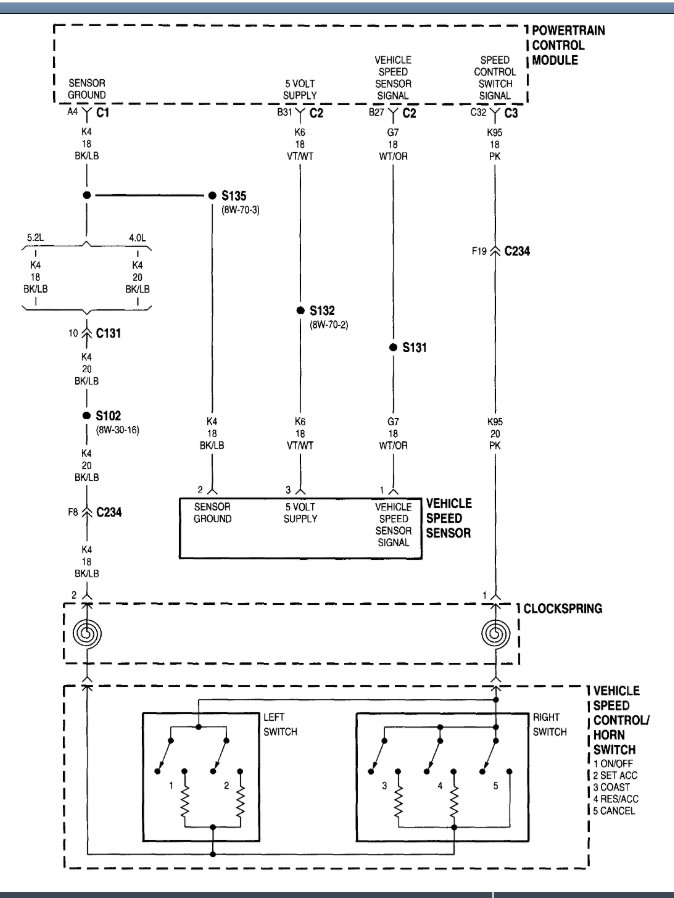

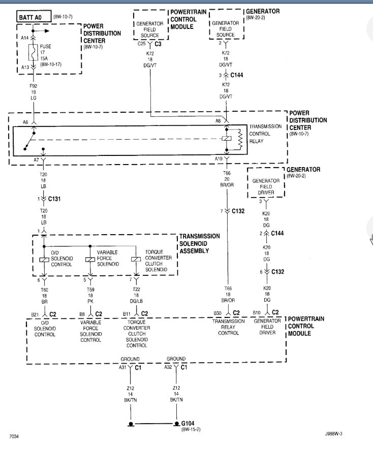

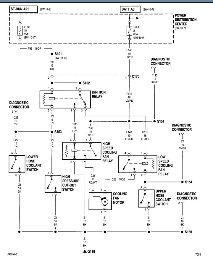

follow steps in pictures for diagnosis except where it says to use scan tool because you do not have a pro model to do it. also, do a wiggle test at crank sensor of harness if it starts the harness may need repair. see pictures. crank sensor is on transmission bell-housing.

It does sounds like it is a crankshaft angle sensor that is going bad. You will need an oscilloscope to test it though. Here is a guide that might shed some light on the subject as well.
and
Please run some tests and get back to us so we can continue helping you.

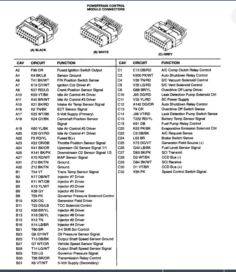

RAINVILLE3000
every thing has power but the ECM. need a wiring diagram of the ECM.
Aug 30, 2020 at 10:53 AM (Merged)
  • CERTIFIED EXPERT
Here are all the diagrams for the PCM. Clearly you need to verify B+ feeds and all the grounds. If you have no power to the ECM then that is where you start. Otherwise you need to check the crank signal and make sure the PCM is able to fire the injectors and coils. Let me know if you need more info. Thanks
