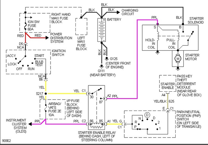

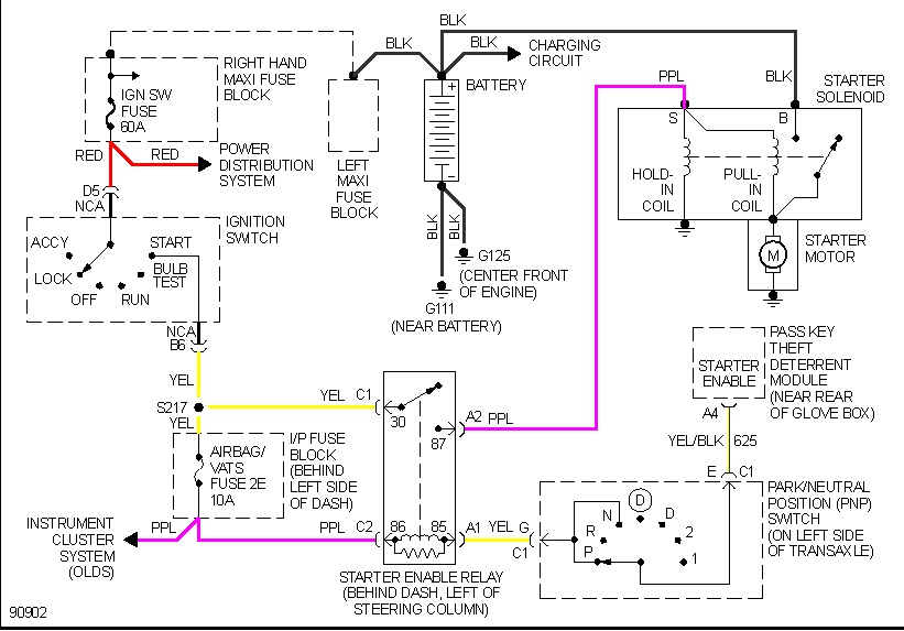

My 1997 buick lasabre wont turn over
Thursday, August 6th, 2020 AT 9:38 AM (Merged)
SATURNTECH9
  • 30,869 POSTS
So do you have a crank no start or a no crank no start?Let me know also do you have a multimeter?
JDL
  • 16,098 POSTS
What about your security system? Battery has a full charge and all connections are good? Below is starter wiring, any testing make sure the tranny is in park or neutral and the e-brake is set.
