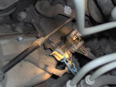

Will check it out tomorrow. I'm doing this on my own, so I need to run wires from the solenoid to my meter leads so I can read it when turning on ignition. I'm using solid 12 gauge wire. Tried it earlier today, got a zero reading volts on the meter. Not 100% sure my connections were tight .... will try again.
Unclear on testing the neutral switch. I think I found it ... passenger side, near cabin, looking down near the brake master cylinder. 2 connectors, one with 4 or 5 wires and another connector with 7 wires. looks like 2 bolts connecting it to transmission and a linkage on top. What do I disconnect, _where_ do I put + lead, and what does it mean voltage/no voltage?

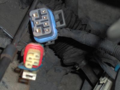

Connected about 36" 12 gauge solid wire to small solenoid cable. Attached volt meter. Turned ignition switch, got a reading of (negative) -0.03. Got similar reading in neutral, and by just applying brakes with ignition off. Turned on 30amp battery booster and tried again. Turned ignition on and got a positive reading of +0.07. Tested with test light (ignition on) .... no light. Can I assume the solenoid is not getting power and my problem is either the neutral switch or ignition switch? How do I test the neutral switch? I've removed the 2 connectors, but need guidance on which leads I test.
https://images.2carpros.com/forum/automotive_pictures/86488_neutralB_1.jpg
https://images.2carpros.com/forum/automotive_pictures/86488_neutralA_1.jpg
Thanks for your help, Jack jturner4@hotmail.com
Aug 6, 2020 at 2:37 AM (Merged)

before we go any further do you still have security light on and blinking
Yes, SECURITY light is still blinking. Should I have fixed that before testing the solenoid connection? Does SECURITY block the power?
If I leave the key ON for 10 minutes, won't that run down the battery (lights are always on when the key is ON).
_Jack_
