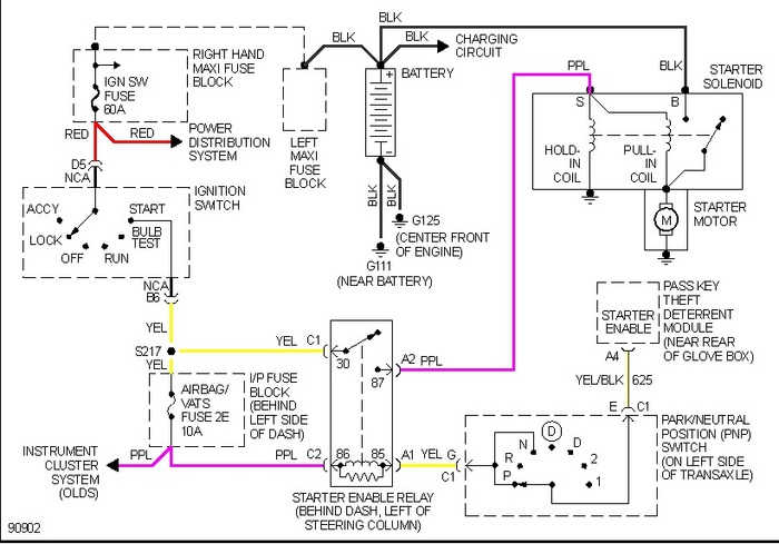

JDL
  • 16,098 POSTS
What about your security system? Battery has a full charge and all connections are good? Below is starter wiring, any testing make sure the tranny is in park or neutral and the e-brake is set.
