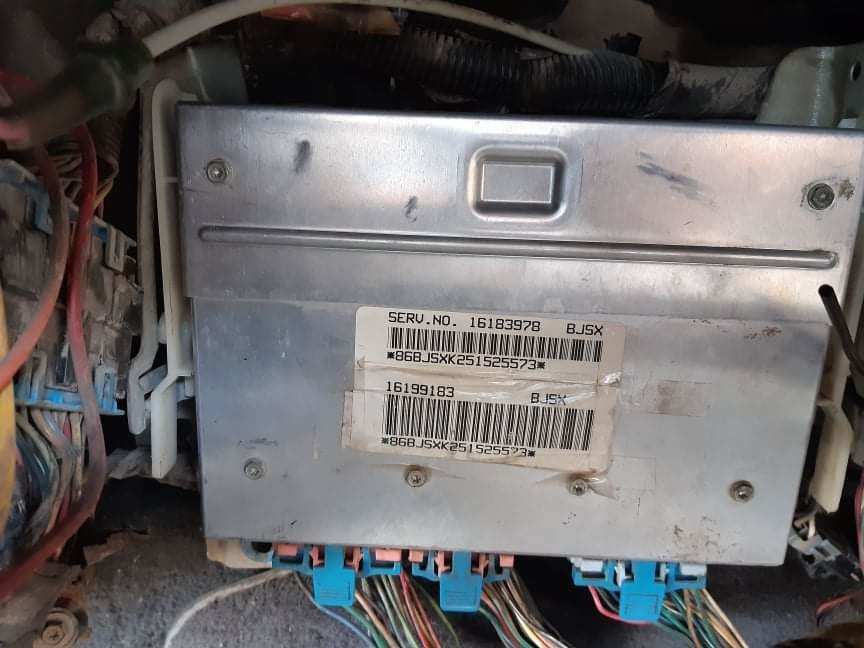

Did you match up the part number to the one currently in your car?
Aug 22, 2021 at 6:09 AM
YASIRDAHHAM
  • 186 POSTS

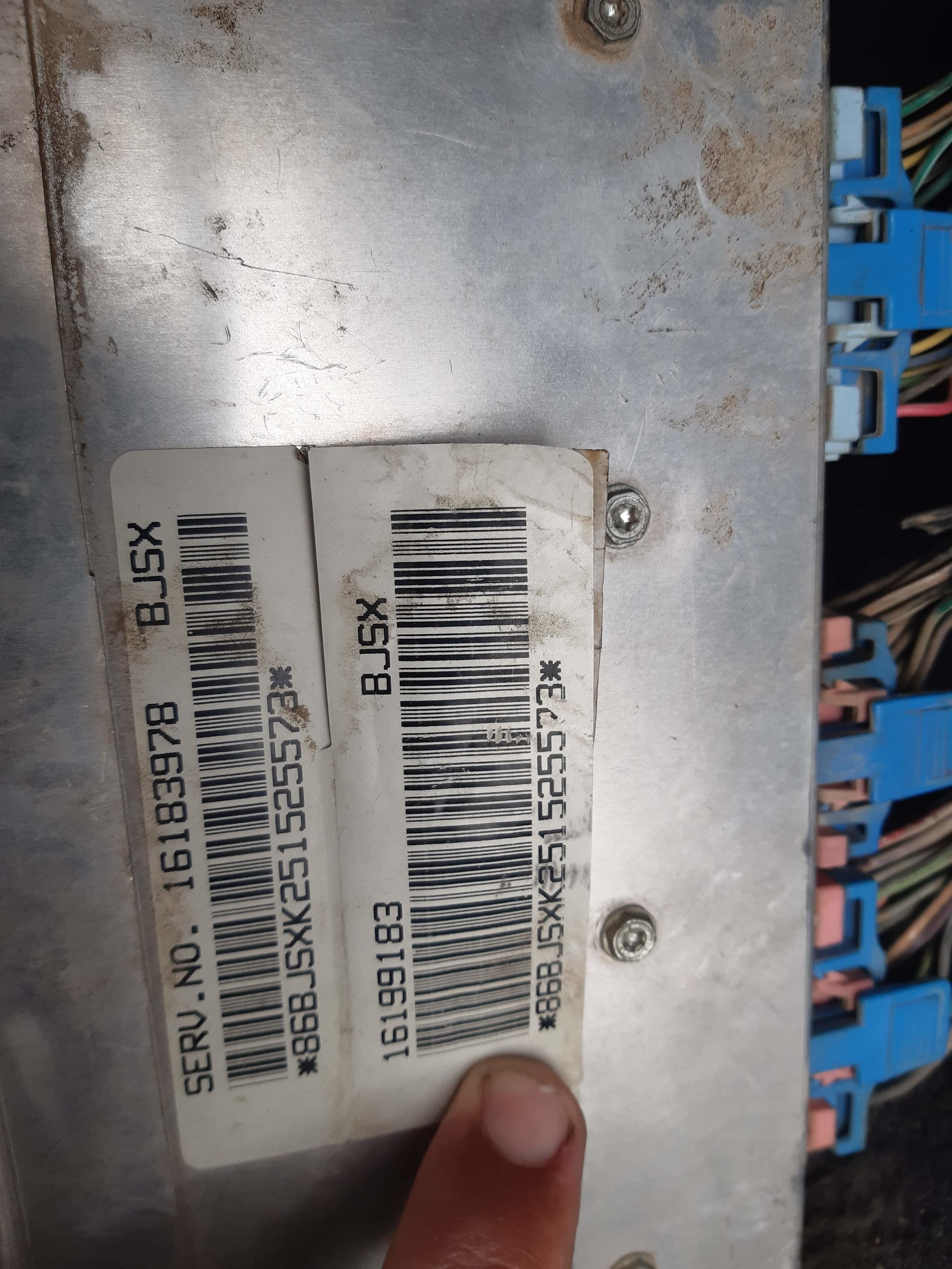

Is it possible for them after receiving all info relevant to my car / IP number- BJSX code- VIN/ to commit such a mistake/foul play? I will abide by your invaluable reminder and inquire as long as no payment has been made so far.
Aug 22, 2021 at 7:24 AM
The part number and calibration code should match up.
Aug 22, 2021 at 7:28 AM
YASIRDAHHAM
  • 186 POSTS
BJSX and 16183978 , respectively, according to the attached picture. please correct me if I am wrong.
Aug 22, 2021 at 7:35 AM
That is correct.
Aug 22, 2021 at 7:51 AM
YASIRDAHHAM
  • 186 POSTS
Thanks to you, to Steve and to Danny.
Aug 22, 2021 at 9:37 AM
YASIRDAHHAM
  • 186 POSTS
Other fact I brought them one instead of the other and not respectively. the BJSX is the calibration code.
Aug 22, 2021 at 9:39 AM
Good. That is what you need.

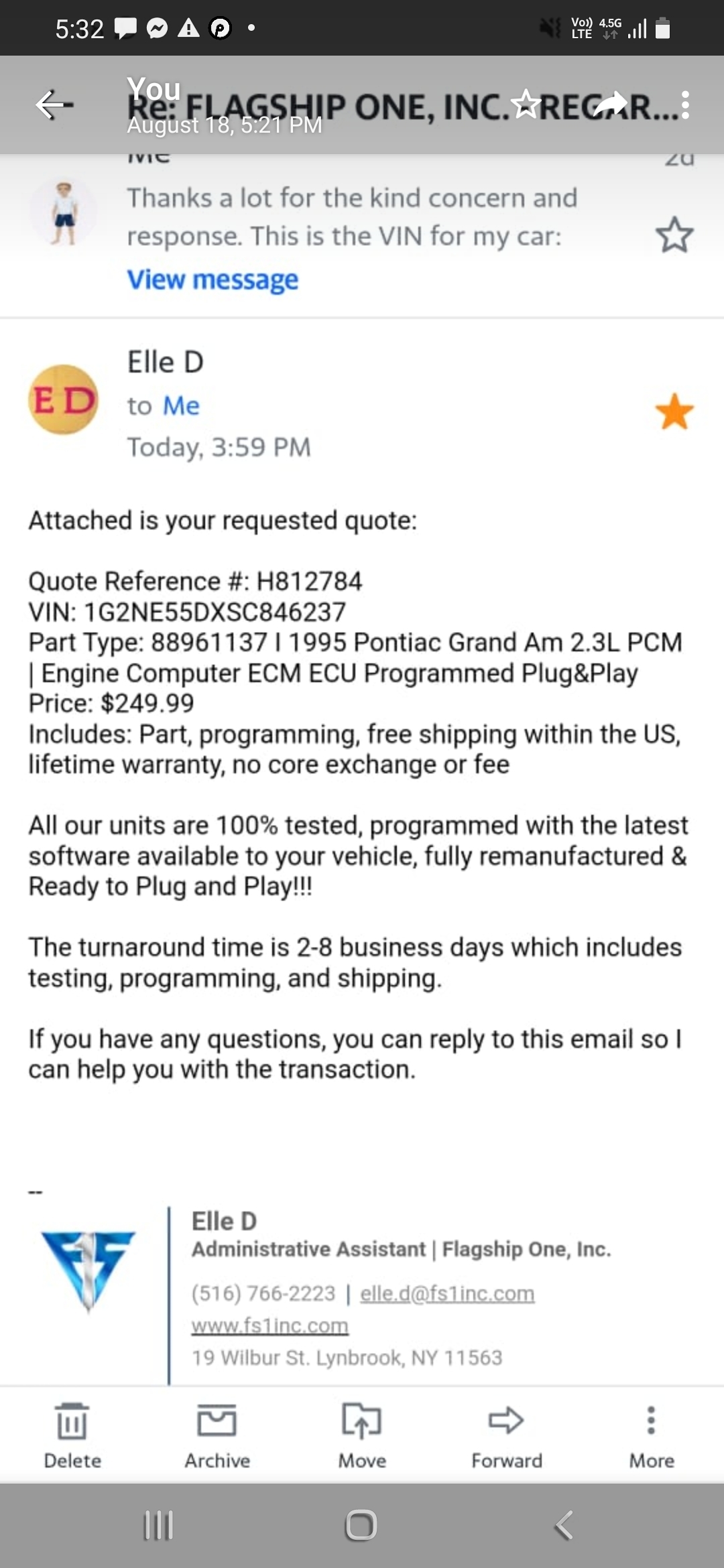

Hopefully so dear friend. This is the latest response from the PCM guys. I am awaiting their reply for the other rather more crucial inquiry of how compatible their PCM to mine as per the serial number and the calibration code.

Insha Allah like they say here. It will take a long long time because the car is left behind us in Iraq but I thought of cutting the lead time down through buying the PCM right now. What is lsghing behind is the OTC scanner issue, my friend in Texas is slow somehow.

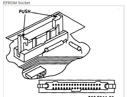

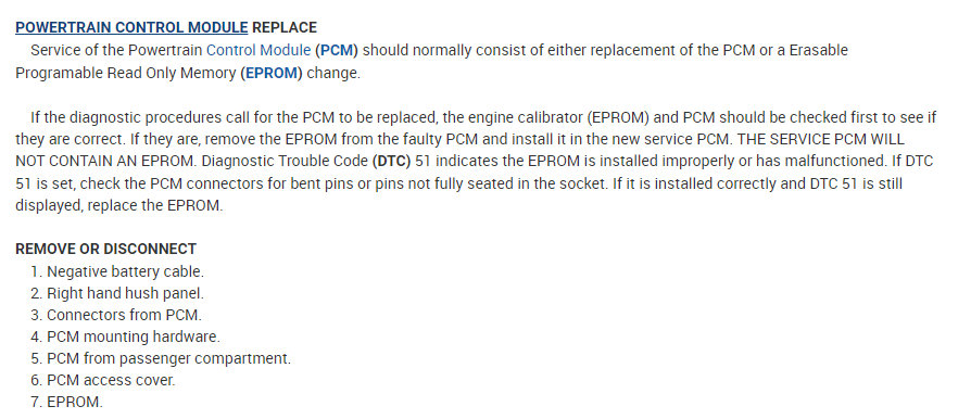

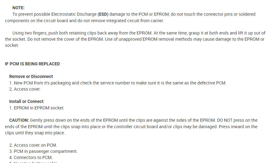

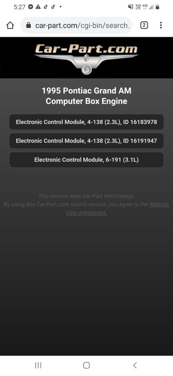

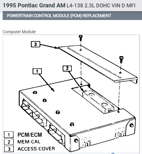

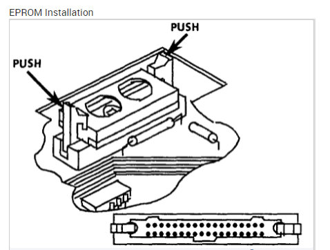

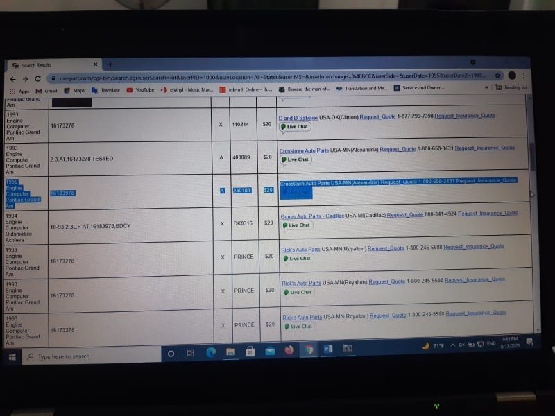

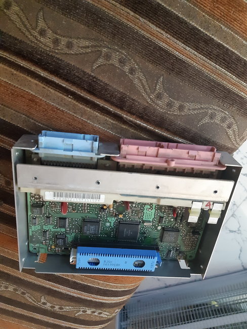

Hi dear friends, a latest update regarding buying a PCM for my car. Attached is a list that has what seems to be the best pick for my car so far, it is highlighted in blue and a friend of mine living in Virginia is about to collect and ship it to me. Somehow, I have the following queries indeed:
1. The EPROM of my suspected PCM ( seen here, second attachment) has a serial number and a calibration code too. While the (BJSX) code is there; the serial number ( 16199198 ) differs from the two numbers on the cover of the PCM/label (SERV No. 16183978 ) and (16199183), is this okay?
2. Since I first bought this car in 2006, I had been replacing its engine quite often( We have the least spares of it here in Iraq, they usually replace rather than overhaul, even while using second hand items it looks a better option to them/the mechanics and to us, the customers). Since matching the serial number and calibration code of the old PCM and the one intended to replace that) looks so crucial, may i inquire here: how was it all going alright with 4 engines replacing each other along 15 whole years (one of them was what they call here as the modern 2.4 L QUAD 4 engine having a slightly different bore size and a black fiber air induction manifold differing from the cast one in the rest of QUAD 4 engines)? No one ever mentioned the PCM all these years, just replace the engine and move on! The same PCM with its same EPROM had been controlling all those 4 engines so what was the PCM actually doing communicating with different engines using the same data in its EPROM? I am dazzled.
Aug 28, 2021 at 10:01 AM
DANNY L
  • 5,648 POSTS
Hello again.
As long as the service code and information like the VIN- vehicle identification number is the same showing all correct information was transferred to the replacement PCM everything should be ok. Serial numbers will always be different part to part. Let us know when you receive the replacement PCM and install and we will go from there. As far as replacing the engine that is just secondary. The only job the PCM does is monitor and control all the sensors and modules on the actual engine and vehicle. Hope this helps and thanks again for using 2CarPros.
