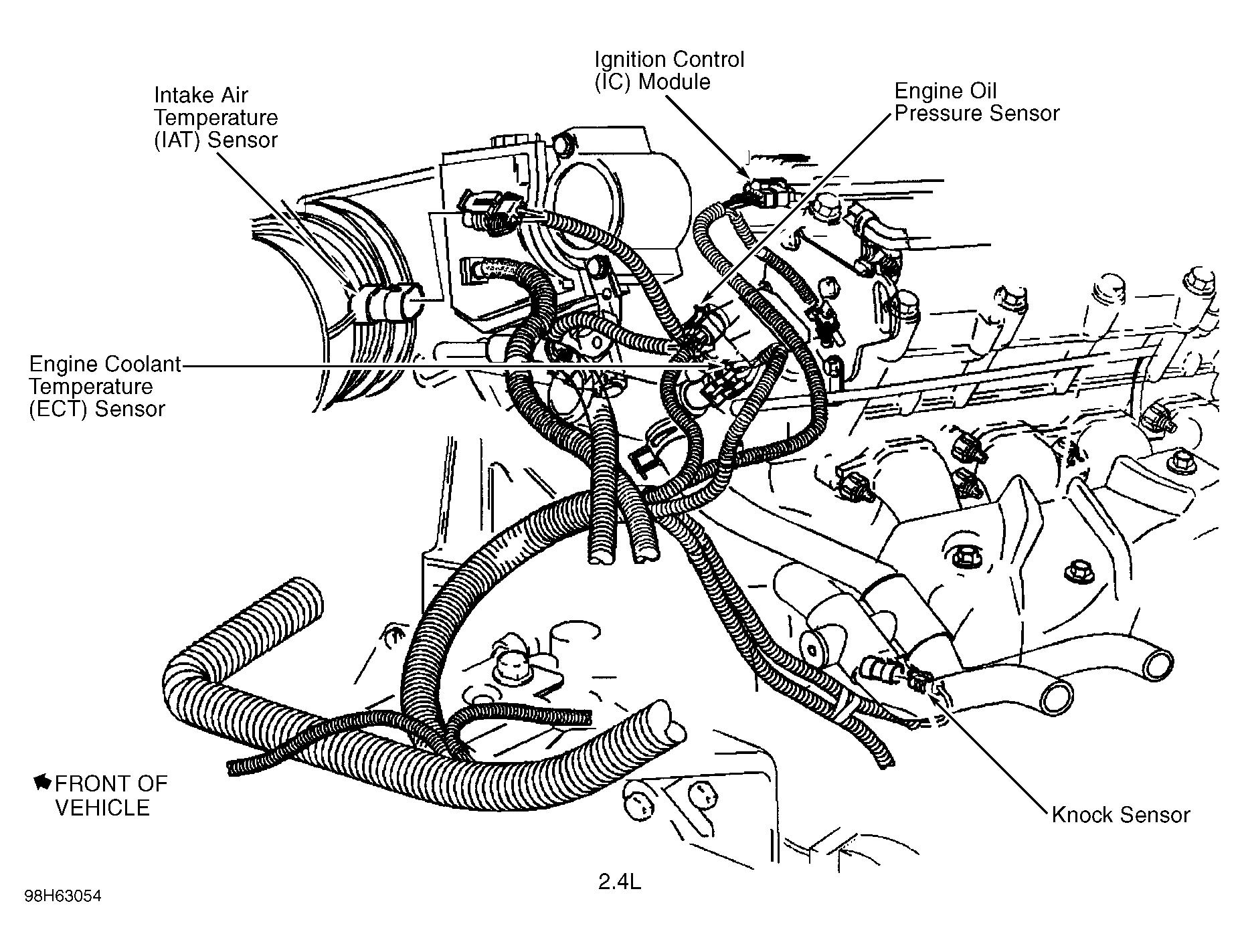

Hi, where is the coolant temperature sensor located on my car listed above?

Here is a guide that will help you step by step on how to change with the location for your car in the diagrams below. Rear of engine on the passenger side.
https://www.2carpros.com/articles/coolant-temperature-sensor-cts-replacement
