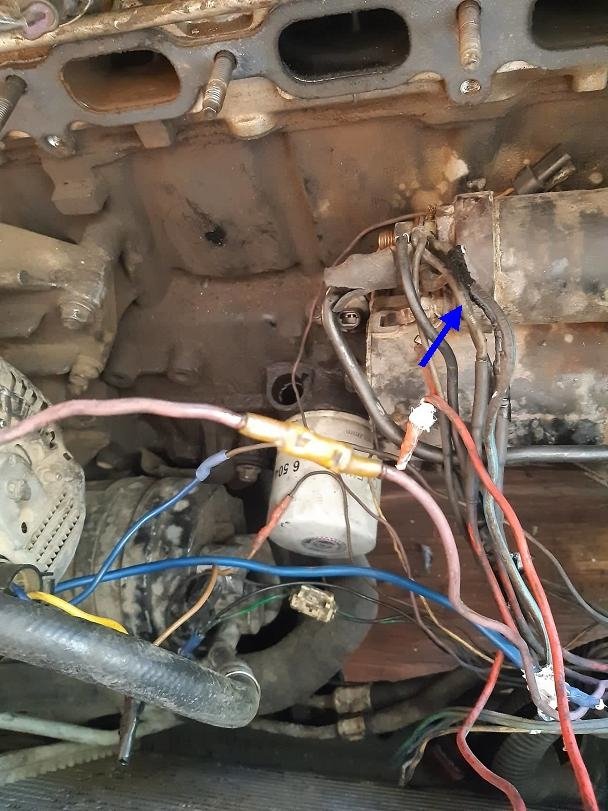

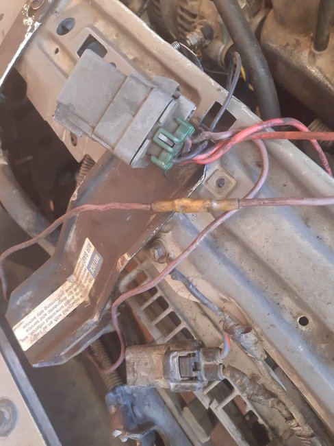

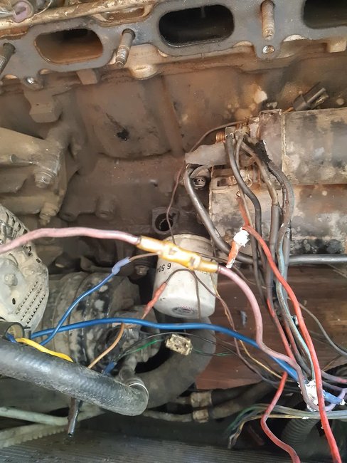

You're over-thinking the fuse link wires. They are simply a short piece of wire that's of a smaller diameter than the wire it protects, making it the weak link in the chain. Also, their insulation will not melt or burn. I pointed out one of your fuse links with the blue arrow. This circuit has nothing to do with the starter circuit. GM simply likes to use the large copper terminal on the starter solenoid as a convenient tie point rather than running that wire all the way back to the battery. Often, you'll find two or three fuse links attached to that stud.
You can buy replacement fuse link wire from an auto parts store. They come in lengths roughly 12" long and can be cut to make multiple repairs. The color of the insulation denotes the current rating, just as it does with regular fuses.
The length of fuse link wire you splice in is not important. It only takes a fraction of an inch to protect the rest of the wire.
Fuse links are not intermittent. As with regular fuses, when the wire burns open, it's done and has to be cut out and replaced. While I've never seen this, it might be possible to develop a corroded solder joint where the link is spliced to the regular wire, but as you can see on your car, those joints are sealed with moisture-proof heat shrink tubing. That has a hot-melt glue inside to seal better than regular heat-shrink tubing.
Unlike regular fuses, there is one thing that really causes some confusion with fuse link wires. When the wire burns open, at the end of the process there's some arcing that leaves a carbon track behind. If there's no load on the circuit, meaning no current trying to flow through that carbon, a digital voltmeter will "see" the full 12 volts further down the line. That falsely tells you there's 12 volts there and the circuit should be working, but it isn't. Here's where I tell people to use a test light instead of the digital voltmeter. Test lights operate by the current flow making the bulb light up. This has to be a standard, inexpensive test light, not one of the new ones with all kinds of circuitry inside. The test light will correctly show the circuit is dead. You can prove this to yourself even further by testing with the voltmeter first and finding the false 12 volts; then test with the test light at the same time while the voltmeter is still connected. You'll see the 12 volts drop to 0 volts as soon as the test light is connected.
Fuse link wires are used in some circuits because of their "slow-blow", or delayed response characteristic. This makes them desirable for motor circuits because those have a very high starting current that drops to a safe level once the motor gets up to speed. If a regular fuse was used for a radiator fan motor, for example, the fuse would have to be big enough to handle that high start-up current, and that could make it too big to protect the wiring if the motor developed tight bearings. Fuse link wires won't be used to protect a computer because if something inside the computer were to short, the wires and other parts of the computer would be damaged by the excessive current long before the fuse wire finally burned open. The only time you might find a fuse link wire feeding a computer is when that circuit also feeds other things that do draw high current at times. In cases like that you might find as many as a dozen wires branching off from one fuse link wire.
To test a fuse link wire, just gently tug on it. If it feels like a wire, it's okay. If it's burned open, it will stretch like a rubber band.

Great dispatch, as of all late ones of yours dear expert. The reason why I overthought the fusible links is because I had never known how they look and where are they. The image I included was not about the typical copper terminals that are usually there on the starter solenoid studs but the one that is raised up leaving the engine lubricant white filter in its background. It looked like a fusible link to me. I will conduct the tests you kindly suggested once I am back home hoping that a PCM is managed by then so that I be replacing mine. I am totally indebted for your generous assistance.

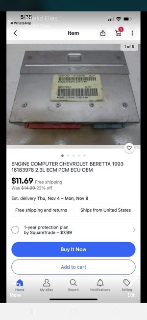

A tough complimentary commitment for me! I hope that the Iraqi expert back home will rise to his vows and be able to do all that using his scanner. The ID number shown on the proposed Beretta PCM matches that of my faulty PCM, only that quadruple letters code differs.

The seller/flagship1, you may well know of this American supplier/said it needs no flashing, plug-and-play since the ID number is the same. Quite obviously, he is paying no attention for the calibration code. I asked my friend / the one who bought it yesterday/ to find someone around his place in Irvine- California, some technician who can flash the unit prior to shipping it to Iraq.

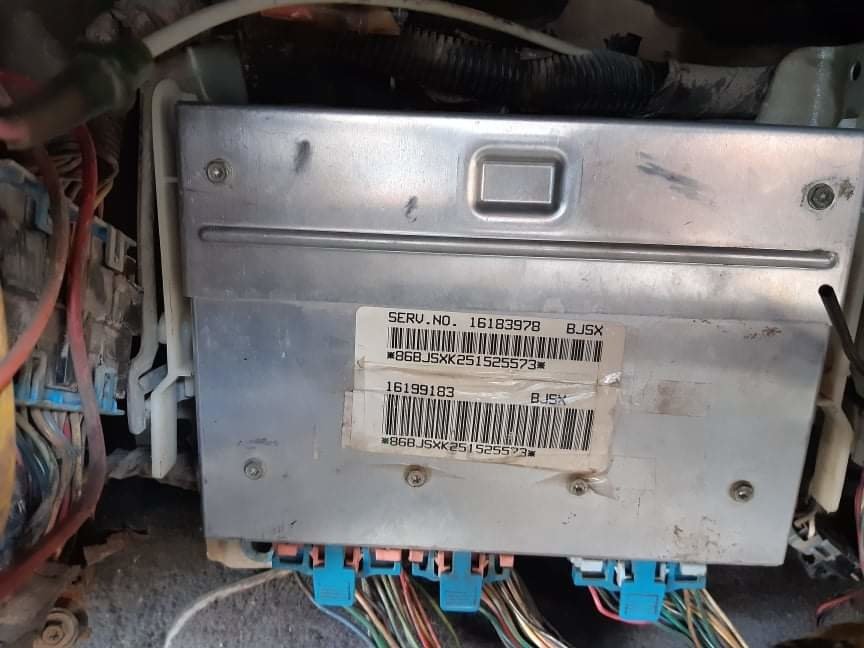

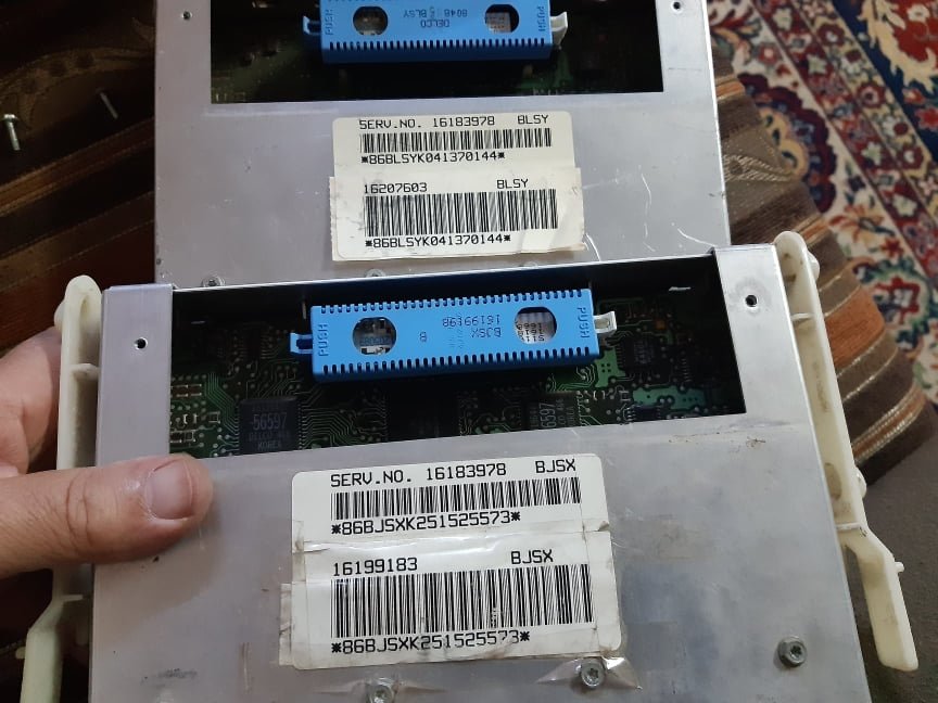

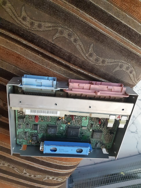

Hi dear Roy ( ASEMASTER6371)
Attached is an image for both PCMs. I returned back home and switched the old PCM with the one bought by my friend (meant for Beretta originally as the quotation said). It did not work at all; the engine was cranking a bit " slow/heavy" and ignition never took place. When I arrived back from Turkey, I tried running the engine (with the same old PCM), it turned alright and kept on working on idling mode for more than 10 minutes without turning off despite the fact that the service light was still on all the time.
I replaced the Eprom of the new Beretta PCM and used that Eprom of the old PCM, nothing changed, the engine never started as if the is no fuel at all. Based on what you kept telling me here, a flashing action has to be done but when I sent this info to the owner of the Beretta PCM (it is Flagship 1 company) they insisted that it needs no flashing since the ID number is the same. In case I head for that guy in Baghdad, does he need the whole car to be there or the individual PCM unit is enough to program/flash the VIN to it?
Nov 18, 2021 at 1:50 AM
Okay, there is no flashing the OBD1 ECM. They are correct.
As far as the units, the ECM part numbers are right, but calibration codes are not. Use the chip from your old ECM in the replacement and see if it runs.

I switched the Eprom, took the old PCM's Eprom and inserted it in the new PCM's slot. It did not work. I took the old Eprom, and inserted it back in the slot of the old PCM and guess what? The engine does not start! It used to work alright days ago albeit with the service light glowing all the time, but it still worked alright for more than 10 minutes, it was me who turned the ignition switch off, not that it stalled all by itself like before. I am perplexed.

Can you give me the numbers off the old EPROM?
Nov 19, 2021 at 1:06 AM
I apologize for a hasty info I gave minutes ago, I posted the status and tried running the engine again with the old set (old PCM along with its old Eprom) after securing the connection with the blue and white latches astride the Eprom unit, it worked, the engine worked fine, and I switched it off after some 4-5 minutes. 16199198 is the Eprom number, image attached.
Nov 19, 2021 at 1:35 AM
Okay, it is discontinued, and none are available at all.

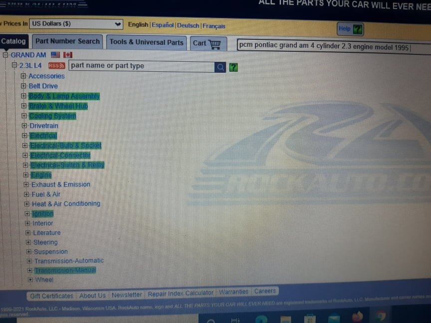

Go to Rockauto.com and check the manufactures that have the ECM and see if they have new EPROMS in them.
Nov 19, 2021 at 2:29 AM
No, see if there ECM has one installed.
