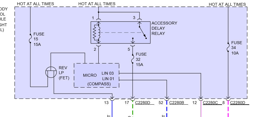

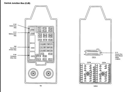

drivers side window and two back windows wont work. The only one that works is the passenger side front. When you press the window button the door ajar light flashes. Just started happening.
Aug 18, 2016 at 12:14 AM
HMAC300
  • 48,601 POSTS
have a mechanic scan for codes it may be a body module problem there are two fuses and a circuit breaker in them and they may be internal it is in right kick panel. it may be accessory delay relay as well.

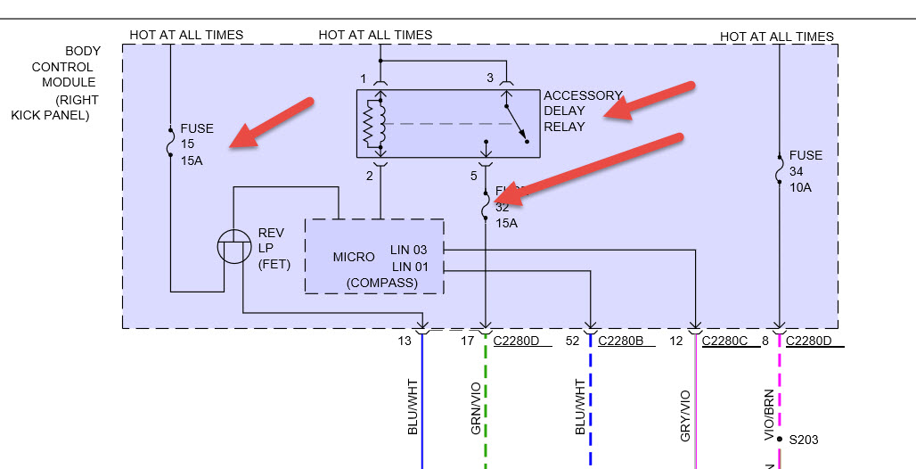

HMAC300
  • 48,601 POSTS
check fuses which are in body module along with accessory delay relay but they may be internal as well so will probably need scanning by a mechanic if you can't see them

HMAC300
  • 48,601 POSTS
I assumed you checked the fuse alreadycheck these in body module as well as relay. However these may be internal and cannot be checked which means you'll have to see a mechanic so he can scan it to see if it's the problem or something else.

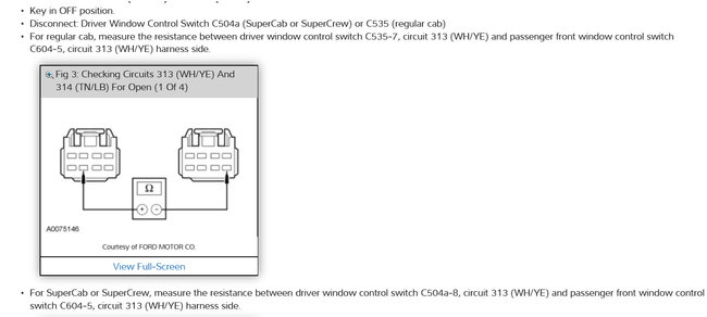

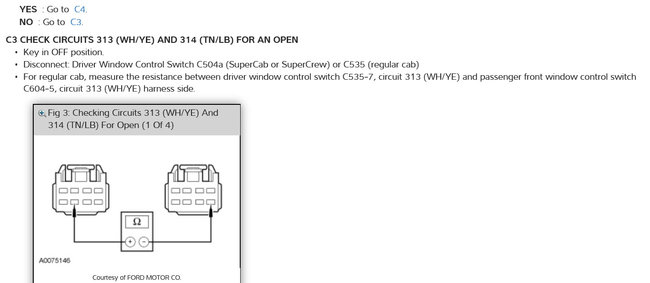

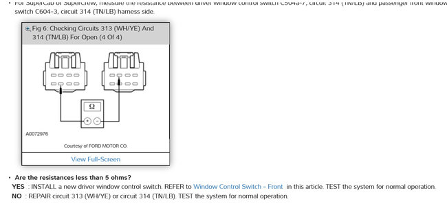

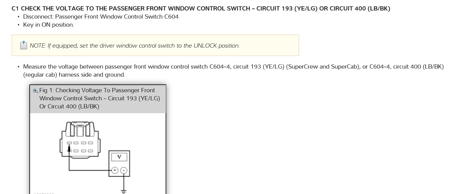

DALTON TAM
Okay, so a while back the passenger side window decided to stop working
and not roll down. I finally decided to fix it. I went straight to replacing the power window motor and regulator and had no luck. So I thought it may be a switch. I have tested brand new switches on the passenger side as well as the driver side main power window switch with no luck. I got a test light out and checked to see is I am getting power to the window motor from the switch on the passenger's side. I have power all the way to the motor for up and down on using the passenger's side switch. I can hear the motor engage in when i press up but nothing when I press down. So i thought, well maybe I bought a faulty new motor. I bought another motor and regulator and hooked it up before installing it and had no luck, which tells me that the window is not just stuck in the window jam. So now I am lost.
Note: when using a test light to check power where the connector meets the motor (while using the driver's side switch), I get power from both terminals when pressing down but nothing when i press up in either terminal.
This is mind boggling.
Mar 26, 2019 at 9:35 AM (Merged)
HMAC300
  • 48,601 POSTS

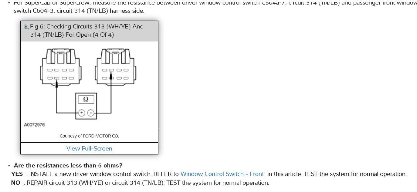

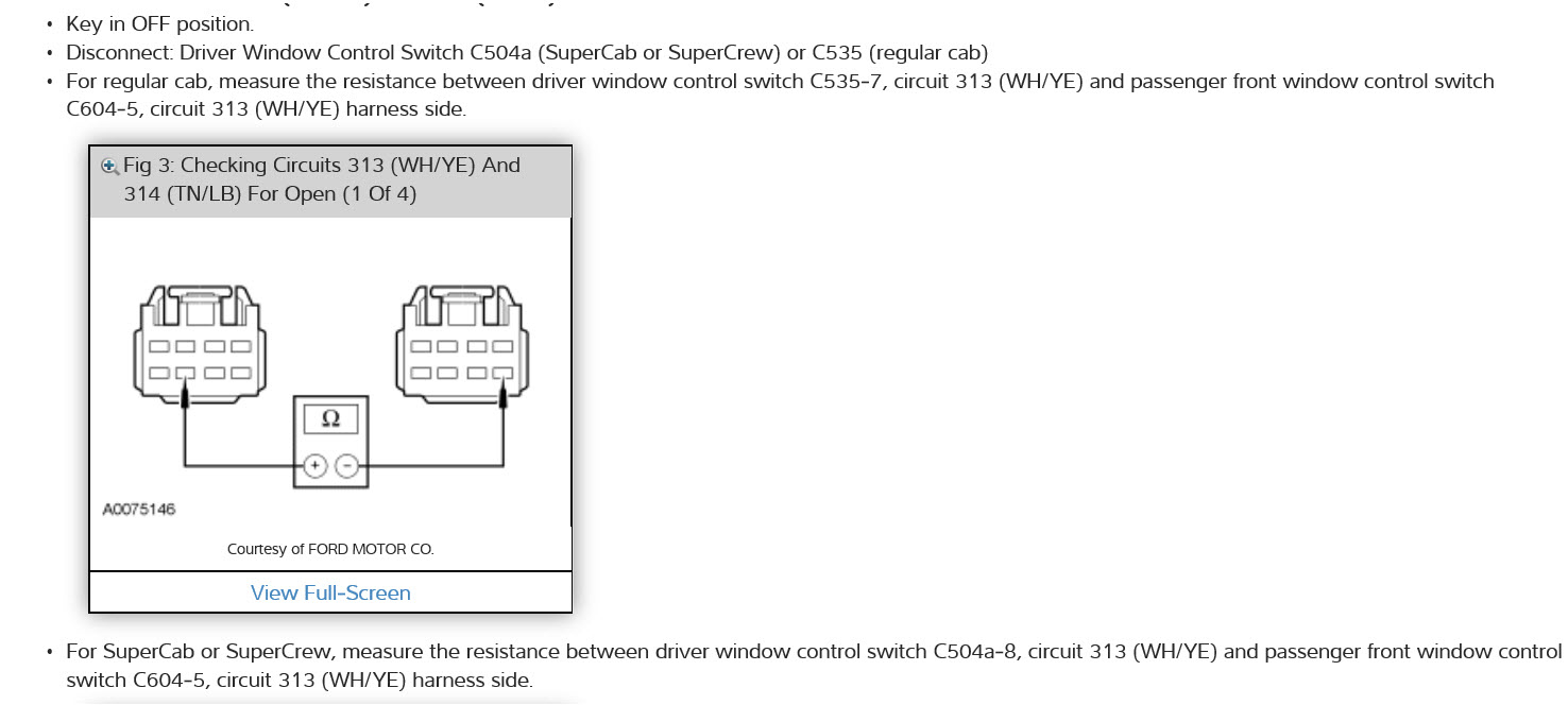

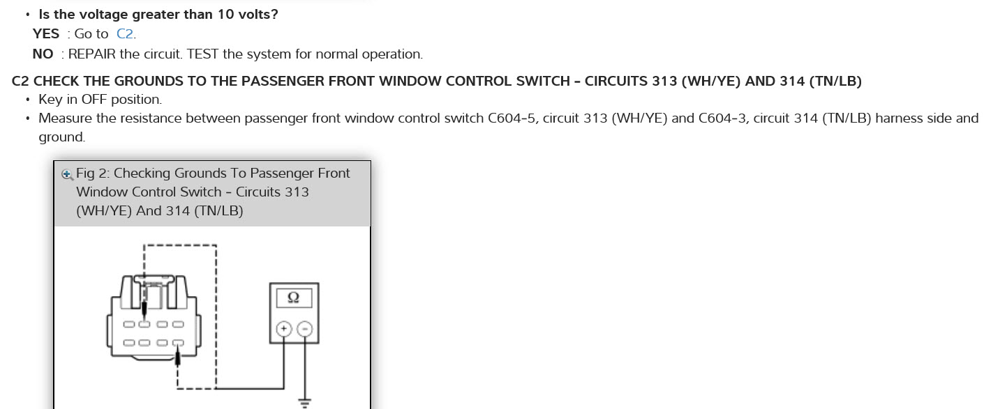

Do the checks in pictures it may be a bad drivers door/master switch. Here is a guide as well.
https://www.2carpros.com/articles/electric-window-repair
Check out the diagrams (Below). Please let us know what you find. We are interested to see what it is.

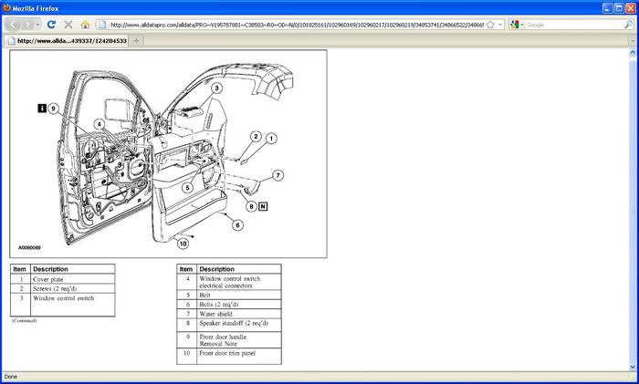

SATURNTECH9
  • 30,869 POSTS
FRONT DOOR TRIM PANEL
REMOVAL
NOTE: LH side is shown. RH side is similar.
1. Remove the front door speaker.
2. If equipped, remove the window regulator handle.
1 Separate the handle cover from the handle.
2 Remove the screw.
3 Remove the window regulator handle.
4 Remove the spacer.
3. Remove the parts in the order indicated in the given table.
Item 9: Front Door Handle Removal Note
1. Guide the door handle through the opening in the trim panel.
INSTALLATION
1. To install, reverse the removal procedure.

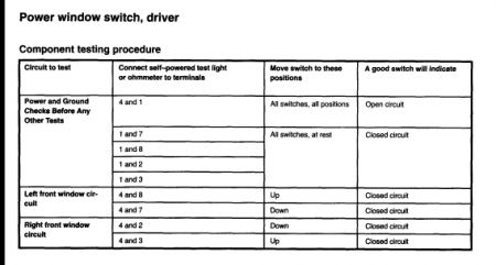

DAVIDSON

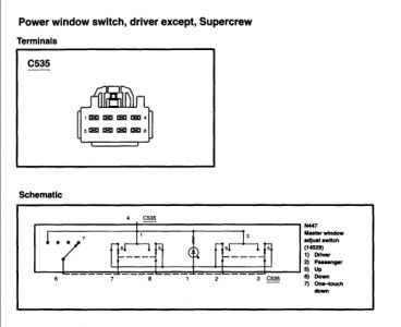

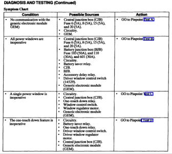

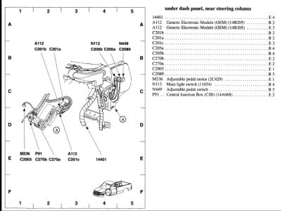

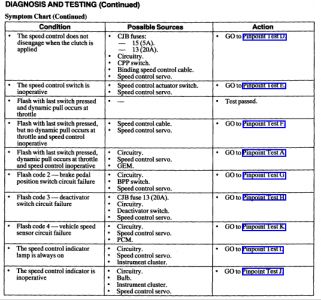

No power to windows , Dash lights dont work when lights are in automatic , Cruse control doesn't work, put in new main power switch , Window motors are ok , Fuses are good
Mar 26, 2019 at 9:37 AM (Merged)
IMPALASS
  • 3,112 POSTS

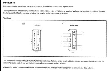

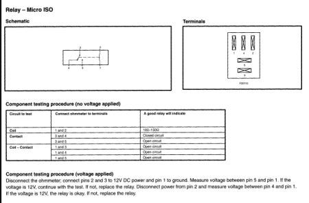

Hello I have attached the troubleshooting chart for the windows. Also, I have attached how to check the window relay. I am not sure how you are checking your fuses, but instead of a visual I would use an ohm meter to ensure.
https://images.2carpros.com/forum/automotive_pictures/248015_z1_2.jpg
https://images.2carpros.com/forum/automotive_pictures/248015_z2_2.jpg
https://images.2carpros.com/forum/automotive_pictures/248015_z3_1.gif
https://images.2carpros.com/forum/automotive_pictures/248015_z4_2.jpg

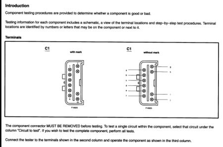

You said you replaced the main power switch so I attached how to check the window switch.
https://images.2carpros.com/forum/automotive_pictures/248015_z5_2.jpg
https://images.2carpros.com/forum/automotive_pictures/248015_z6_1.jpg
https://images.2carpros.com/forum/automotive_pictures/248015_z7_1.jpg
The windows go through a Generic Electroonic Module (GEM) You will need to see if there are any codes to check this out. You can go to Auto Zone or O'Reilly's and they can check to see if your car has any DTC codes for free. Make sure if it does and you don't fix it and you need to get back with us you tell us the code number and what they said the code meant. Also while there have them pull their tester out and for free they can check your battery, alternator and starter. This is what the GEM does. NOTE: Each vehicle has either a Generic Electronic Module (GEM) or Central Timer Module (CTM) depending on option content. Upon installation of a new GEM, the module must be reconfigured. Refer to Module Communications Network (Information Bus). The following is list of GEM/CTM controlled functions: wipers/washers (front/rear) warning chimes battery saver illuminated entry and courtesy lamps accessory delay driver power window (GEM only) The generic electronic module (GEM) constantly monitors its subsystems for concerns. If a concern is found in one of the subsystems, the GEM will record the concern in the form of a Diagnostic Trouble Code (DTC) . The ignition switch position is very important to the GEM function. Often times, erratic or unexpected GEM function can be traced to concerns with ignition switch inputs. Ignition Switch Positions The position of the ignition switch is very important to correct GEM operation. The following is a brief description of five ignition switch positions. When the ignition switch is in the RUN position, battery voltage should be present at the GEM RUN and RUN/ACC input terminals. When the ignition switch is in the ACC position, battery voltage should be present at the GEM RUN/ACC input terminal only. When the ignition switch is in the START position, battery voltage should be present at the GEM start/clutch depressed input. The GEM module does not have an OFF or LOCK switch state input. The GEM will assume the OFF or LOCK position when there are no RUN, ACC, or START signals present. CAUTION: Prior to removal of the GEM, it is necessary to upload module configuration information to a diagnostic tool. This information needs to be downloaded into the new module once installed. Once the new GEM is installed, it is necessary to download the module configuration information from the diagnostic tool into the new module
https://images.2carpros.com/forum/automotive_pictures/248015_z8_1.jpg

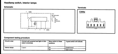

If I understand your question, the dash lighting is controlled by the headlamp switch. Testing the headlamp switch
https://images.2carpros.com/forum/automotive_pictures/248015_z9_1.jpg
https://images.2carpros.com/forum/automotive_pictures/248015_z10_1.jpg
I think after your checks it is possible that the headlamp switch may be defective for your dash lights. I think your GEM is affecting your windows. For your cruise control First you have 3 recalls you need to check with the dealer with your VIN number to see if you are okay. First recall: 05S28S14 01/28/2008 Recall - Speed Control Deactivation Switch Defects Second recall: NHTSA07V336000 08/02/2007 Recall 07V336000: Cruise Control Fire Hazard Third recall: NHTSA05V388000 09/07/2005 Recall 05V388000: Cruise Control Switch Replacement As before - I would have the codes checked on the car. I have attached the troubleshooting charts for the Cruise. You do need the attached special tools to check. But I would go through all the fuses with the ohm meter and start there. Then get back with us if you don't find anything.
