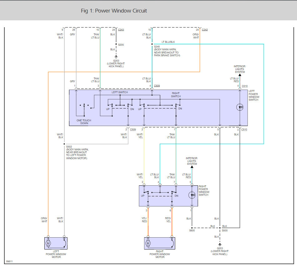

power windows stop working, driver & passenger side

Did you check fuses? Also, have you checked to see if there is power to the driver's side switch?

No power to door switches. Have checked fuse and relays.

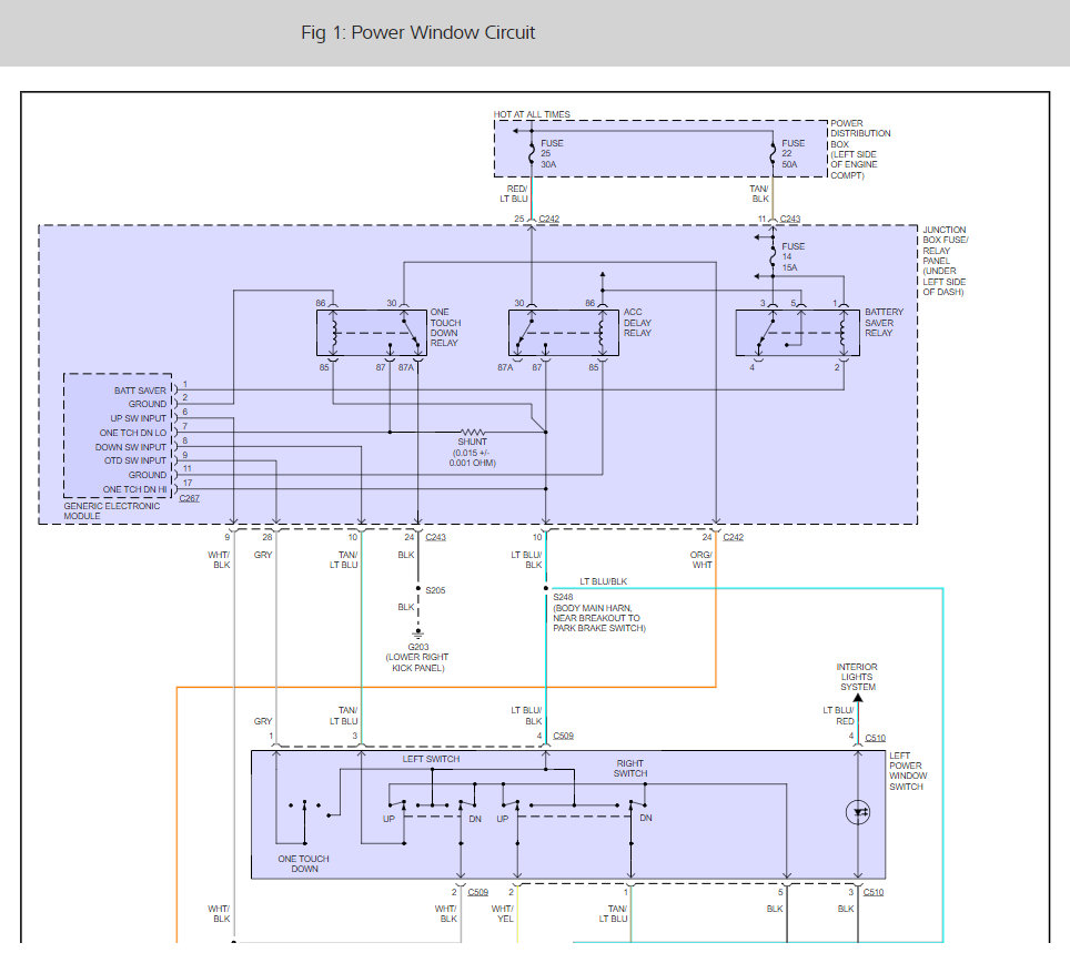

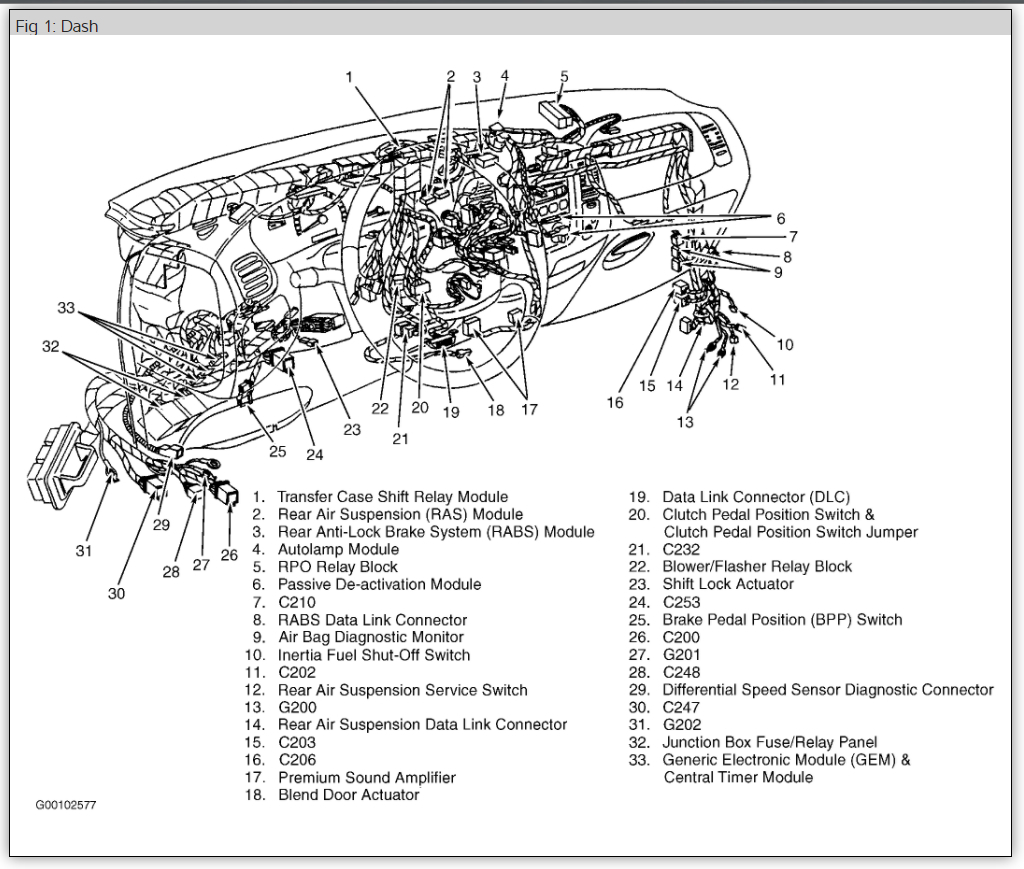

The GEM interrupts the power of the system I would start there here is a wiring diagram (below) and some guides to help you confirm the problem.
Please let us know what happens so it will help others.
