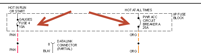

BRADHLGV
Driving home, all dash (radio, AC, gauges, clock, etc) and pwr windows quit working. Still drove home w/ no problem. Truck ran just fine. What do I look for? Saw no wiring disconnect under hood. Could 1 fuse cause this?
Mar 26, 2019 at 9:37 AM (Merged)
JDL
  • 16,098 POSTS
Pick one system, check the applicable fuse. Not only check the fuse, check the fuse circuit for voltage. Some of those systems may use ignition feed/ the fuse circuit goes hot when you turn on the key. If those systems you listed are ignition feed, I'd have to check ignition switch.
JDL
  • 16,098 POSTS
As far as the radio and power windows, the acc delay relay is a connection. I haven't checked about the gauges.
The acc delay relay is located in the relay box, interior, behind right side kick panel. My info shows the voltage to the relay is hot all the time. Ground for the relay is controlled by the ipc/instrument panel cluster. Relay should be active when you turn on the key.
Can you have applicable codes checked, That might narrow things down? Otherwise I'm a wire chaser, check voltage and ground at the relay mentioned.

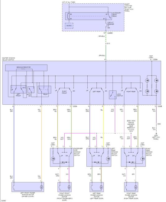

BRIANCB
Hi: my passenger window is not working from any switch, in any direction. Here are the symptoms and what I have done so far.
- through testing, I find the window will go up from it's door switch, but the master switch produces no effect.
- the window is not "stuck," it moves freely when the motor is removed.
- the motor is good, tests both directions.
- the door switch was replaced with a (used) working unit, no issues there.
- the master door switch was replaced with a (used) working unit, no difference in the issue.
So, I have ruled out a stuck window, bad motor or switch(s).
Am just not ready to bring to Ford and turn over my checkbook for them to spend hours testing the wiring. What do you think?
Brian
Mar 26, 2019 at 9:38 AM (Merged)
RIVERMIKERAT
  • 6,110 POSTS
It sounds like I need you to tell me the exact submodel and trim so I can get you the right wiring diagrams for it.
BRIANCB
f150 crew cab, XLT
the interior is cloth, not leather.
RIVERMIKERAT
  • 6,110 POSTS

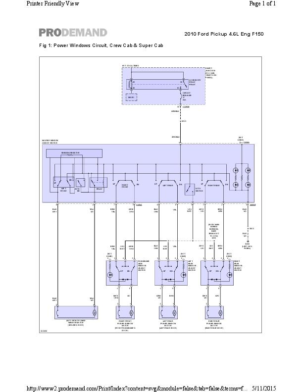

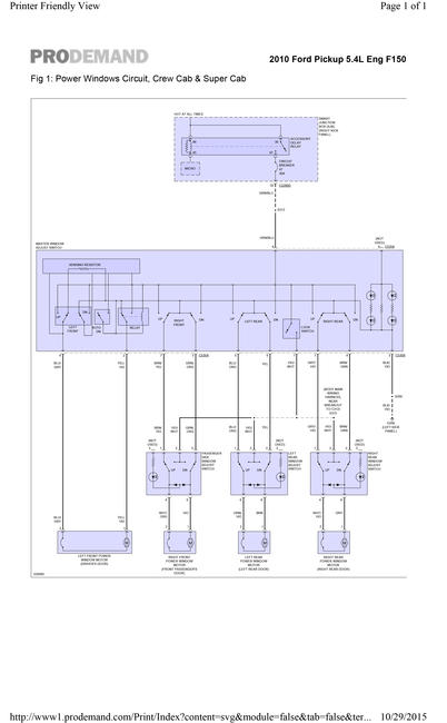

Here is the power window wiring diagram for the 2010 F-150 XLT Crew Cab.
THIS IS MIKE
  • 686 POSTS
BrianCB
Hi, on several occasions I have tried to print that wiring diagram and have had no success printing a read-able version. Can you send me the file as a high res .pdf?
RIVERMIKERAT
  • 6,110 POSTS
I'm hoping that a jpg image will be better for you.
THIS IS MIKE
  • 686 POSTS
See if this works better
RIVERMIKERAT
  • 6,110 POSTS
Let us know if neither of these work for you. I can upload it to my Dropbox.

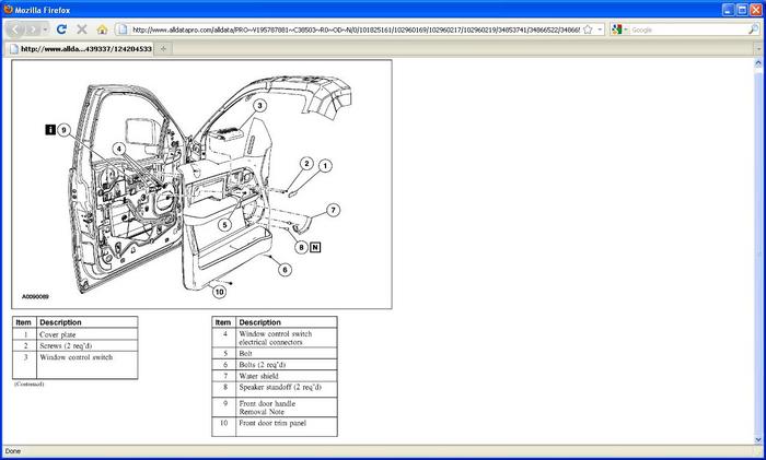

how do i replace window control switch
Mar 26, 2019 at 9:39 AM (Merged)
  • 110,244 POSTS
Hi:
To replace the switch you need to remove the door panel to gain access to it. Once there, it's just a matter of unclipping the old switch, disconnecting the plug and reversing the order.

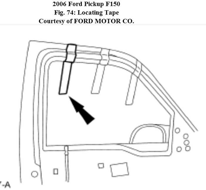

How to replace power window regulator on a 2006 Ford F150 driver side?
KHLOW2008
  • 41,814 POSTS
WINDOW REGULATOR AND MOTOR - FRONT DOOR
Removal and Installation
1. Remove the front door trim panel.
2. Remove the front door watershield.
3. Secure the front door window glass in the full UPWARD position with tape.
Fig. 74: Locating Tape
4. Remove the front door window glass-to-regulator assembly bolts.
Loosen the glass clamp fasteners through the 2 vertical slots in the inner door panel.
To install, tighten to 9 Nm (80 lb-in).
5. Disconnect the front door window electrical connector.
6. Remove the front door window regulator bolts.
To install, tighten to 11 Nm (8 lb-ft).
7. Remove the front door window regulator and motor.
8. To install, reverse the removal procedure.
