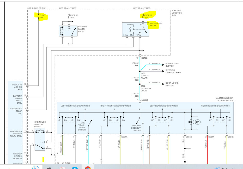

The power window motor should receive battery voltage, 12v. Power is supplied via the accessory relay/fuse 10 in the interior fuse box. Also, from the 11 which is sent to the GEM module and then to the main switch.
I attached the wiring schematic for the power windows below, so you have a reference. Let me know what is happening.

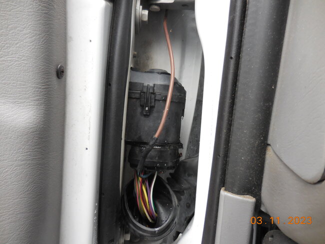

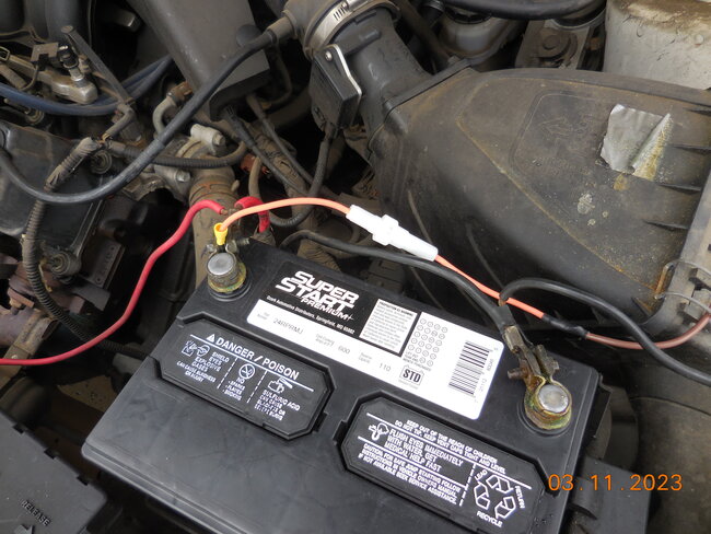

The main power wire to the door was broken. I spliced a wire to the piece at the boot that went to the door panel. Ran the wire up through the hinge to the positive post on the battery and spliced a inline 10 amp fuse in the line. That was the only way I could get power to operate the windows. The only way I could get to the other piece in the corrugated boot was cut the boot apart. I didn't want to do that. Does this solution sound okay?
Mar 10, 2023 at 4:24 PM
  • 110,194 POSTS
It sounds like it should be fine. I'm glad to know you fused it. Just make sure the new power wire is fused as close to the battery as you can get it. Also, make sure the new wire can't get pinched in the door frame and fail.

Joe, here are two pictures of what I did. Can you tell me what is in black circular item
at the door hinge area? Is it a junction box?
Mar 11, 2023 at 3:02 PM
  • 110,194 POSTS
What you see is a swivel junction that protects the wiring and allows the door to open and close without as much movement in the wiring. It makes things last a bit longer. LOL
Everything you did looks good. Just make sure the new wire (in pic 1) won't get pinched and you should be fine.
Let me know if you have questions or if I can help in any way.

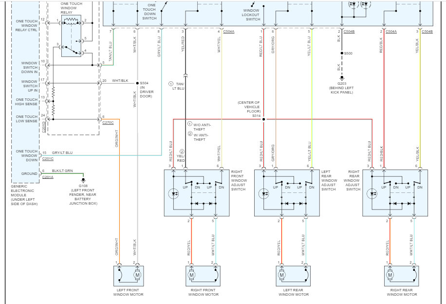

How much trouble would it be to replace the power wire that is inside the boot and goes to the fuse block? How is that wire connected to the fuse block? On the schematics that you sent, which wire would it be.
Mar 12, 2023 at 1:23 AM
  • 110,194 POSTS
If you wanted to replace the wire, it will be difficult because of where it goes, and the harness will be tied together via either a wire loom or friction tape. I suspect the wire you replaced was a light blue wire that sends the power at all times to the master switch.
At the fuse box, there will be a power supply wire out from the fuse. The wire is likely used to power other things and there are splices that are used to connect the different usages.

Does the wire that I ran have a continuous drain on the battery?
Mar 23, 2023 at 1:01 AM
  • 110,194 POSTS
It shouldn't. The circuit for the component you repaired needs to be completed for it to draw power.
Are you getting a battery draw at all times? If you are, remove the inline fuse to see if the draw stops. Or you could take a multimeter and use it as the fuse to see if there is a draw present.
