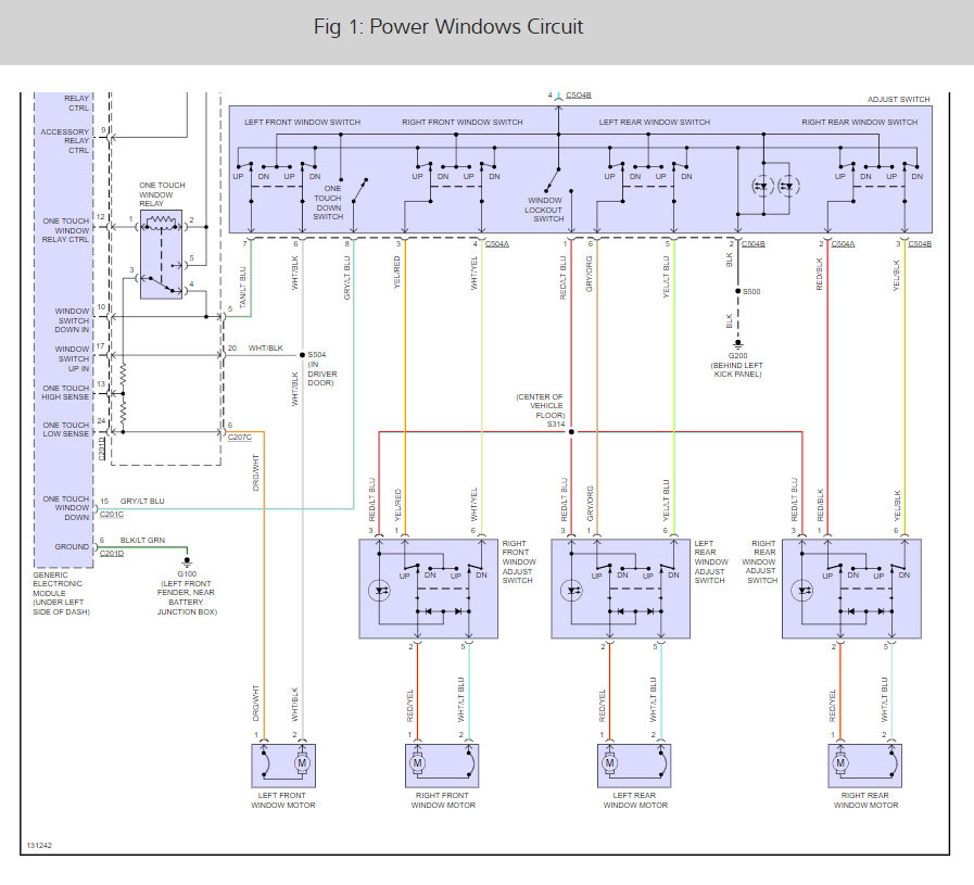

I just purchased a 2002 Ford Taurus SES at an auto auction. After purchase I realized that I could not get the drivers window to go up. None of the windows seem able to go up or down. There seems to be no other electrical problems. Radio, interior lights, rear defrost, etc. all seem to work fine. I have a manual and checked it for location of a fuse for the windows but it does not provide a location. Searching the web has turned up nothing except similar results where others have not been able to locate a fuse for the windows. I can hear a relay engage if I press the auto down on the drivers window switch but that is all. I already tried the master switch and checked fuses but nothing seems to work.
Did you ever find a solution for your problem?Any help appreciated.
Mar 15, 2008 at 11:19 PM
  • 54,840 POSTS

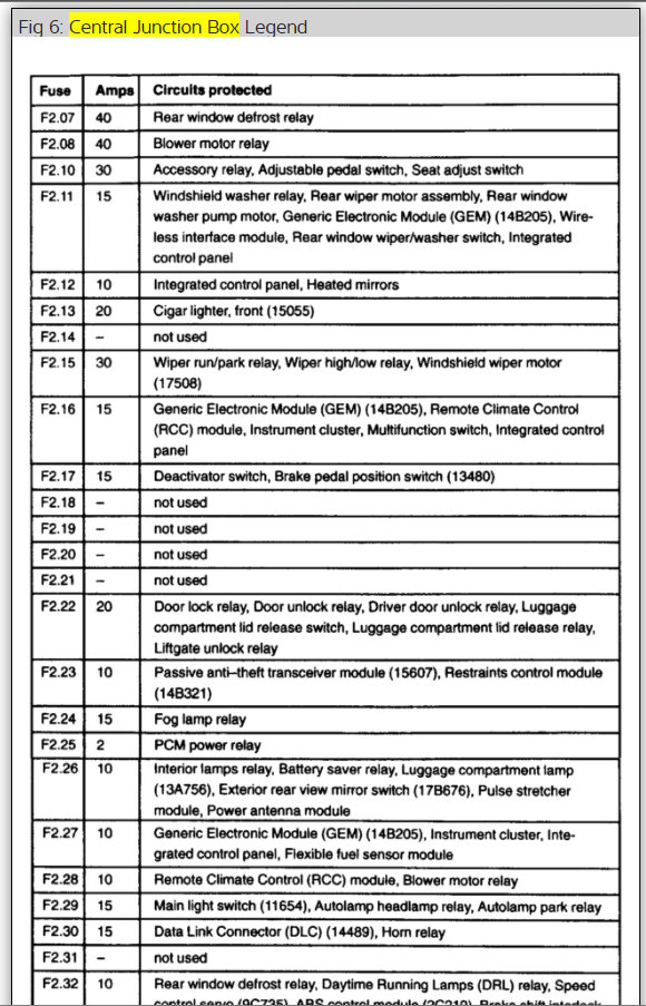

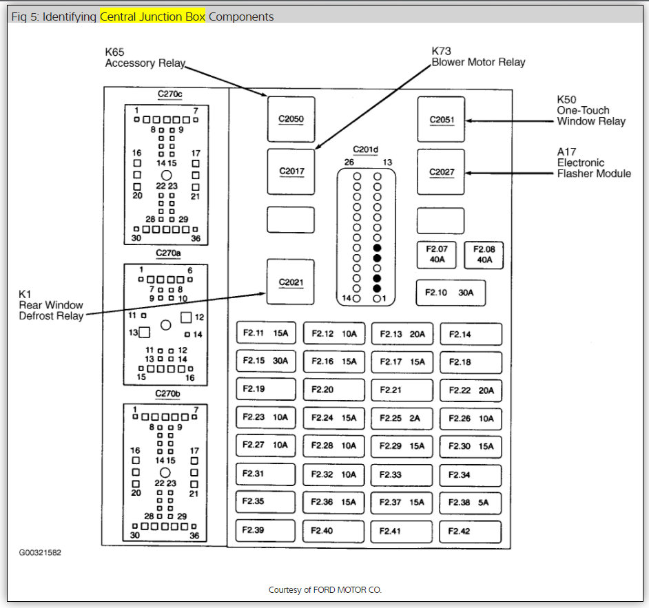

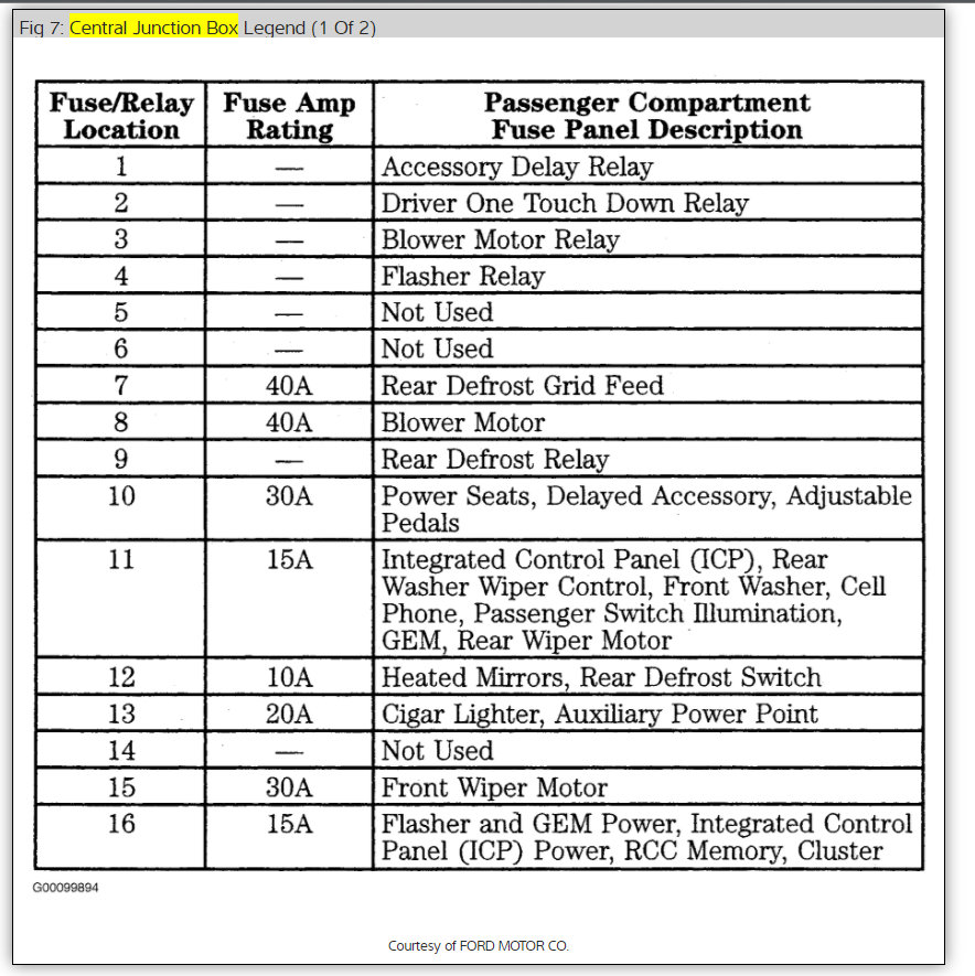

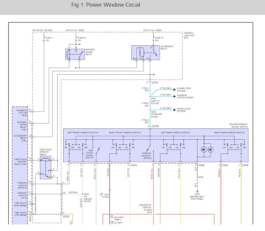

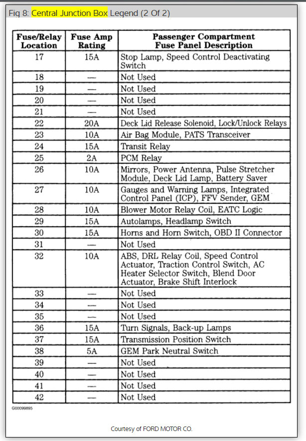

There is a one touch window relay and an accessory relay that needs to be checked and the fuses as well (10, 11 and 26). I would start by checking the fuse and if its okay try the relay. Here are a couple of guides and window wiring diagrams (below) to help you see how the system works.
and
Please let us know what happens so it will help others.

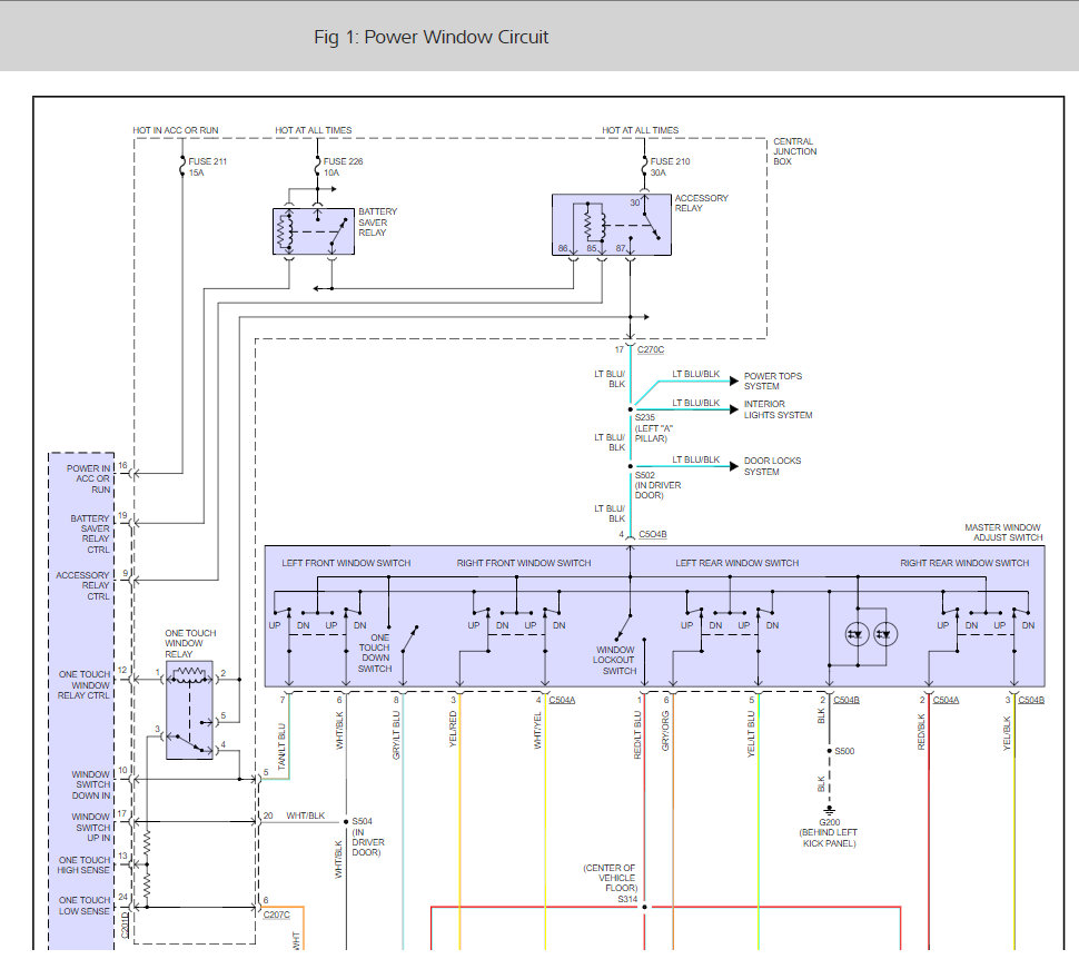

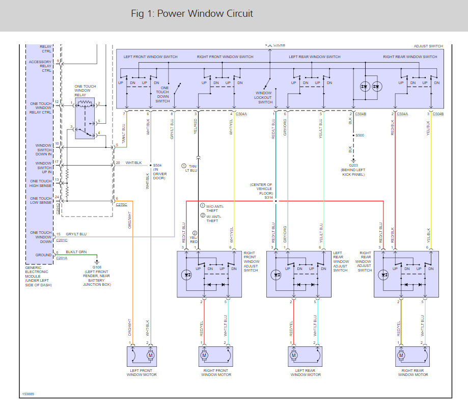

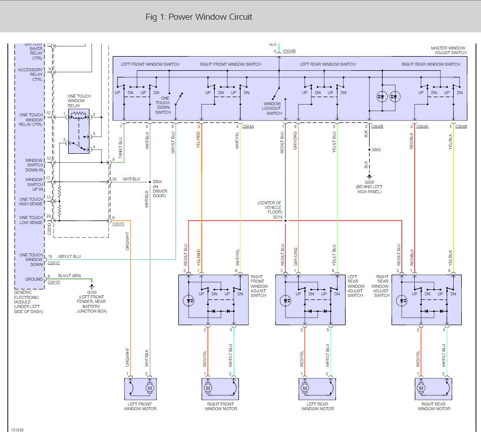

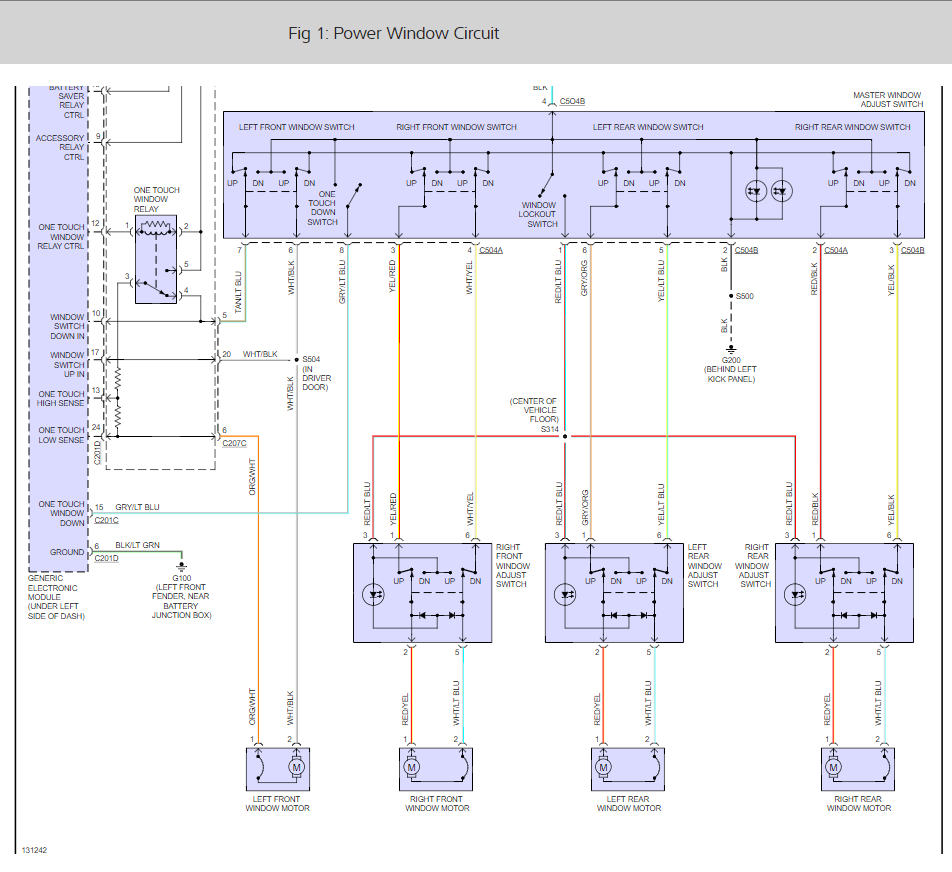

It could be the main window switch that is bad or the GEM module here is a guide to show you how to check for power so you can follow when the system losing power so you can tell what the problem is.
https://www.2carpros.com/articles/electric-window-repair
and
Here are the wiring diagrams to help you with the test and to see how the system works.
Check out the diagrams (Below). Please let us know what you find.

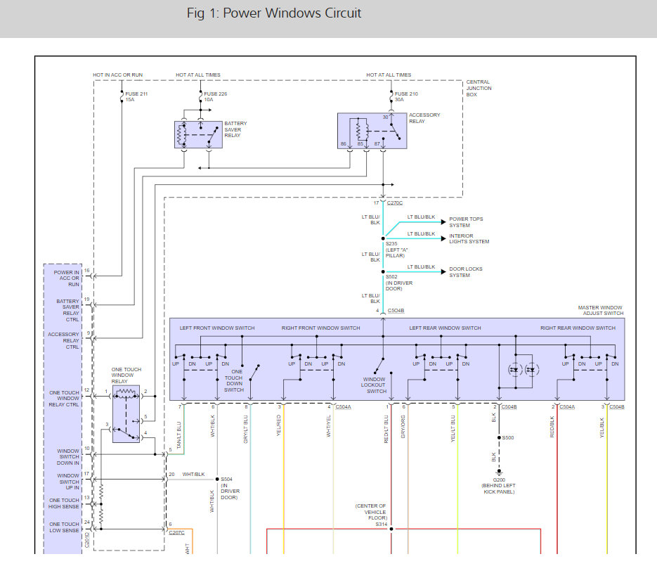

It sounds like a relay is having a problem and the switch is not getting power. Here are some guides to help you do some simple testing to see what the problem is:
There is an accessory relay that powers the system.
and
Jan 26, 2021 at 11:43 AM (Merged)

i have a problem but just with driver window it went down but now doesnt work at all .all other windows work fine ,when i press driver window button i hear a clicking noise coming from under dash i thought it would be power window relay and no it wasnt problem PLZ HELP its weird when i turn off car when i press the lock button twice and key is out of ignition i can still put any other window down until interior light clicks off
Jan 26, 2021 at 11:44 AM (Merged)
  • 75,992 POSTS
Could be the battery saver or the accessory delay relay and the generic control module under left side of I/P and also the master switch itself
