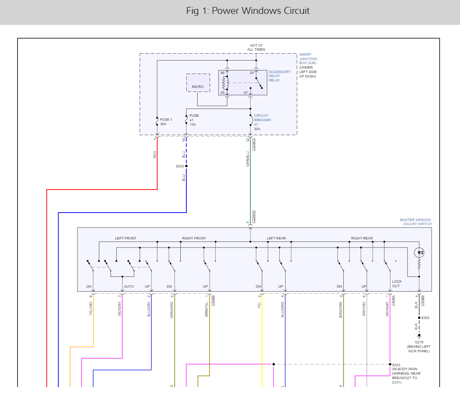

The back windows will not roll down when you press the button on the rear doors. They do have power and can be rolled up and down by the drivers control panel the window lock is disengaged.

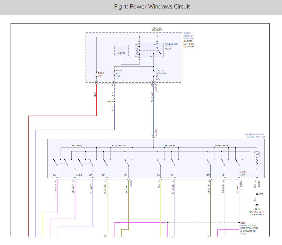

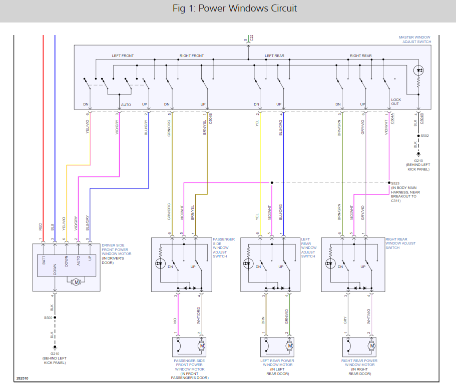

See if the master switch has a lock-out button. That intentionally prevents the other switches from working for child safety. Here is a guide to help you step by step with instructions in the diagrams below to show you how on your car.
https://www.2carpros.com/articles/electric-window-repair
Check out the diagrams (Below). Let us know what happens and please upload pictures or videos of the problem.

thanks for the guide and the diagrams it was the main window switch that was bad I love this site.

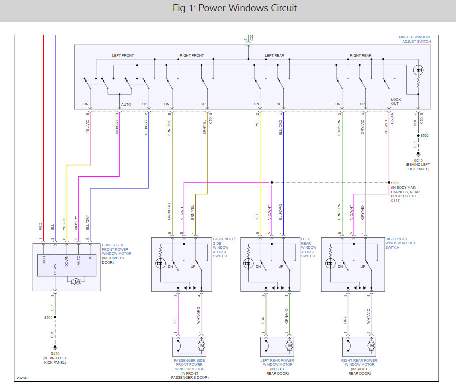

Passenger window will not go up on the car listed above SEL model with security.
According to Fig. 52: Power Window Circuit: 2002 Ford Taurus SEL
Test 1a, passenger window goes down from drivers master switch (DMS).
Test 1b, passenger window does not go up from DMS.
Test 1c, drivers window, rear right and left windows functional from DMS as well as the repsective individual switches.
Conclusion 1, Accessory Relay and Fuse good.
Test 2a, passenger window goes down from passenger side switch (PSS).
Test 2b, passenger window does not go up from PSS.
Test 3, reversed connections at PSS terminals 2 & 5 and regulator raises window from DMS as well as PSS.
Conclusion 3, Regulator operational.
Test 4, Disconnect connector at PSS and measure continuity between terminal 1 & 6. 0.004 ohms resistance (normal for my Fluke).
Conclusion 4, Good ground path from DMS terminal 4 to PSS terminal 6 and DMS terminal 3 to PSS terminal 1.
Test 5, Connector at PSS, measure voltage between terminal 1 & 6.
Test 5a, +13.5vdc detected at PSS terminal 1 when DMS passenger side down.
Test 5b, +13.5vdc detected at PSS terminal 6 when DMS passenger side up.
Conclusion 5, Power from DMS to PSS.
When the PSS is in the released state, terminals 1 & 2 are 0 ohms due that when the DMS passenger down is pressed it works.
Possibly need to measure continuity between PSS terminals 1 & 2 in the pressed state and should be roughly 0 ohms. I recall it being 0 but will check it again.
Other than that what am I missing?
Jan 26, 2021 at 3:40 AM (Merged)
  • 110,240 POSTS
The two wires that go to the switch each supply power and ground based on direction. Since they work in one direction, then we know the wiring is correct. Based on the description, I feel the break down is in the master switch itself. Something is preventing a ground path for proper operation. When you check for continuity in the switch, I have a feeling you are getting it but losing ground.
Have you trued a new switch? Have you tried switching the rear switch with the front passenger switch?
By the way, that was a very detailed analysis of the problem. You indicated little knowledge, but I don't think that's correct. LOL

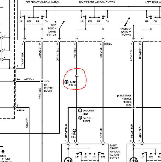

I did notice a little hiccup on the voltage. Maybe some switch bounce or something. It happens only in the one direction and just long enough for me to see it display on the multi-meter before full voltage is shown. Will swap rear and passenger from the driver master switch (DMS) some what as you said, to see if it follows. Also, on the schematic on the line from DMS terminal 3 to PSS terminal 1 there is symbol looks similar to a capacitor symbol. Is that just the connector at the driver side door shown if due to the color difference if without Anti-theft?
And thanks, I have little knowledge with cars but extensive trouble shooting skills and break down in software of all places. I figure more eyes are better and possibly someone more in the know of Fords would have a better ideal as to what might be going on. I heard their security system plays all sorts of havoc on their electronics.

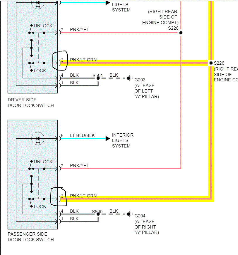

Try switching and let me know what you find. As far as the wiring, I attached a pic below of pin 3 from the driver's side to the pass side. That attaches to pin 3 also. I circled what I believe you are referring to. That is just snowing a connection.
If you have key-less entry, let me know. The schematic I'm using is for non-key-less entry.
GREY TRUCKEN
That was a door lock. This is what I am seeing and circled. And yes I have a a key fob with security.

Sorry about that. I am dealing with several power lock issues. As far as the symbol you see, that isn't a capacitor. A capacitor will either be two straight lines or one straight and one curved based on if it is polarized or not.
GREY TRUCKEN
Yeah, that is what I expected on both counts. So what is it? A lone connector some place?

Yep, that indicates a connection being made.

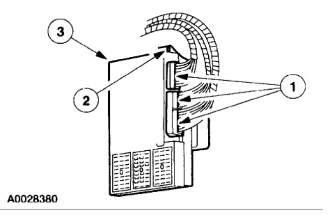

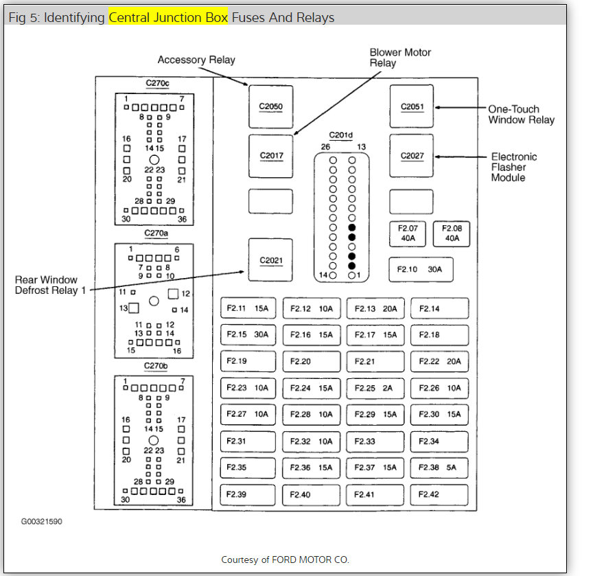

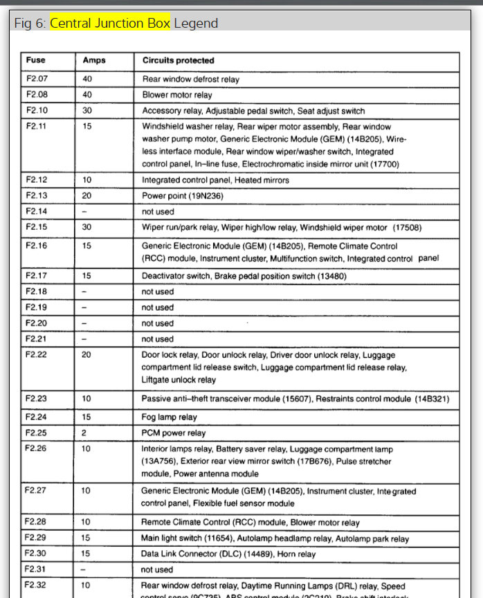

There is a fuse f2-16 that runs the GEM module that controls the dome light and the window power. Here is a guide to help you check for power at he fise when you find it by following these diagrams below.
Please let us know what you find. We are interested to see what it is. HEre is what the GEM looks like under the dash as well. Check out the diagrams (Below)
MELISSAA
My Car does not tell me where fuses are located i have no owners manual & there is nothing on cover but numbers & yes i have power mirrors problem started when dome lights would not turn off removed first bulb when removing second bulb all went out & windows stopped working I checked all of the fuses and they are okay so I replaced the GEM module and that worked thanks 2Carpros you guys are great.
