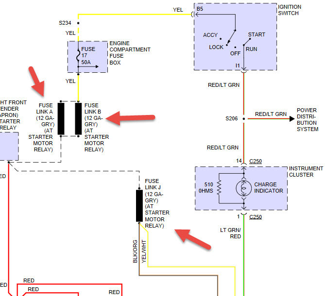

I have a 1999 F250 5.4L, it will not charge I bought a new altenator and I had it tested before I left, it tested good, but it still will not charge. I checked the fuseable links one was corroded bad and I replaced it and still it will not charge. Please help. Thanks

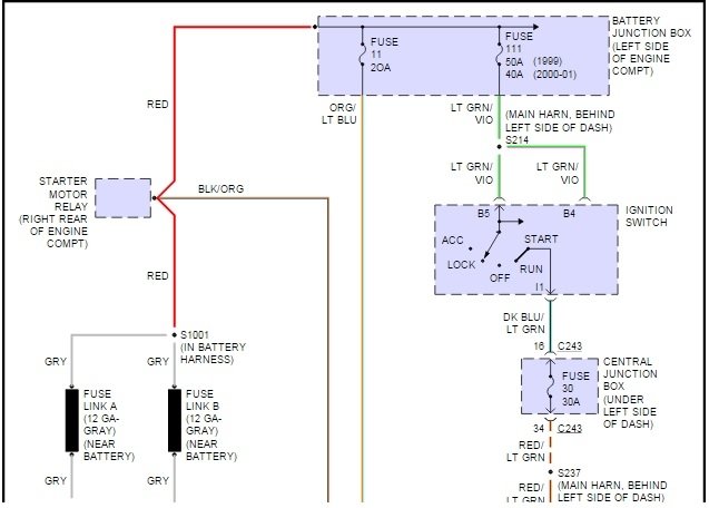

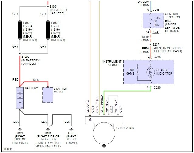

Here is a diagram of the charging system from "prodemand"
i had to make two screenshots to get the diagram
they overlap- the first is the top half and the second is the bottom half.
This shows "the works"-fuses-components-locations!
Let me know if this helps
the medic

Hey medic thanks, I will check the other fuses, but I was told that the plug on the back of the alternator can go bad. What do you think?

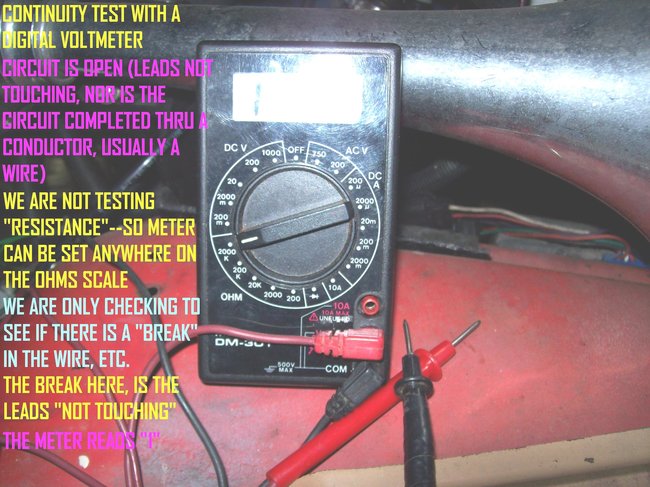

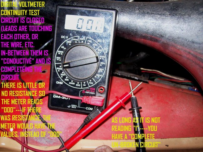

You can run a continuity test through them
if you can find the other end of the wire
or simply stick a "straight pin" through-into the insulation in various places of the wire. One lead to the connector pin/ spade etc. The other lead to the "pin" or other end of the wire. If there is a break, the "ohms" won't show on the meter.
Harbor freight has decent digital voltmeters for about $5
these pictures were made back/ when I first started computering (i' m an old dog, cyber box was a new trick six years ago) maybe you can understand my definitions on using the voltmeter.
Take your battery loose first!
The medic

Let me add to this. There are three fusible links and a fuse that can effect this check those with test light or volt meter. It should be same volts on both sides if not the link may be bad, also, if it does more at low rpm check belt and tensioner as replacement for both is suggested at 60,000 miles as the tensioner loses tension and belt will wear. Do not go by cracking on belt it needs a gauge to measure it. If this is a 215 amp alternator then there is a difference and get back to me.

Check the links I supplied in reply. Unless this is a 215 amp alternator, if it is there are more fuses.
