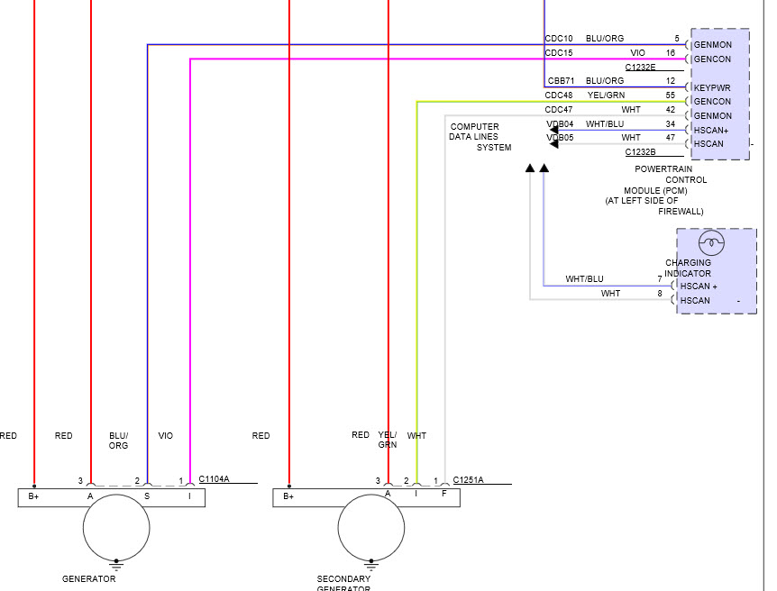

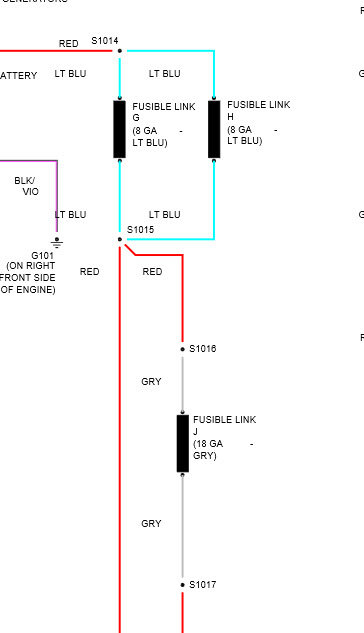

6.4 powerstroke single alternator plug burnt and I don't know the color order to wire in the new pigtail.
Jan 30, 2016 at 11:28 AM
HMAC300
  • 48,601 POSTS
see pics you MUST put the fusible links back in to prevent any other damage.
