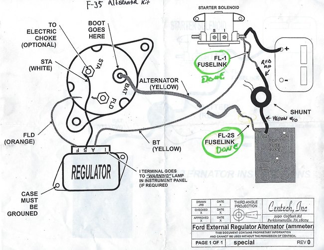

This has a new Centech wiring harness installed with an AMP meter Shunt incorporated with the wiring harness. The Alternator and the external regulator are new. All wiring has been rung out to verify continuity and checks good; and the alternator is well grounded. When running, the alternator shows twelve volts. When electrical load is applied the voltage drops to eleven volts. I am at a loss here, please help.

- I have tested all the alternator, regulator and starter solenoid's associated wiring for continuity, and it all checks good. Thus telling me the fusible links are good.
- I have attached a scan of Centech's wiring diagram for the alternator for your reference.

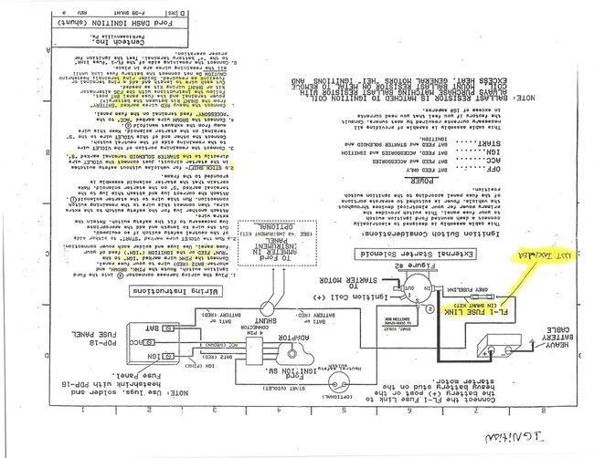

- I have attached Centechs ignition wiring diagram for reference.
- If Centechs wiring diagrams were better integrated between the ignition and alternator systems perhaps it would be easier to troubleshoot.

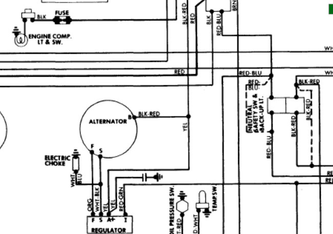

ok thanks but like I said before the amp guage and lite are both wired different on a factory setup so i'm assuming you have a lite to begin with as ford amp gauges were for crap back then

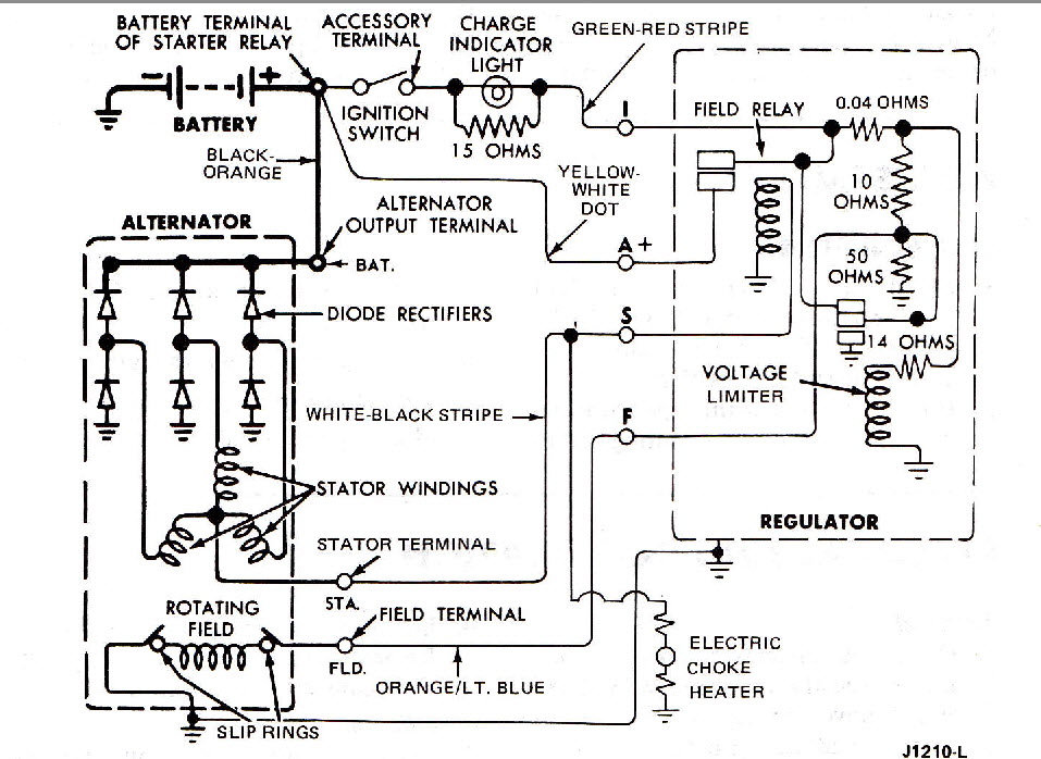

Centech informs me they have seen this problem before usually on older Bronco's.
They said the Alternator is not putting out enough voltage to signal the regulator to ask for more voltage from the alternator.
They told me to run a wire from the ACC buss in my fuse box to the alternator's "S" terminal.
Doing so will effectively provide 12v to excite the Regulators "S" terminal only when the ignition switch is in the run position.
Seems kinda hoaky to me, but I'll give it a go and see what happens.

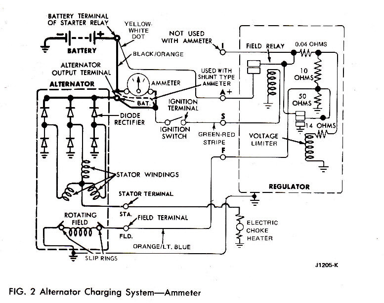

A retired Ford mechanic tells me that Ford did in fact run a switched 12v wire to the "S" terminal on the voltage regulator.
I checked the old wiring harness I removed from the truck, and could not find evidence that my truck was wired that way.
I'll have to decide where to run the switched 12v wire to.

Problem resolved....
I removed the Stator wire between the alternator and voltage regulator.
I then ran a wire from the ignition buss in the vehicle's fuse box to the "S" terminal on the voltage regulator.
Luckily the new Centech fuse box had several extra fused terminals on the ignition buss. I simply wired into a 15 amp fused terminal & ran the wire to the voltage regulator's "S" terminal.
I fired up the truck and the alternator was charging as advertised at 14.3v.

I thought the one diagram I sent to you showed the wire going to the s terminal on voltage regulator. least it's fixed that's the important part.
