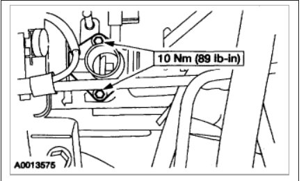

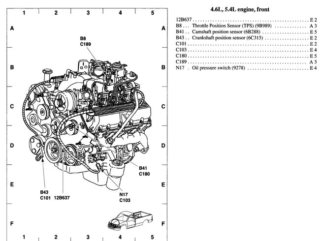

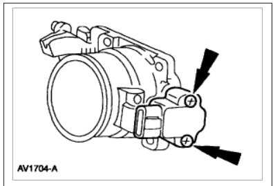

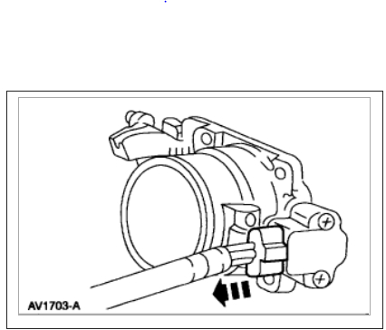

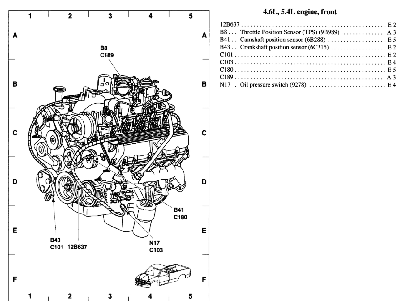

What is a TPS sender and where is it located at? I had it checked and all I got was a oxygen sensor was bad which I replaced were is the tps.
Apr 8, 2018 at 5:45 AM
  • 54,837 POSTS
The TPS can cause all kinds of problems here are diagrams to help you get the sensor replaced.

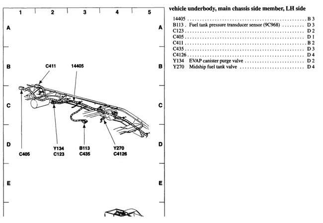

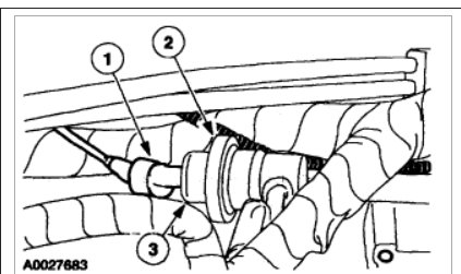

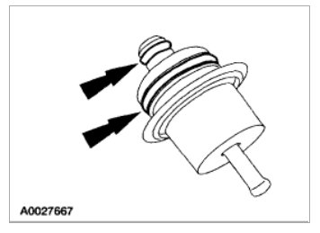

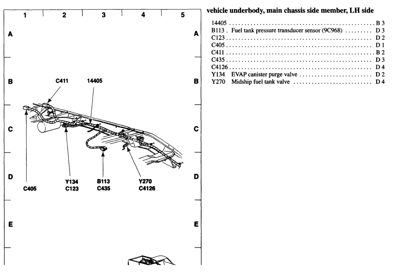

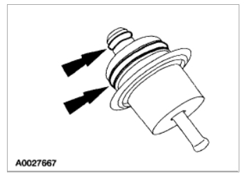

Where is the fuel injection pressure regulator on my truck and where is the fuel pressure sensor? help please. thank you
Apr 24, 2018 at 2:05 PM
CARTER SPARKS
  • 33 POSTS
It runs good until I put it in gear.
Apr 24, 2018 at 2:12 PM
  • 54,837 POSTS
When you put it in gear does it stall immediately? Like bang stalled or does it take a few seconds. Here is the fuel pressure regulator location which looks like its on the fuel rail and the fuel pressure sensor location as well.

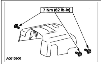

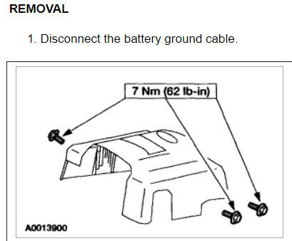

Can you take a video of what the engine is doing so I can see? Have you looked at the IAC motor. I would try that next.
https://www.2carpros.com/articles/how-to-replace-an-idle-speed-control-motor-iac
Apr 26, 2018 at 4:16 PM
CARTER SPARKS
  • 33 POSTS
Ken, I do not know how to take a video. Is the IAC motor? Is it a dealer part?
Apr 29, 2018 at 4:47 PM
CARTER SPARKS
  • 33 POSTS

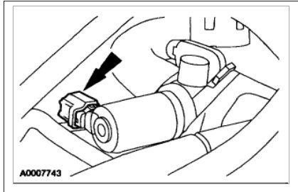

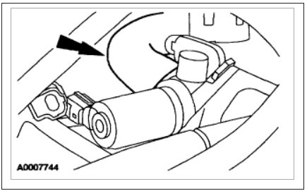

I cannot find it. Can you help? Thank you.
Apr 29, 2018 at 4:49 PM

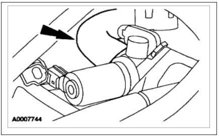

  • 54,837 POSTS
Yes, it is under the engine cover. here is its location.

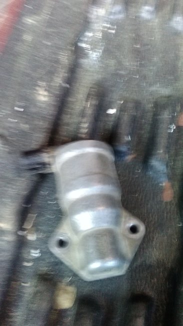

Ken, the idle air control motor that is in the throttle body is it a dealer part or can I get it elsewhere? I cannot seem to find it.
May 1, 2018 at 2:38 PM
CARTER SPARKS
  • 33 POSTS
I have replaced this no help. I do not know where to go from here. Can you help?
