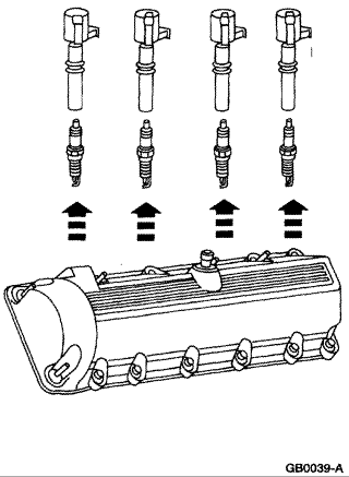

Is there spark plugs and wires on a 1998 ford f150 5.4 engine if so how do you get to them
Tuesday, December 15th, 2020 AT 3:38 PM (Merged)
  • 75,992 POSTS
Remove the Coil On Plug (COP). Remove the screw and the coil for each plug.
TONY.HARDEN
How difficult is it to change the plugs seems to be alot of stuff in the way I was wondering also does the EGR valve gradually go bad or is it all at once the engine has a miss in it at an idle when driving down the road it kinda chugs till you step on the gas then it quits till you let off the gas and go to get back on the gas it chugs again thanks
