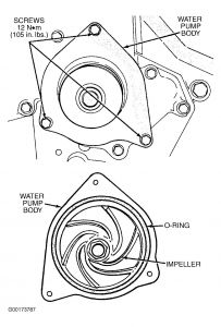

I need to replace the water pump and timing belt on a 1997 Dodge Intrepid 6cyl. 3.5L MFI.
I am not sure if my car needs a water pump with 3 mounting holes or 6 mounting holes.
I have not been under the hood and I am having a friend fix my car for me. How do I know which type of water pump I need?
Dec 19, 2018 at 9:39 AM (Merged)
BMRFIXIT
  • 19,053 POSTS
this is what my book show for 3.5 l
https://images.2carpros.com/forum/automotive_pictures/99387_35_6.jpg

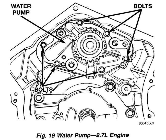

I have a 2002 dodge intrepid with a 2.7 engine and the water pump needs replaced. Is it true that the engine has to be removed to do it and it will take 5 hours to do it. Please advise. Thanks.

[quote:fa84285d40="jilliek6"]I have a 2002 dodge intrepid with a 2.7 engine and the water pump needs replaced. Is it true that the engine has to be removed to do it and it will take 5 hours to do it. Please advise. Thanks.[/quote:fa84285d40]
Hey Jill,
As I read the procedure, its basically a timing chain removal to get to the water pump. Will be happy to send along the procedure and pics if your doing it yourself. 5 hours is a good # for the job, but looks like the motor stays in the car! Let us know!

CARFAN28
Engine Cooling problem
1997 Dodge Intrepid 6 cyl Front Wheel Drive Automatic
Can I please get a diagram of a 1997 Dodge Intrepid base sedan 3.5L MFI 6cyl. please?
I don't have the money to order or buy one of those expensive auto books right now.
I really need to see if I need a water pump with 3 mounting holes or 6 mounting holes.
BMRFIXIT
  • 19,053 POSTS
best take the timing cover off and check book don't show if 3 or 6 bolts
as is you need to replace it
