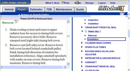

I would like to know how hard it is to change the water pump in this model of car. My girlfriend was quoted around 400 dollars by a mechanic, but if it will save us the money I would like to give it a try. Any help will be much appreciated.

Drain the cooling system-Remove timing belt see below
https://www.2carpros.com/forum/automotive_pictures/12900_timing_belt_8.jpg

Would this be too hard of a job for someone without a lot of car repair experience?

If you got determination you can do it-my advise is just bring her in
