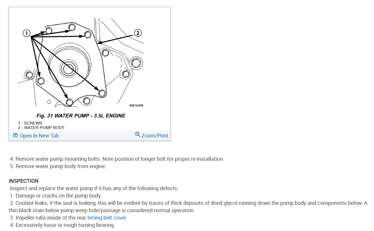

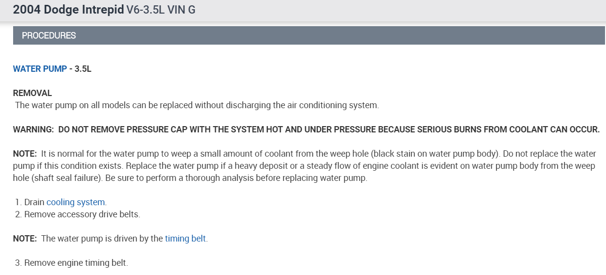

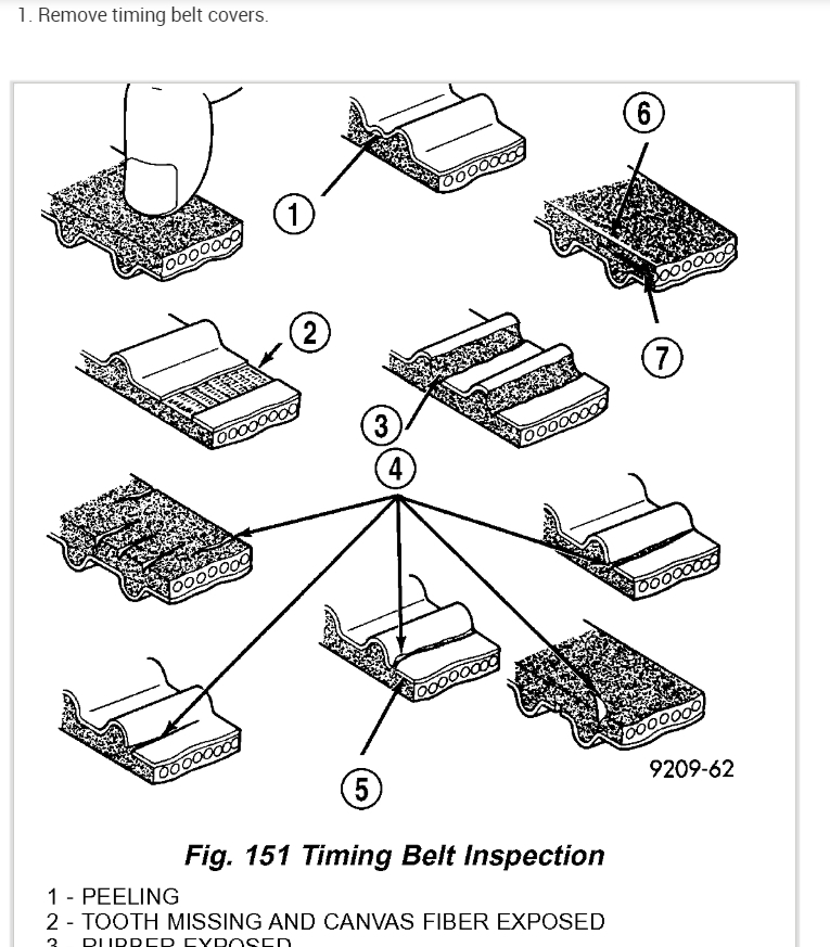

How is the best way to change the water pump on this car and can you recommend a website with video of the process?
Oct 19, 2009 at 1:46 PM
CARLIFE65
  • 200 POSTS
Here is a guide that will walk you through the steps with instructions on how to do the job on your car in the diagrams below. Your will be more involved because you will need to replace the timing belt as well.
https://www.2carpros.com/articles/water-pump-replacement

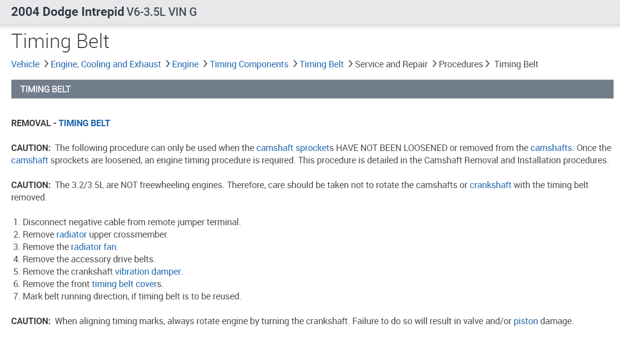

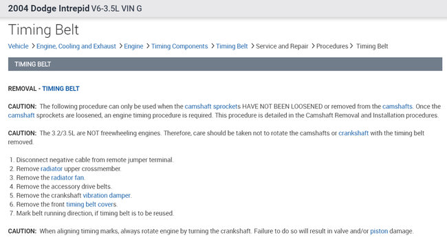

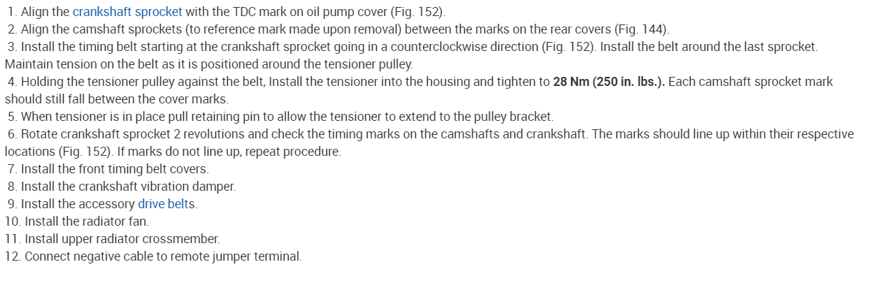

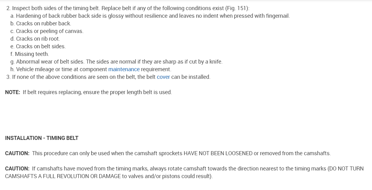

SCHLOEMANR
The engine keeps jumpping the timing. I have had the Tensioner replaced twice. The Oil pump has been replaced. The water pump has been replaced and I just put a brand new timing chain on. Just wondering if you may have a direction to lead me in cause it cranks but will not start.
Sep 3, 2019 at 2:05 PM (Merged)
  • 110,194 POSTS

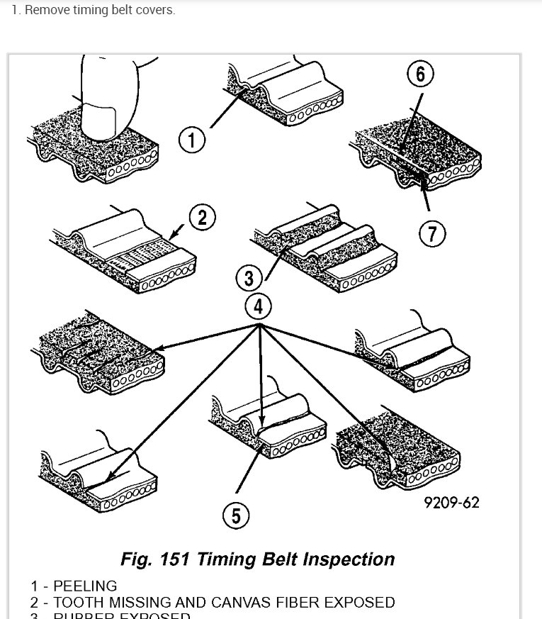

Is the belt actually breaking in half or is it getting damaged such as a tooth, cracked...? As far as timing, go to this site:
https://www.2carpros.com/diagrams/dodge/intrepid/2004
joe

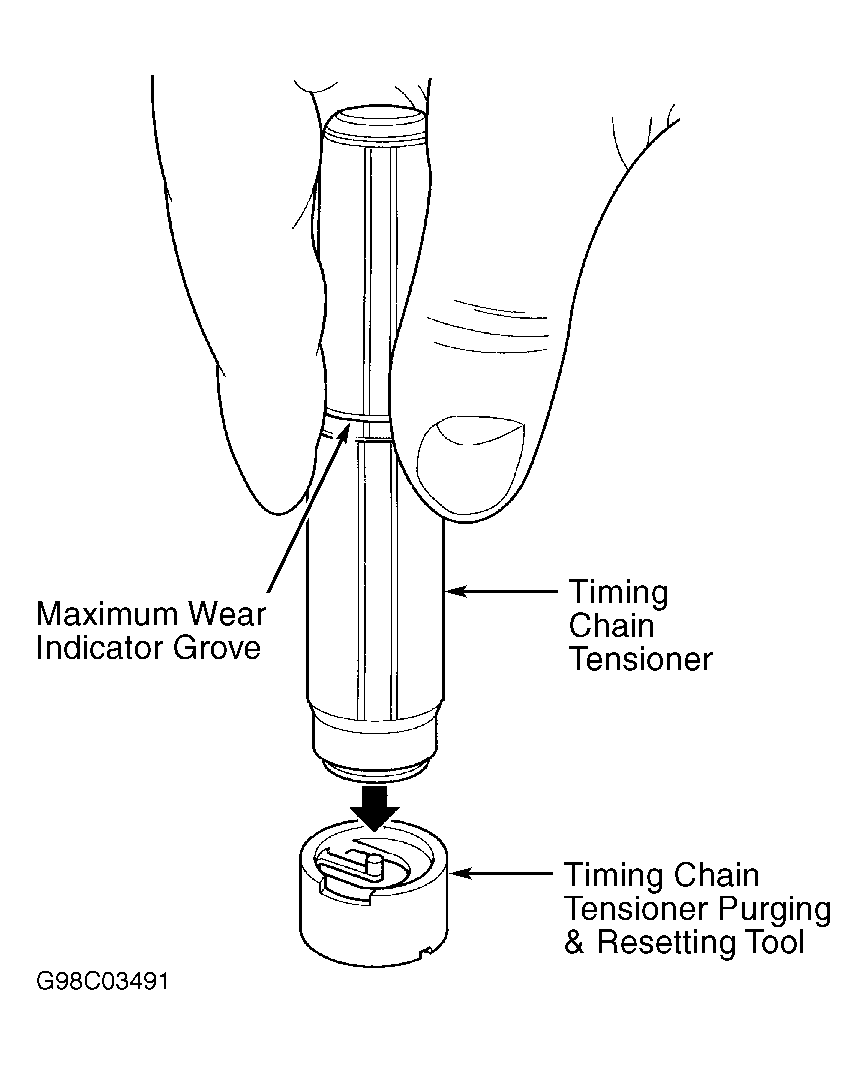

PAUL 1948
I had the water pump replaced on a 2002 Dodge Intrepid 2.7; 98,000 miles. The mechanic said the tensioner and timing chain were OK; engine clean no sludge.
After the repair with new pump, thermostat, plugs and oil change. I am getting a tapping/clicking sound from the engine; that was not there before.
I called the mechanic back and he said it was nothing to worry about. The chain just may need to seat with the water pump. He is supposed to be very knowledgeable with this engine; but dosen't sound right to me.
It only seem to start tapping/clicking; after the car has been driven and warms up. I don't want to pay the Dodge dealer $1600 to go back in; if it;s not necessary. Any suggestions? Thanks

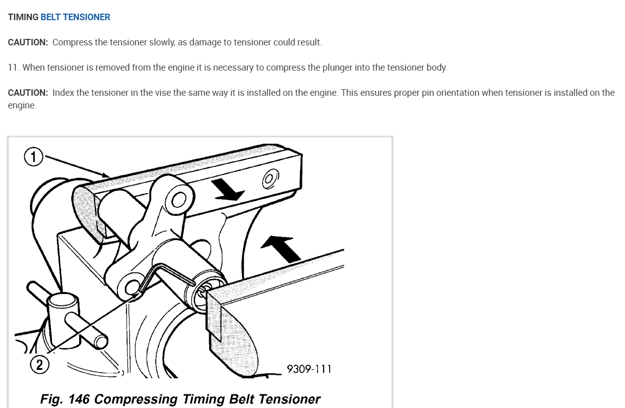

DOCFIXIT
  • 18,828 POSTS
Ask if he reset tenisioner see diagram This will be a belt driven engine according to Mitchel 1 there will be no bed in for a belt drive and the water pump, the click may be lifter noise, I would just want to know the hot engine oil pressure, although a faulty timing belt tensioner can make the belt to flap and this may be a similar noise, the mechanic should re check his work to make sure.

PAUL 1948
Thanks for the quick reply. When I ask I ask about; replacing the chain, guides, cams and tensioner; he said the old ones were fine and the tensioner was strong.

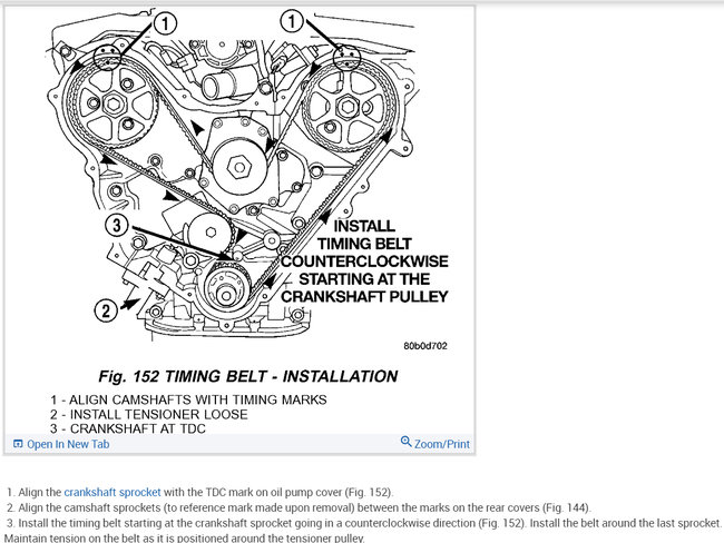

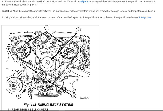

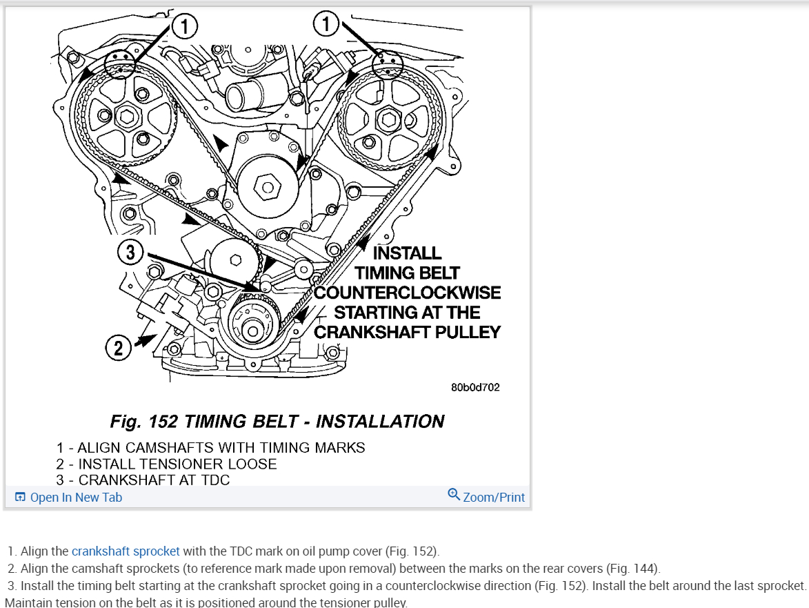

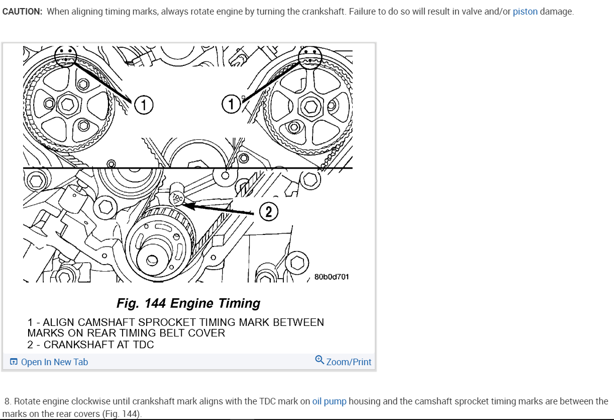

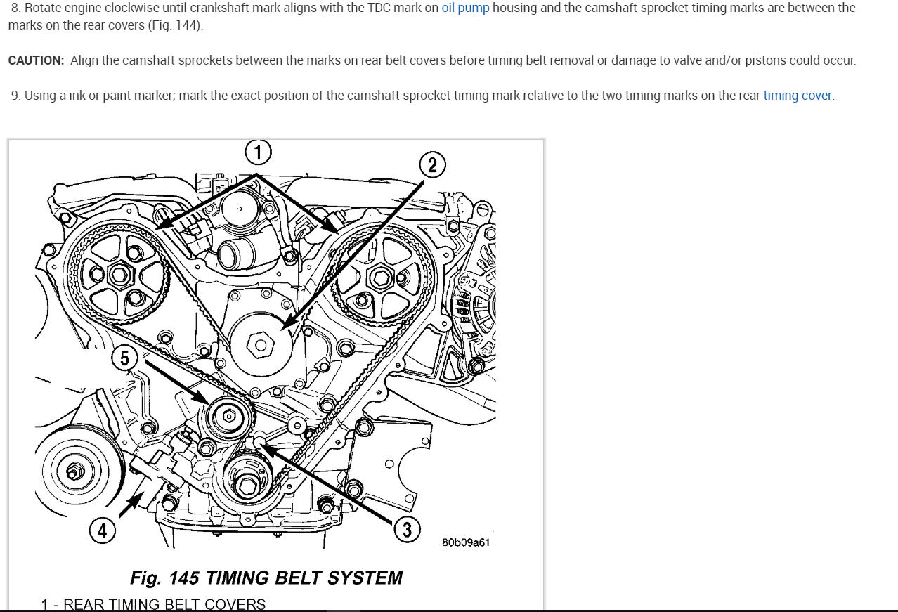

OSTEVEO
i put a water pump in this thing yesterday and now it wont start i think i might have gotten the timming chain on wrong here is the problem their is only timming marks on the right sprocket and head and nothing on the left if i were to take the engine back apart how do i realine the timming
  • 110,194 POSTS
Here is the diagram. Let me know if it helps.
https://www.2carpros.com/diagrams/dodge/intrepid/2002

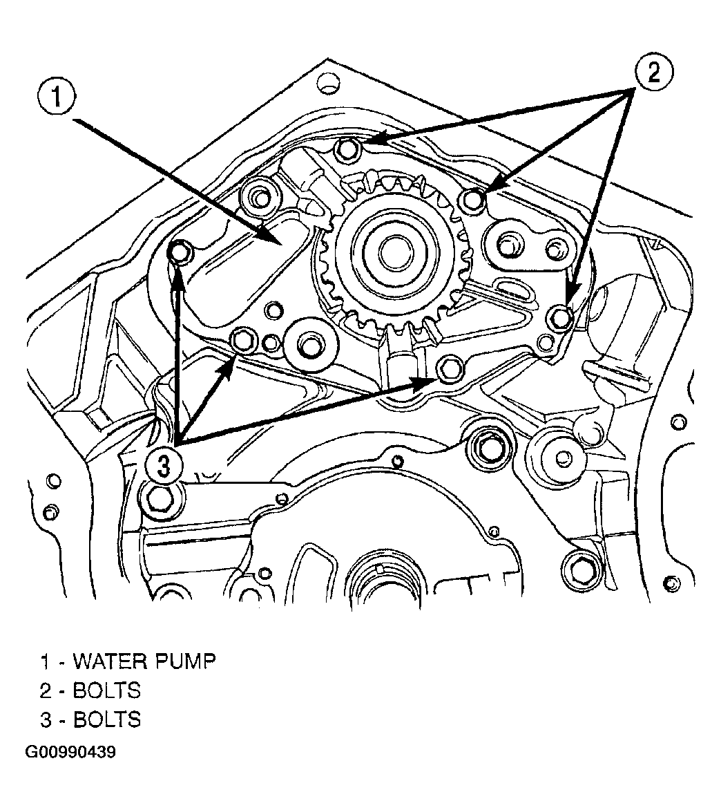

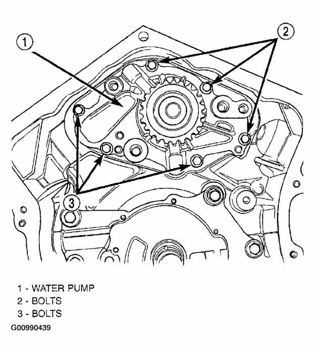

ERNIEBURGER
Would like details about installing a water pump in a 2002 dodge intrepid

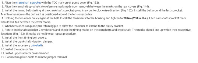

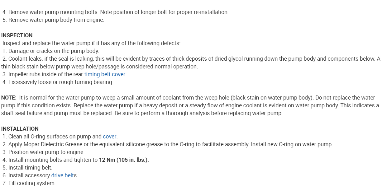

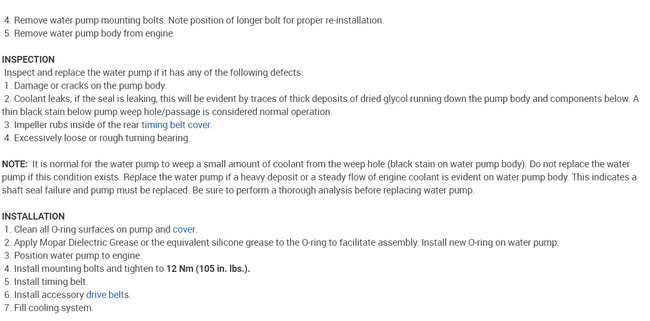

  • 75,992 POSTS
REMOVAL
The water pump on all models can be replaced without discharging the air conditioning system.
NOTE:It is normal for the water pump to weep a small amount of coolant from the weep hole (black stain at weep passage). Do not replace the water pump if this condition exists. Replace the water pump if a heavy deposit or a steady flow of engine coolant is evident on side of the cylinder block from the weep hole passage (shaft seal failure). Be sure to perform a thorough analysis before replacing water pump.
WARNING:Do not remove pressure cap with the system hot and pressurized. Serious burns from coolant can result.
Drain cooling system. (Refer to STANDARD PROCEDURE - COOLING SYSTEM DRAINING )
Remove radiator upper crossmember.
Mark bolt locations on the radiator upper crossmember.
Remove bolts attaching windshield washer bottle and speed servo, if equipped. (Refer to Fig. 41 .)
Remove headlamp jackscrews both sides.
Remove fasteners attaching upper bumper fascia.
Remove bolts attaching the upper forward edge of upper radiator closure panel.
Remove bolts attaching upper radiator closure panel
Disconnect hood latch cable from hood latch.
Remove upper radiator closure panel from vehicle.
For replacement of upper radiator upper crossmember, remove hood latch, and any other hardware.
Remove radiator fan. (Refer to RADIATOR FAN ASSEMBLY )
Remove accessory drive belts. (Refer to DRIVE BELTS - 2.7L )
NOTE:The water pump is driven by the primary timing chain.
Remove the timing chain and all chain guides (Refer to TIMING BELT/CHAIN AND SPROCKETS ).
Remove bolts attaching water pump to block (Fig. 56 ).
Fig. 56: Removing Water Pump (2.7L)
Courtesy of DAIMLERCHRYSLER CORP.
Remove water pump and gasket
