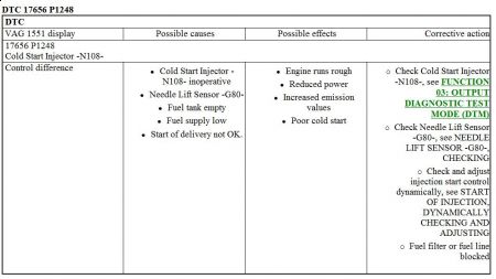

Hi DLD2206,
Thank you for the donation.
P1248 is a fault with the cold start injector system and can cause the non starting.
https://www.2carpros.com/forum/automotive_pictures/192750_P1248Jetta02_1.jpg
To diagnose the problem, diagnostic tools VAG1551 or VAG 1552 with cable VAG1551/3 is required.

Thanks for thinking it over, but I was able to get the car started. Here's what it came down to (I think) --
The fuel injectors were really clogged up. I changed them and it fixed the problem. However, I didn't bleed the fuel lines enough before tightening up the injector lines. Once I bled them again, it started. The car has a lot more power now and doesn't smoke nearly as much.
The P1248 code has also disappeared, so maybe the clogged fuel nozzles were the culprit in that problem too?
