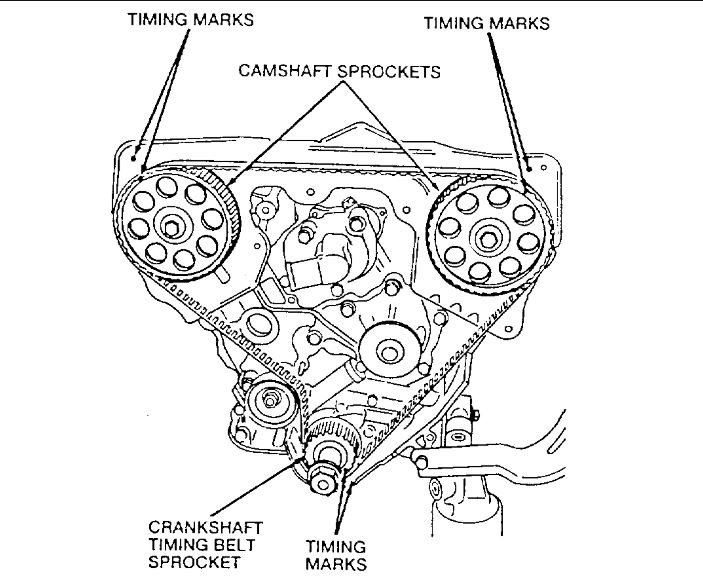

Driving down the road and my van literally shut off in the middle of the road. There is 3/4 tank of gas in it. I knew it was not that. I pushed it to safety. Would not restart. I checked fluids had it towed where I then replaced the ignition coil seeming I saw no sparks logical thinking, then I changed the fuel filter and pump. Still nothing. It acts like it wants to turn over but it is not pulling fuel. Any thoughts on repair?
Oct 4, 2018 at 1:29 AM
Good morning.
The first thing I would check is the compression. You may have a failed timing belt which would cause this exact issue.
https://www.2carpros.com/articles/how-a-timing-belt-works
