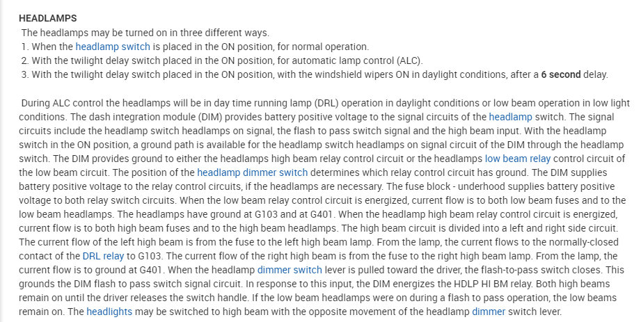

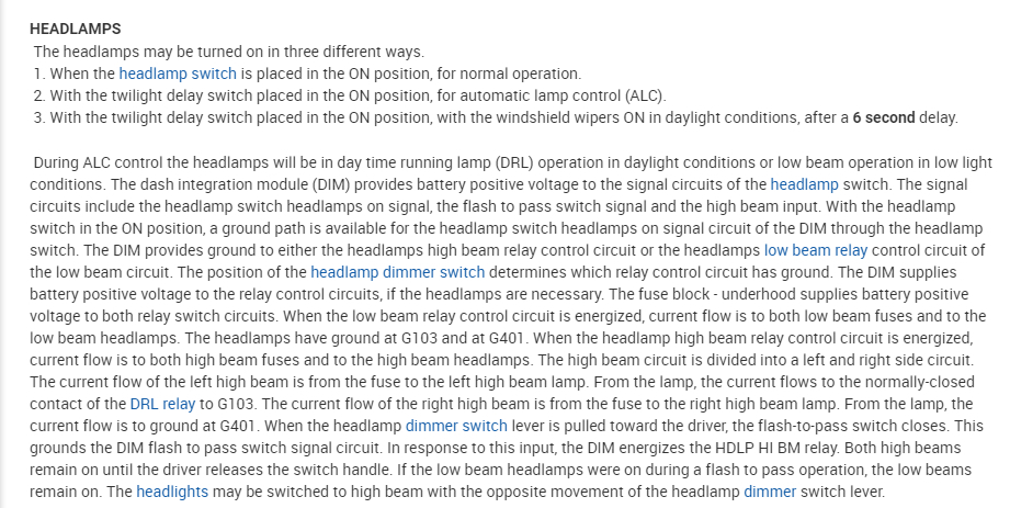

Just so I am clear, the lights stay on when this switch is on or off? So the head lights stay on when the key is on no matter the position of the headlamp switch? Take a look at this info and let me know what you think.

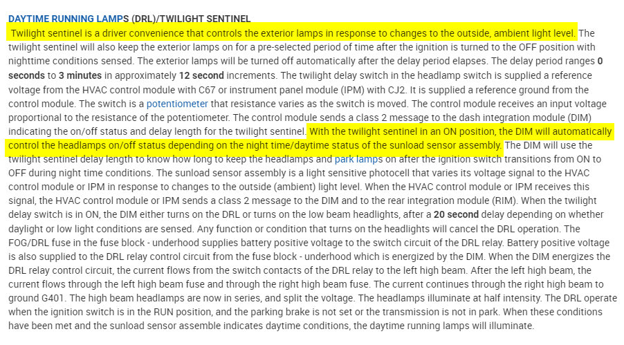

Maybe I am not understanding the issue but this explains the operation of this system so let me know what position you have each switch in and that will help determine what the issue is.
Mar 5, 2020 at 7:30 AM
