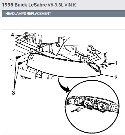

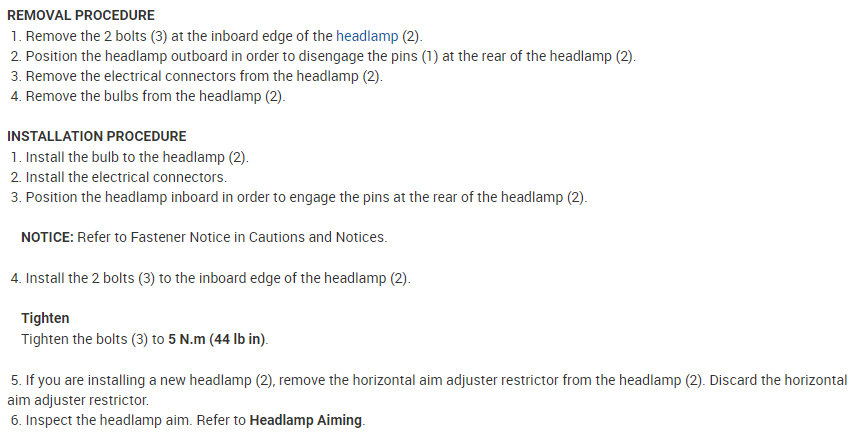

How do I remove the light to get to the bulb and which is high and which is low?

Here is the information you requested. This is a tutorial for you to view on how to replace a headlamp bulb:
https://www.2carpros.com/articles/how-to-replace-a-headlight-bulb
I've attached picture steps below as well on how to replace headlamp bulbs on your vehicle. The inner bulbs are the HI-Beam. The Outer bulbs are the Headlight. Hope this helps and thanks for using 2CarPros.
