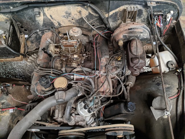

The vehicle was rewired a few years ago and ran fine. For the most part everything else is stock. With the main exception being the gas tank was replaced with a fuel cell some time ago.
Not sure if this is related but I figured I should mention it. The last time the jeep ran (2-3 years ago) it had a hard time holding idle, even after warming up.
Currently when you turn the key it tries to start but never fires up.
Things that have been tried:
Added fresh fuel
Checked for spark (got spark)
Replaced all of the spark plugs
Sprayed carb cleaner directly into the carburetor
Possible next things to try:
Replace distributor cap
Checking ballast resistor
Checking coil
Unfortunately the vehicle is not close by so I can only work on it on the weekends.
Any advice would be greatly appreciated!
Thank you

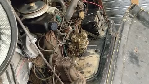

Turns out, no spark. So I'm guessing distributor cap replacement?

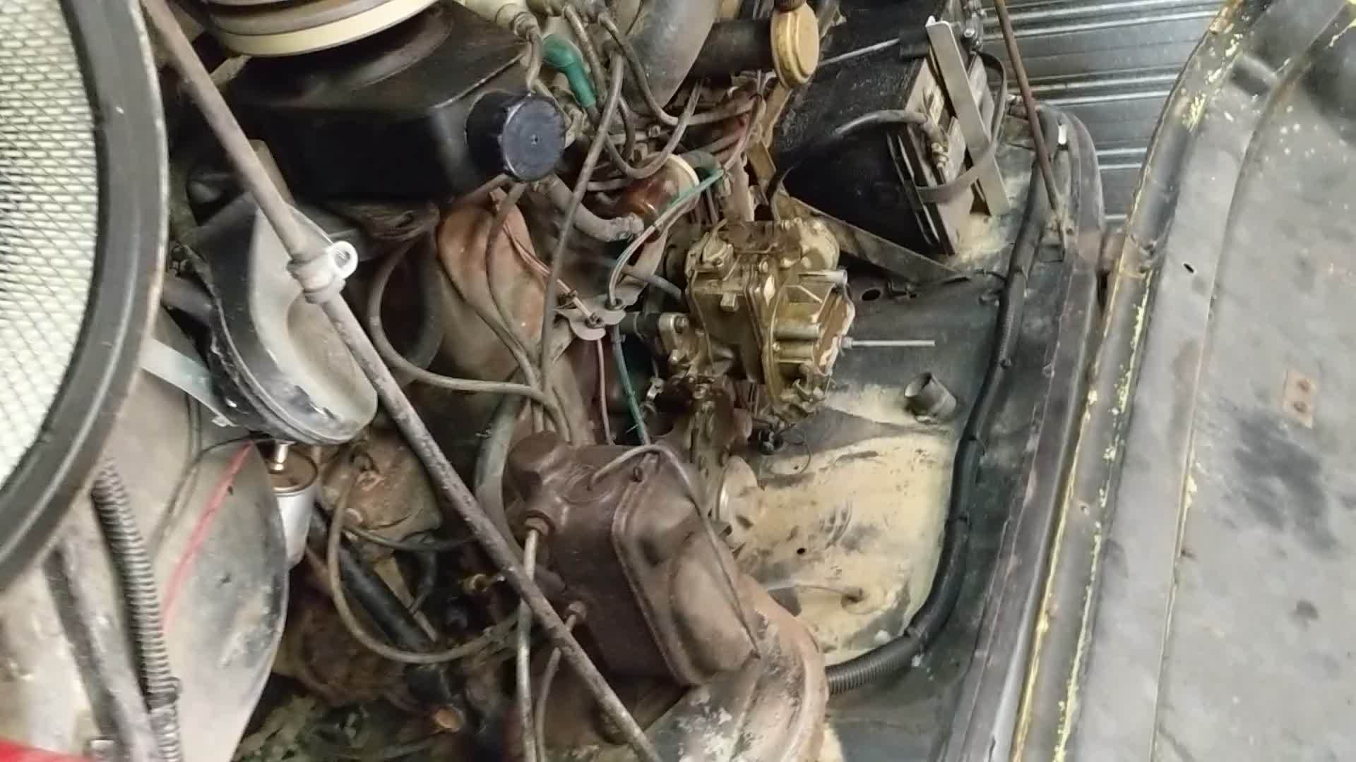

The video I added is of it trying to start..
Sep 19, 2021 at 7:04 AM
  • 110,248 POSTS
Normally, the distributor cap won't prevent all cylinders from firing. I listened to the video you attached and there isn't so much as a burp indicating spark.

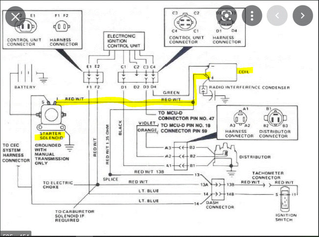

  • 110,248 POSTS

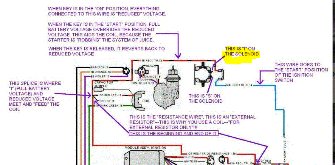

If you have power to the coil and ground, the next suspect would be the ignition control module. If there is no power at the positive side of the coil with the key on, then we need to go to the starter solenoid and ignition switch to see if there is power available at the red wire with a white tracer.
I attached a schematic I got online for you. Let me know if this helps you or if you have other questions.
Let me know what you find. Also, please feel free to let me know if I can help.
See pic below.

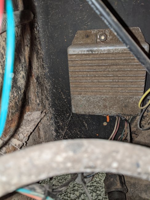

Just got done with the Jeep. There was 12v between the coil and ground. I wish I could work on the Jeep more frequently, it's just too far away for me to do so. Appreciate your help and patience.
I added a picture of what I believe is the ignition control module. I also added some exterior shots to give you an idea what this beast looks like, haha.
Sep 26, 2021 at 5:49 AM
  • 110,248 POSTS
I like it. That looks like it could be a lot of fun. As far as the ignition control module, that's it.

When you checked for power at the coil, you had power with the key in the run position. By chance, did you check for power when the key was in the start position? The test light should be brighter when cranking. If you did try this and there was nothing when cranking,
then you have an issue with the wire between the starter relay 'I' (Ignition) terminal and the ignition coil.
Next, to check the control module do the following:
Connect the wire of your test light to the positive battery terminal.
Probe the 'Green' wire terminal at the coil
With the key in the run position, you should get a strong, steady bright light.
While cranking the engine, you should get an even blinking/flashing of the light.
If you don't get the steady light when the key switch is in the run position, there is a problem with the ignition module ground circuit.
If you don't get a flashing/blinking light when cranking the engine, any of the following can be the cause that requires further diagnostics.
No trigger signal from the distributor.
Damaged or corroded connections from distributor to module.
No power to the control module.
Faulty module which is common on these vehicles.

I unfortunately did not check for power at the coil when the key was in the start position (I was alone and couldn't physically do it.)
Checking the control module:
Connected wire to positive battery terminal, probed the 'green' wire at the coil.
I got nothing. (Unable to test while cranking)
I went ahead and replaced the ignition control module, which didn't help either. The ground wire for the control module was between the interior fender wall and the control module. The new module mounts with 3 holes while the old one had 2. When I installed it, I only had the bottom bolt installed with the grounding wire in place. If I end up keeping this module, I'll have to drill 2 new holes.

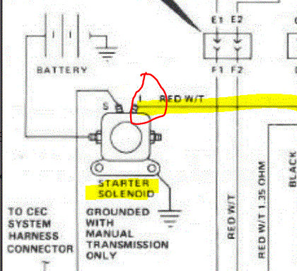

However, that is where I'm questioning if spark is lost, in the start position. Under normal conditions, the ignition switch sends 12v direct to the coil in the start position to provide a hotter spark. Once in the run position, voltage is dropped to protect the ignition system. If the system had 12v at all times, it wouldn't last as long.
Did you confirm there is 12v from the solenoid to the coil? You should have it at the solenoid and to the coil when in the run position. It's the red/white wire. See pic below.

This past weekend I checked the voltage between the solenoid and the coil. While in the run position, I got nothing. I did get continuity, however.
Unfortunately that is all I was able to test this past weekend.
Nov 9, 2021 at 10:42 AM
  • 110,248 POSTS

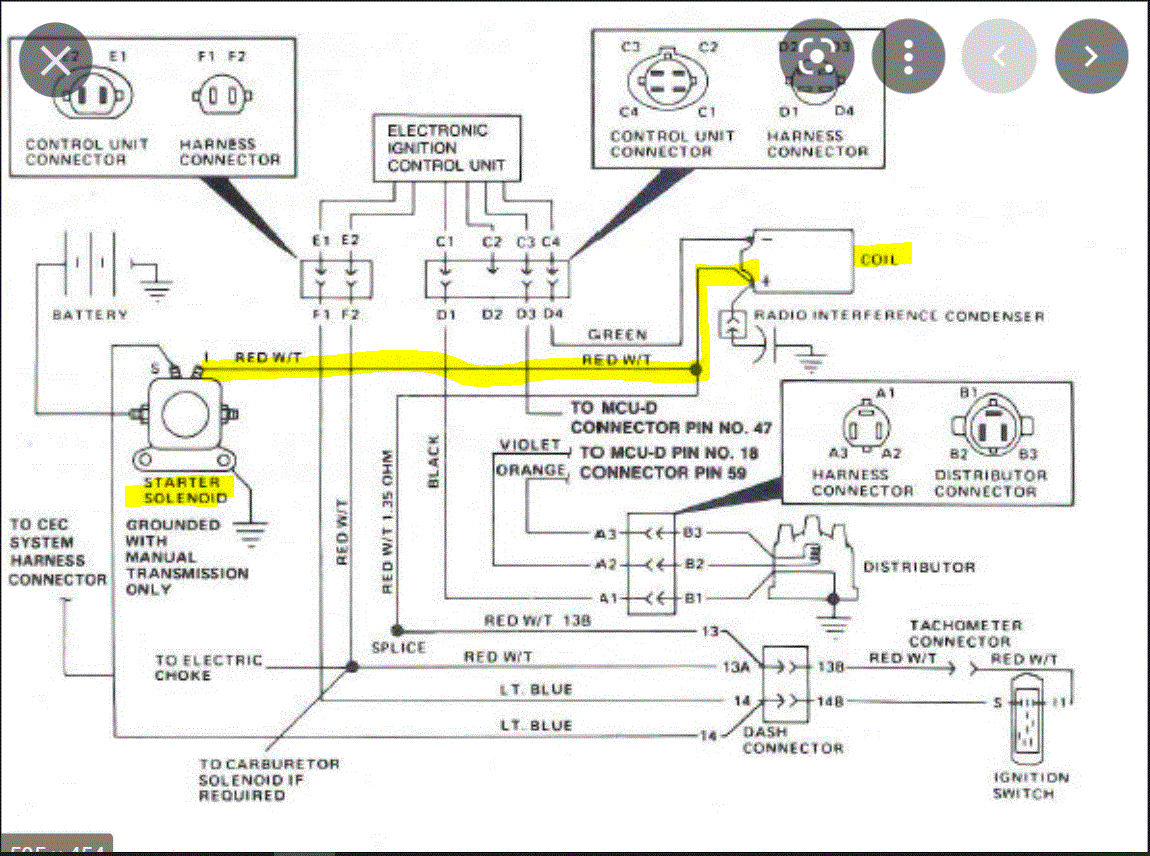

IF you have no power from the solenoid to the coil, either the solenoid is bad, there is a wiring issue at the ignition switch, or a broken wire. When you tested, did you do it right at the solenoid? Can you get a helper to check the I terminal on the solenoid for power when the key is in the start position?
I found another schematic for one that is two years newer. It should be basically the same. When the key is in the run position, the voltage from the solenoid to the coil is reduced to prevent damaging the coil. In the start position, that terminal and coil wire should have battery voltage.
If possible, check both ignition key positions for power. Also, check right at the solenoid as well as at the coil.
