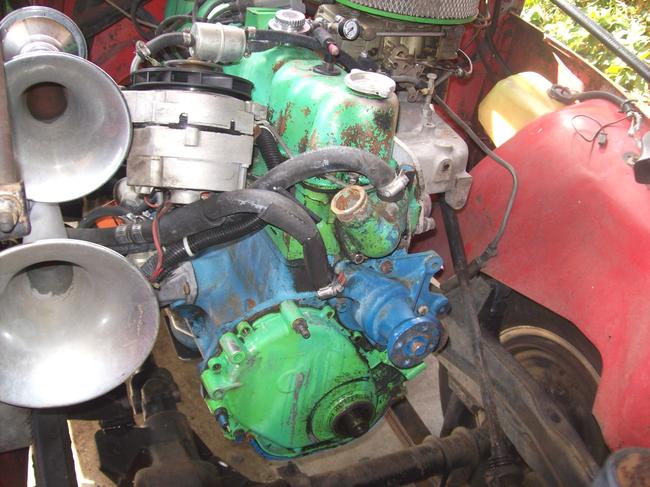

I'm app emptying to resurrect a jeep and I'm having some trouble. Just replaced starter and turns over. Sputters occasionally but does not fire. New spark plugs, distributor cap. Wires. Starter. Battery. It turns over and sputters but does not fire. We get a good spark from the coil wire and from all of the plugs. The timing is presumably correct but shouldn't relly stop it from firing. Firing order is correct. We are bypassing the rusted out fuel lines and tank putting gas straight to the carb. Our goal at this point is to get the motor to fire and run for like. A second
Any thoughts? Tomorrow I will post pictures and be around to answer questions. Thx ladies and gents.

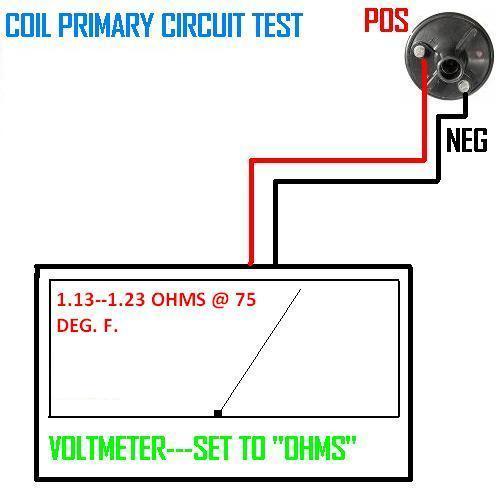

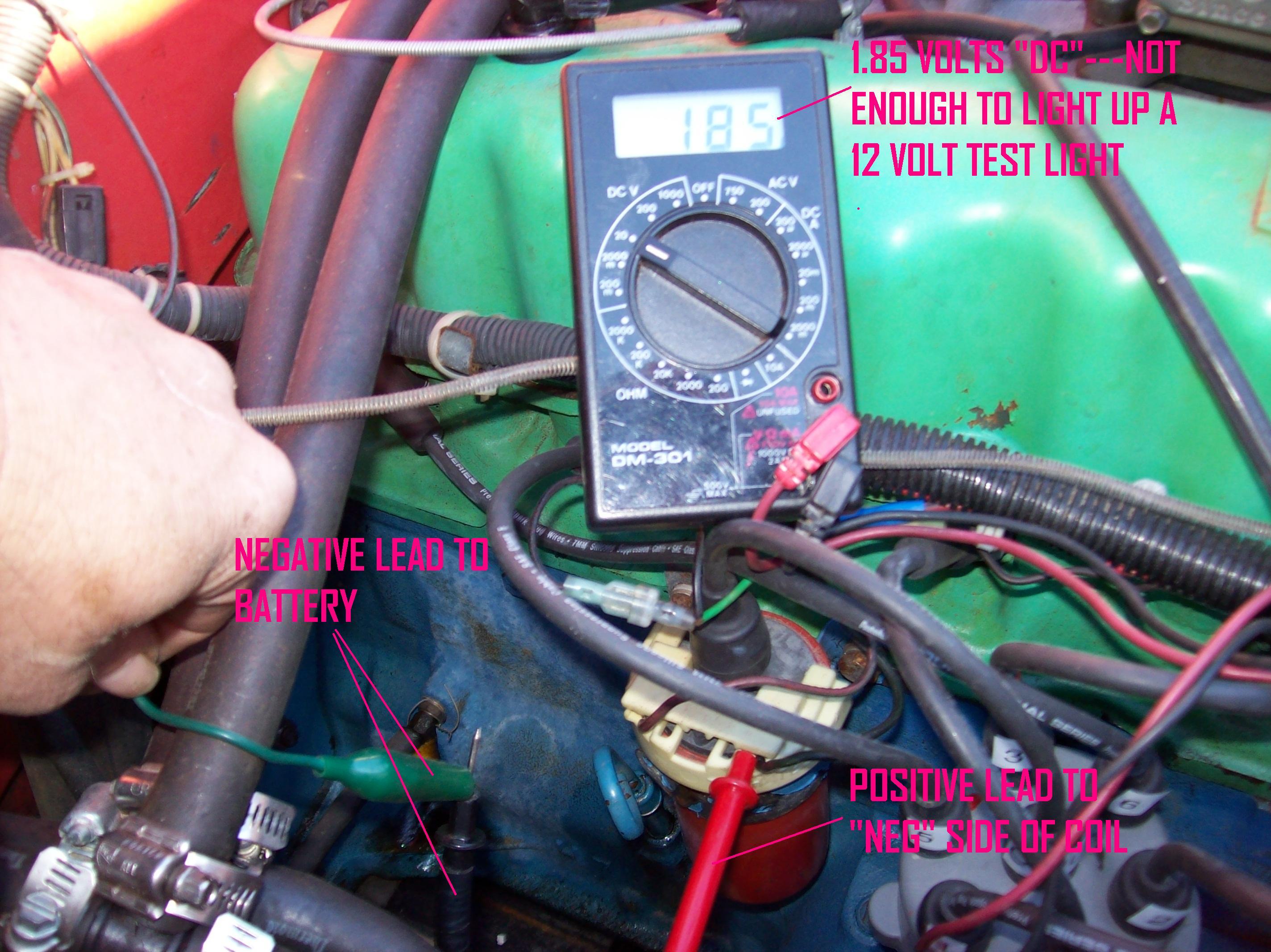

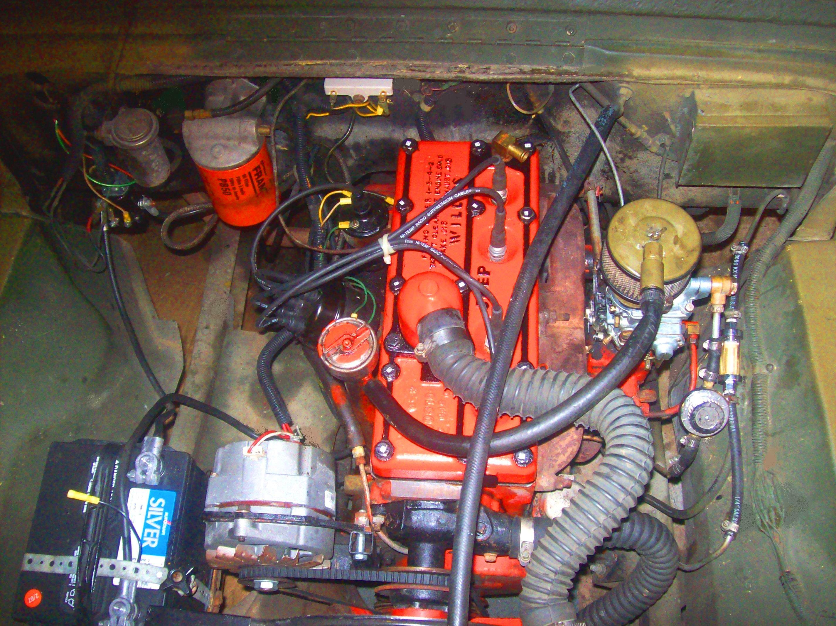

I HAVE 2 TESTS FOR YOU RIGHT NOW
DUMP 3 TEASPOONS OF GAS DOWN THE CARB AND ATTEMPT A START. WHAT DOES IT DO? HOW DOES IT ACT?

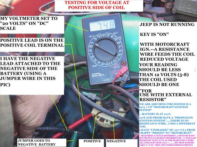

DO THE VOLTMETER TEST BELOW IN MY PIC (I'M SOMETIMES HARD TO UNDERSTAND) WHAT VALUE DO YOU GET WHEN YOU TEST IT?

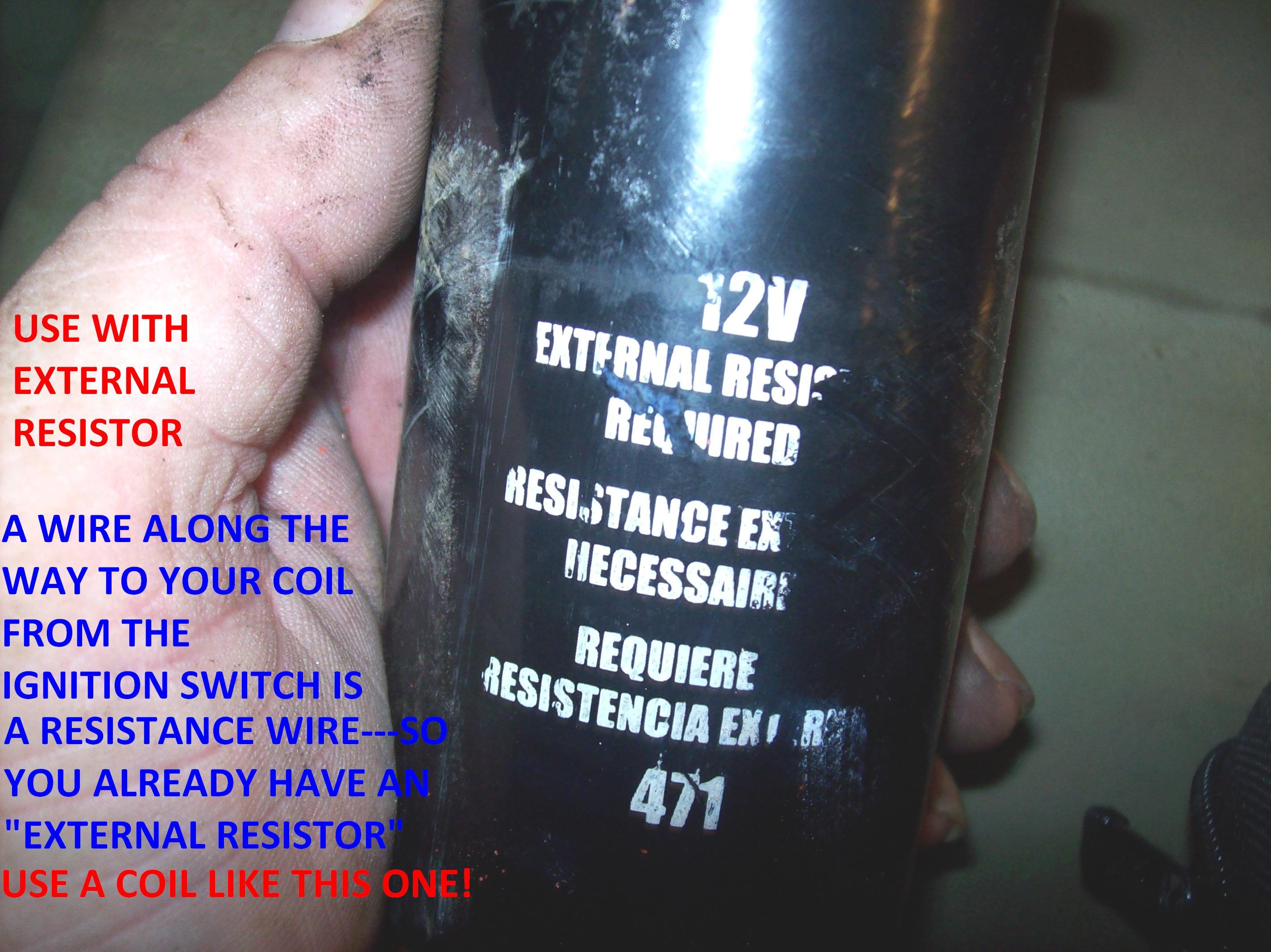

PIC 3) DO YOU HAVE THE CORRECT COIL? ONE FOR USE WITH EXTERNAL RESISTANCE?

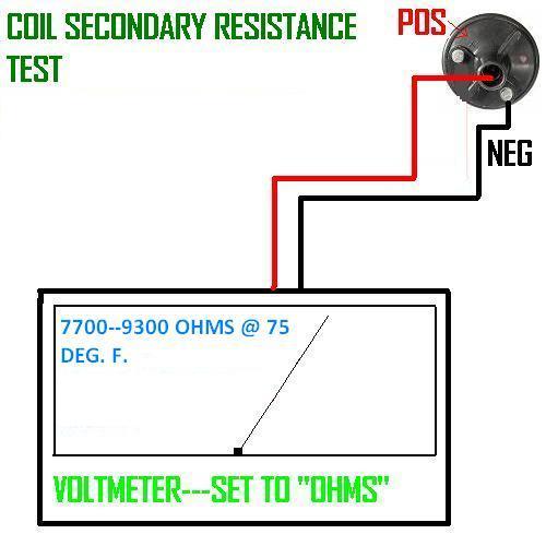

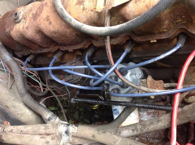

DISREGARD PIC 2 ABOVE
I THOUGHT IT WAS THE ORIGINAL PIC OF PIC 1 WHEN I POSTED IT.

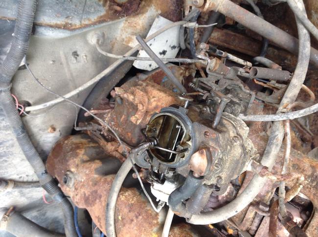

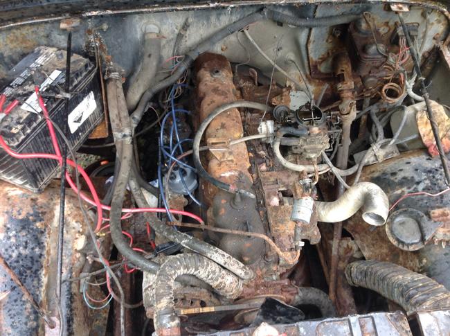

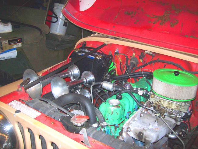

We tried the gas test. She will fire occasionally but she has yet to make a full revolution on her own. We checked the valves and arms and everything seems to be in order under the cover. We have found the fuel pump is bad or the line going to the carb is blocked so we are going to work on that tomorrow at which time we will do the voltage test on the coil. We do not have the previous owner to ask about mods but from what I can tell most everything looks original. Here are some pics

I've tested the coil. It is good. 5.38 volts. And to answer some questions u asked inthefirst post that I missed, she has been sitting for approx 9 years. I haven't been able to contact the previous previous owner about how it ran. However the previous owner has mentioned "it was running enough to work on it"

OK BOSS
HE LOOKS LIKE HE NEEDS LOT AND LOTS OF TLC
DO YOU LOVE HIM?
IS THE FUEL IN THE TANK 9 YEARS OLD?
WE'RE GONNA RUN HIM OFF OF A FUEL CAN ATTACHED TO A NEW 5-7 FOOT LONG FUEL LINE INTO THE "SUCTION SIDE" (TANK SIDE) OF THE FUEL PUMP. COMPLETE WITH NEW GAS

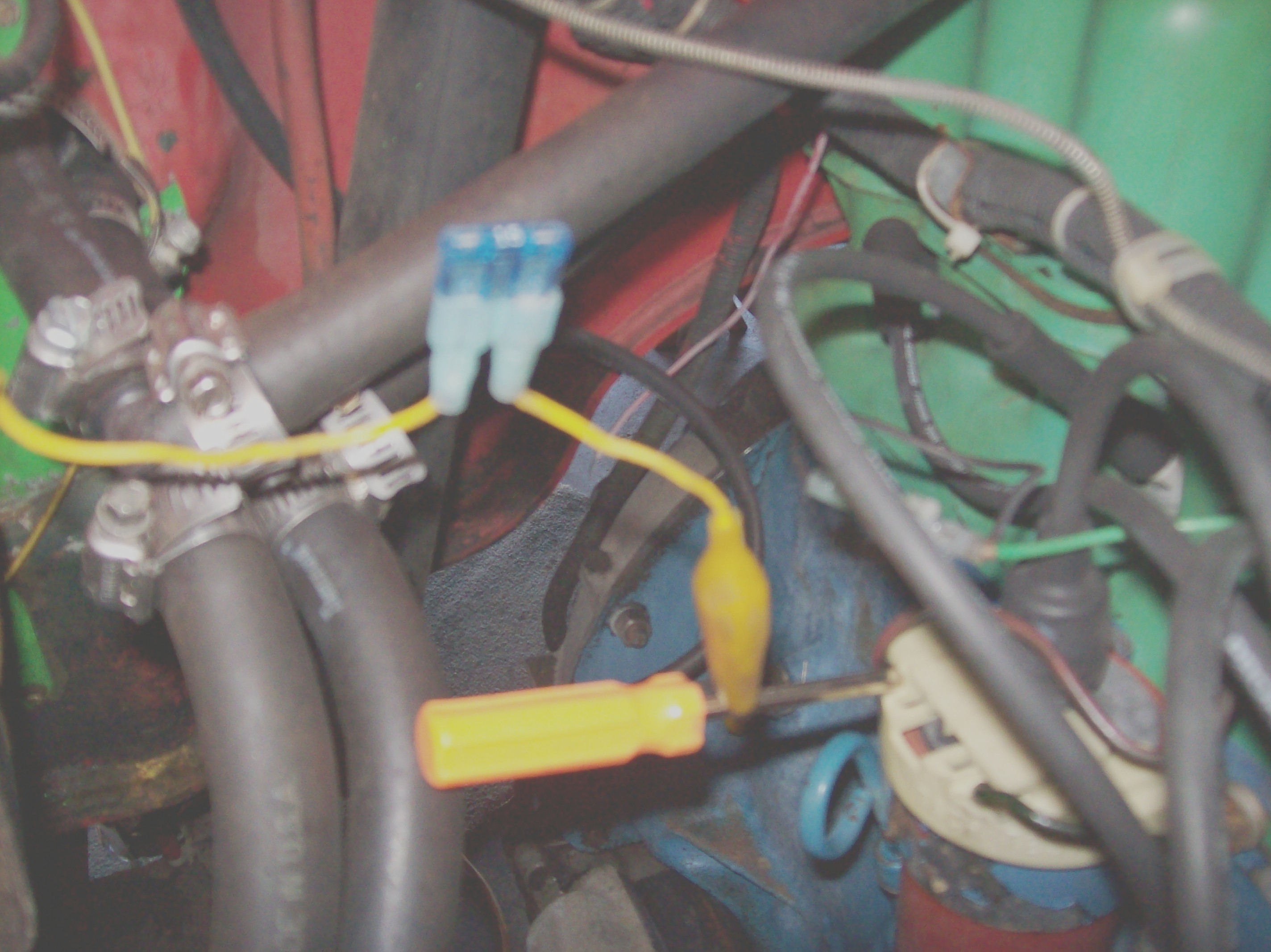

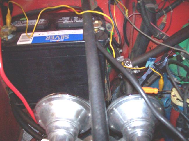

THE COIL TEST DID NOT TEST THE COIL!
IT TESTED HOW MUCH JUICE WAS GETTING THERE, YOURS MAY BE LACKING
FOR THE TIME BEING- AND THIS WON'T HURT NUTHIN' WHILE WE ARE STILL TRYING TO GET IT TO RUN
WE'LL SE WHAT HAPPENS ONCE IT'S RUNNING AND HOOKED BACK NORMAL
LET'S GIVE THE COIL FULL 12 VOLTS- SEE MY PICS

So when I hook the battery up to the coil i'm supposed to try n start him right? If this is the case we tried it, as i'm one to like to see what happens, no change. When we started the project we disconnected the fuel lines as we are aware of what happens to gas over the course of 9 years. Ugh. I happen to have purchased a barbed fuel fitting for my 6 foot fuel line in preparation for the same I.V. You mentioned. Nice to know i'm on the right track. Hit me with the next test boss man!

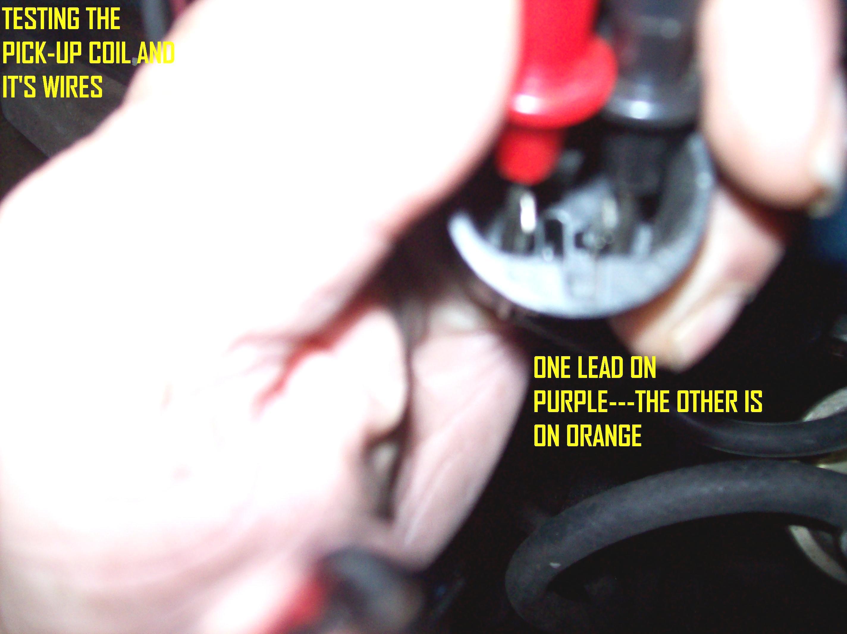

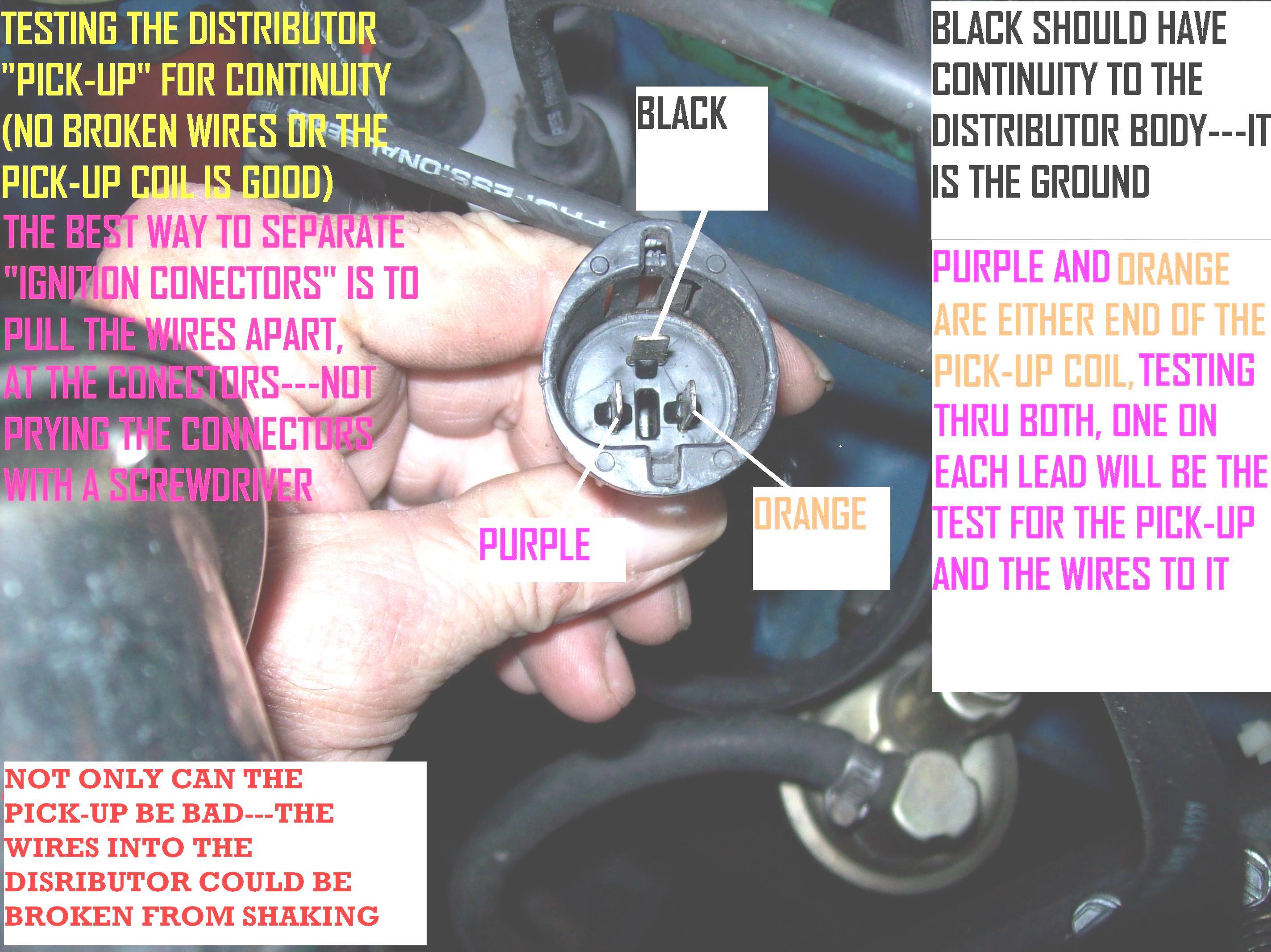

1st TEST) COIL TEST- FIRST 2 PICS

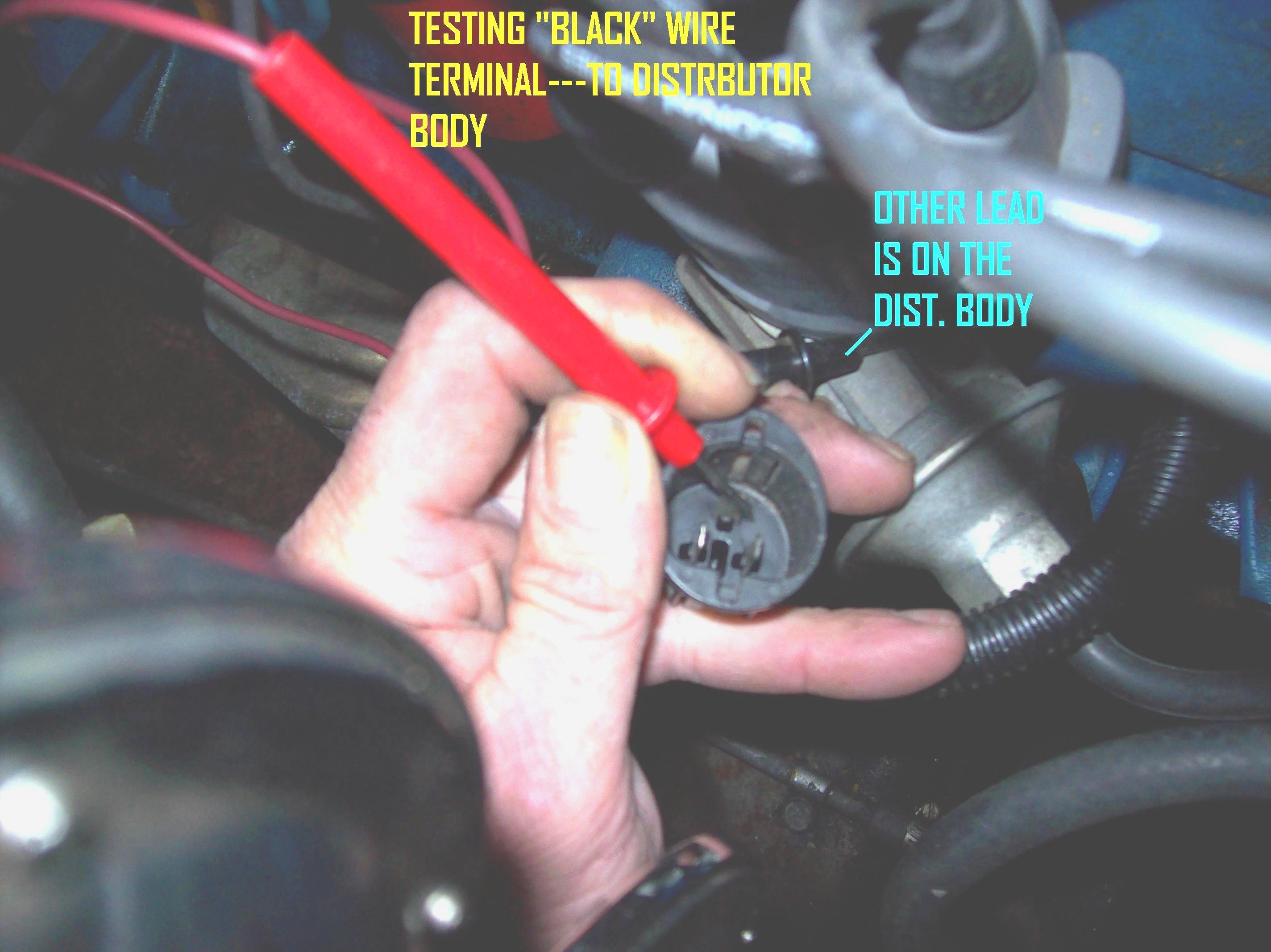

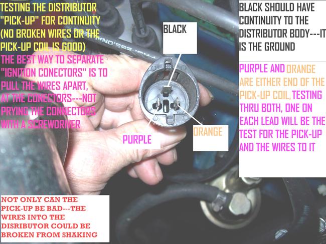

2nd TEST) DISTRIBUTOR PICK-UP COIL - NEXT 3 PICS
DO YOU THINK THAT MAYBE THE DISTRIBUTOR HAS BEEN PULLED OUT AND JUST STUCK BACK IN (NOT CORRECTLY REPLACED?) I GOT THAT COVERED TOO, I CAN 'SPLAIN ALL OF IT!
