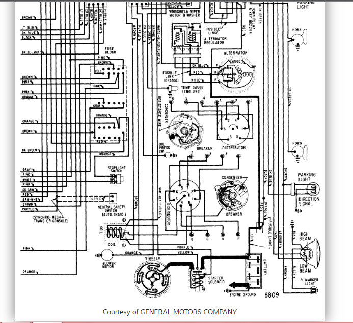

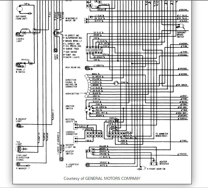

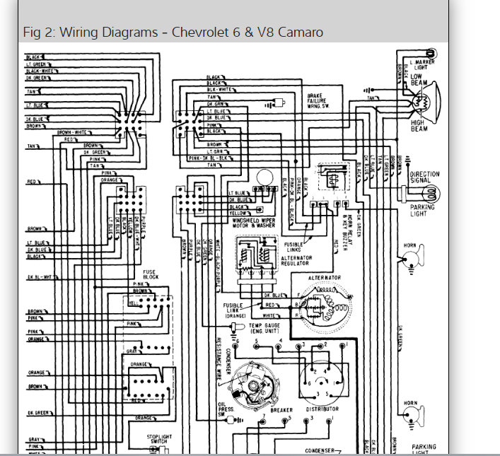

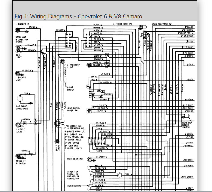

When turn on right turn signal, both the right rear and left rear flash at the same time.
Aug 11, 2019 at 1:12 PM
SCGRANTURISMO
  • 4,897 POSTS

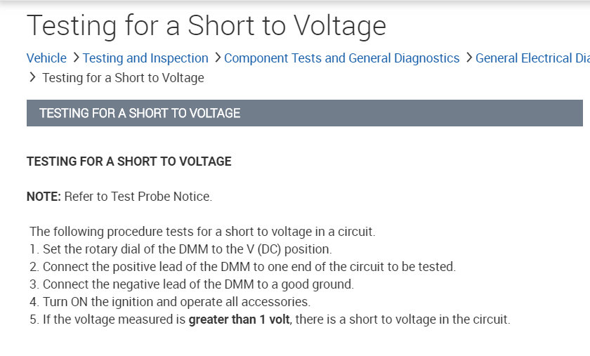

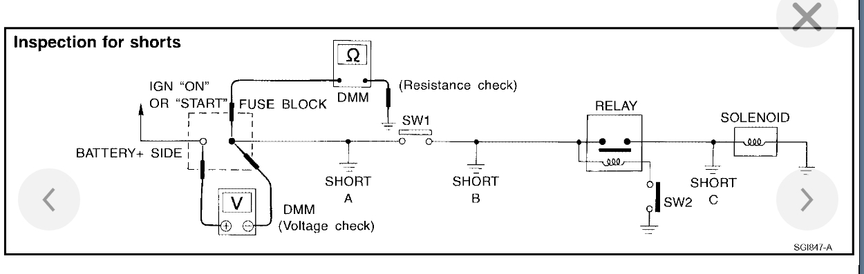

This sounds like you have a short to power in between the two wires that feed each sides taillight/turn signal bulbs. In the diagrams down below I have included your vehicle's entire wiring diagram set, and directions on how to find a short to power in an electrical circuit. Please get back to us with what you are able to find out.

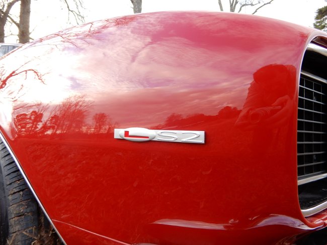

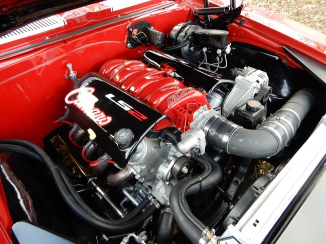

I ordered a Short and Open Circuit Finder and Tracer from Amazon. Here are some pictures of the car:
Aug 13, 2019 at 11:16 PM
SCGRANTURISMO
  • 4,897 POSTS
Hello again,
Wow! That is cherry! Okay, well when your tools arrive and you are tracing down the short, look for a spot where the insulation on the wire has gotten rubbed through and double check splice locations in the circuit. Basically, you are just looking for something that got bare wire exposed that is touching the frame or body in the circuit that is shorting the circuit to ground. Good luck and, please, let us know how everything turns out. And congratulations on your car, I wish it were mine.
