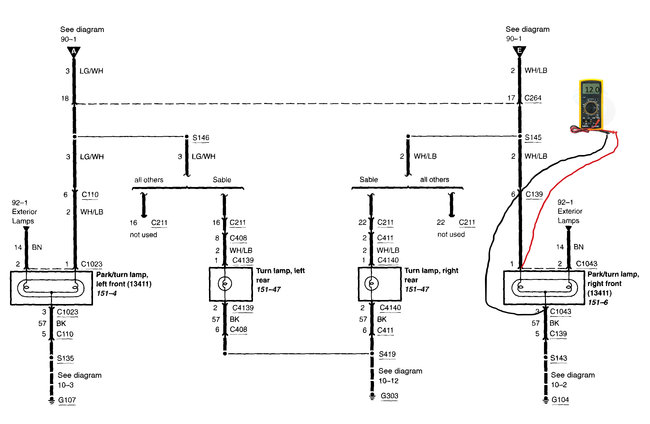

I would check the right front turn signal bulb voltage and ground. This can be done with one test that I have illustrated on the diagram. Turn the key on and turn the right side turn signals on and check it as shown. Most of the time it is either the bulb socket or the ground for the socket, especially on Taurus models! they have always had issues with grounds on the radiator support area.

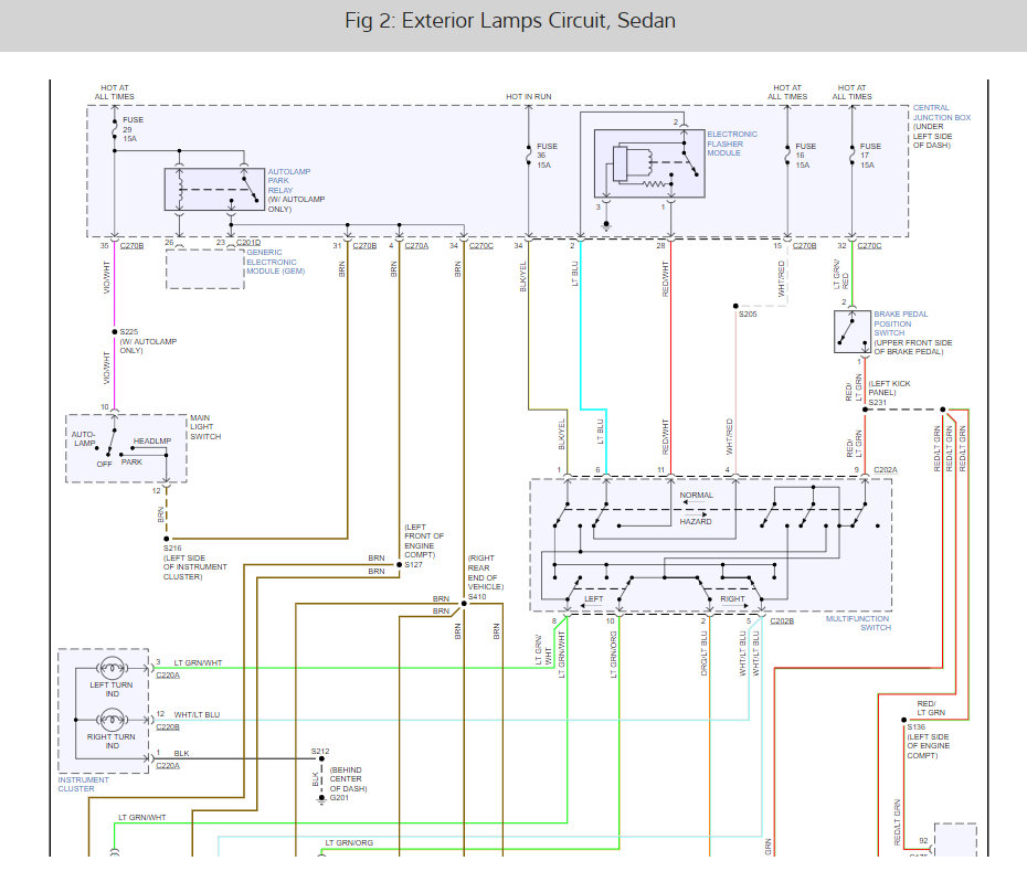

Okay, let me preface this. I did the following:
I was working on my headlight from an earlier issue, and traced the problem to a lack of power going to one of the wires. Someone in a previous time, had added a junction wire from the front fuse box, into the main light cone for the headlight.
This proved to be a problem when installing LED lighting, plus the wires to the main plug were disintegrating. I replaced both sides with an OEM plug, and a bunch of 22AWG connectors.
I had to trouble shoot which wire was bad, and after basically screwing it up 3 times, and finding out the Red/Black wire was not a ground, I goofed when I touched the extra power line, to the Blue/White wire, that normally attaches to the signal light/parking light on the passenger side.
I heard an audible "click" from the area around the battery. Now, that the headlight is fixed, both high/low work. I have no turn signal on the passenger side only.
When I turn the signal on, I can hear clicking from the relay can under the dash, but also a clicking under the battery somewhere. The driver's side works, the passenger side is messed up.
So what did I blow up? And what do I need to do to fix this? By the way the traction control light, also flashes when I use the passenger side turn signal, and the parking light glows barely. I checked both the front and rear bulb and they check out okay.
Dec 2, 2020 at 12:40 AM (Merged)
  • 55,423 POSTS

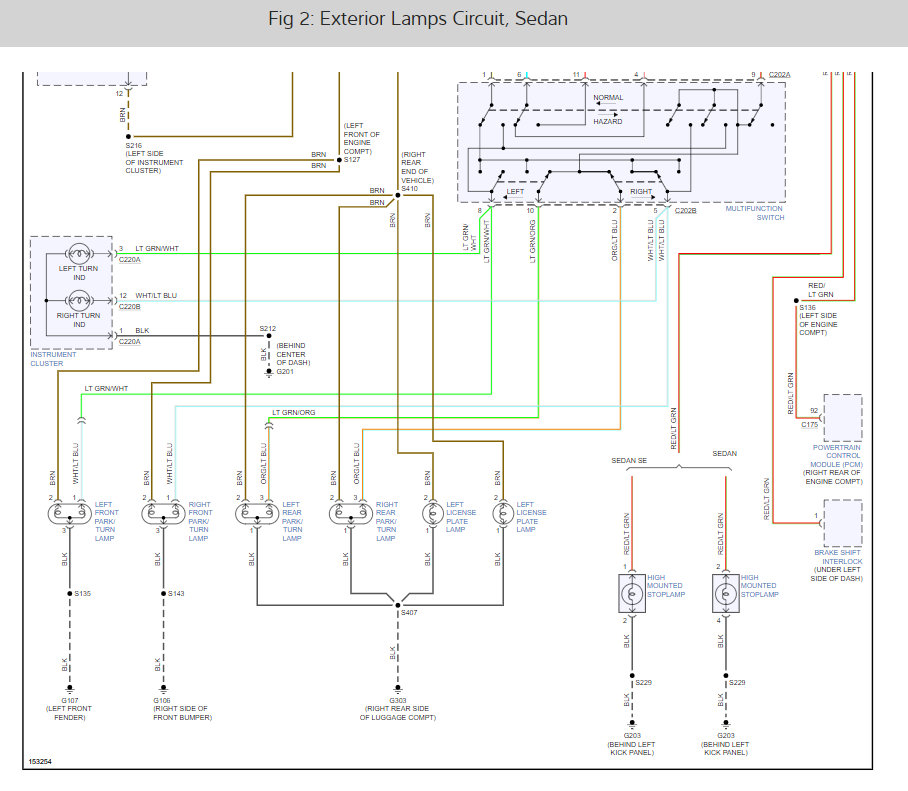

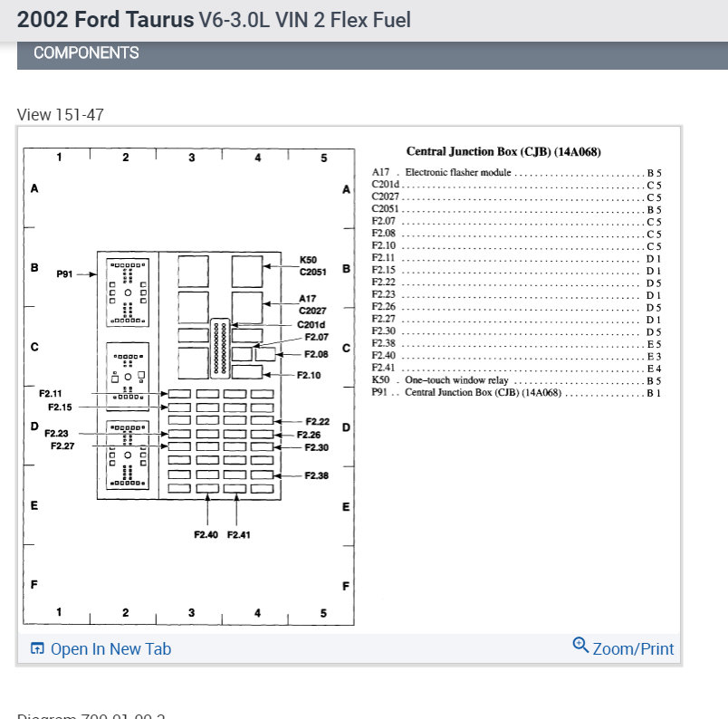

It sounds like the electronic flasher module is out. To be sure here is the wiring diagrams and the flasher location (a17) so you can check it out and see how the system works. Check out the diagrams (below). Please let us know what you find. We are interested to see what it is.

So, I took the car out yesterday. Drove it around shopping and end up putting my signal on and low and behold It works! Yay, but the headlight doesn't, but that could be the wire nut I had to use until I get more crimps. Parking light worked too. (Didn't do anything but drove the car around shopping. Might have reset something with repeated ignition starts.)

It seems to be all fixed for once. Never saw the problem reappear and I've been driving it for the past 2 weeks with no issues. Time to get it State Inspected and move on to house repairs. Thanks, for the assist, those wiring diagrams helped out a lot.
